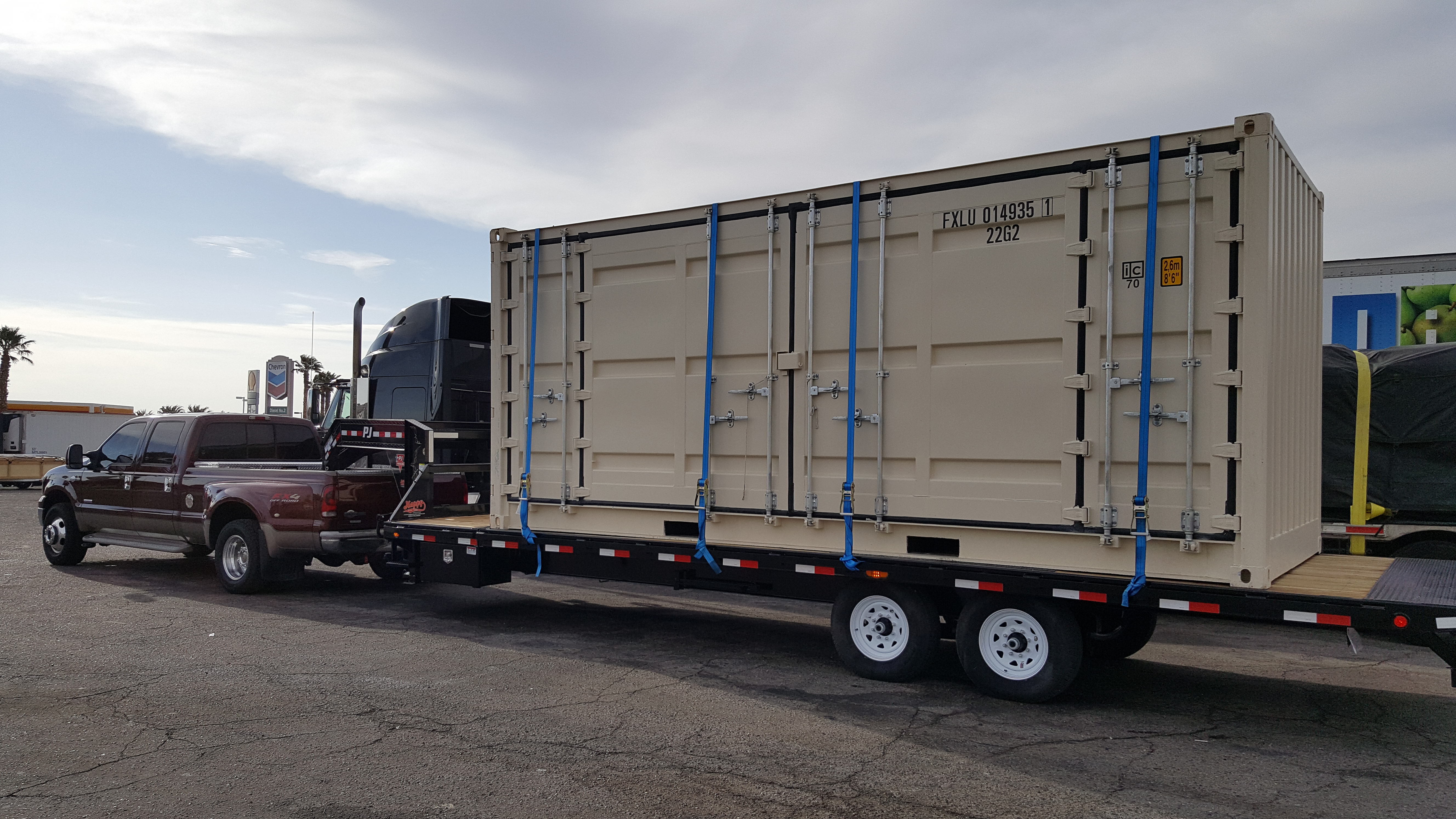

This thread is kind of old but still relevant. A 20' shipping container empty weight vary from 3800 pounds to 6800 pounds depending on how many doors, height etc, etc.
Do they can be move on a flat bed trailer easy? Yes ill do it all the time. My longest trip was 650 mi from Los Angeles, CA to St Johns, AZ, hope it helps 20160610_175915.jpg

Where did you find that container with side doors?
