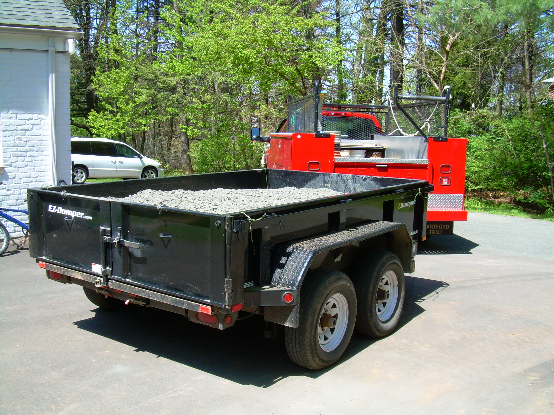

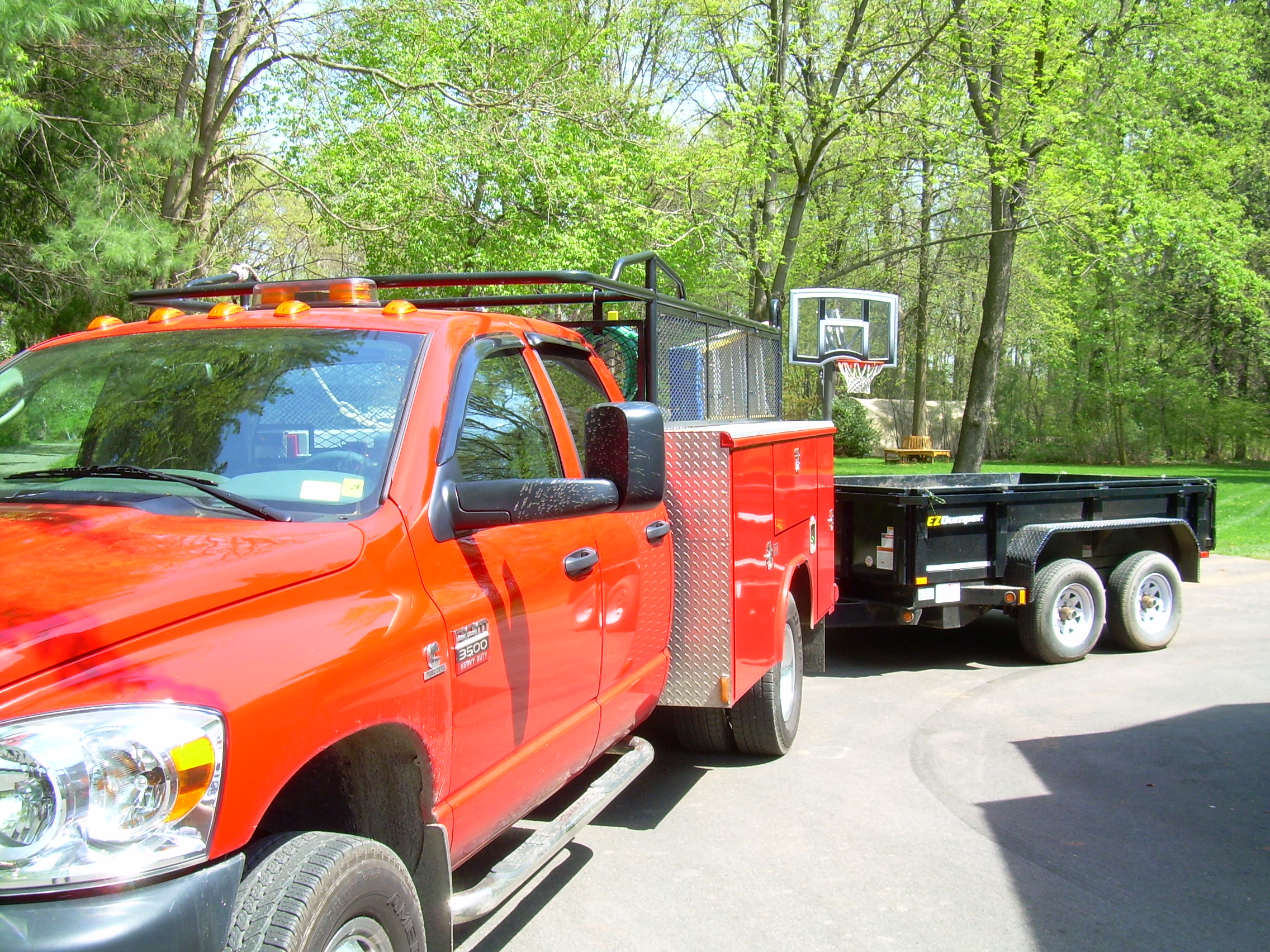

For OP, What type of trailer do you have? that's pretty heavy for an empty trailer, unless it's like a 10 ton equipment trailer?
I have a 3500 DRW but mine has utility body, light weight is around ~11,500 avg. that's with tools and a few things in the bed.
Pics here are of my dump trailer on truck. go into the quarry at 14,000 and leave at up to 23,000. which is my CGVW.
This truck handles the load beautifully with 300+ HP 6.7 Cummins with integrated VG turbo (engine brake) and Aisin 6 speed tranny in tow/haul mode. stopping the load is as sweet as getting it moving :)
JB.
JB.

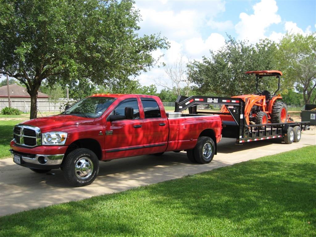

It is a Load Max, 24'x83"wide gooseneck low boy.. I did search their web site but did not find the light weight of it..
   / Empty weight of Ram 3500 Quad Cab DRW 4x4? #39
I left the scales at 24,670#, I did not get a tare weight coming in.
The 4'x 20'x 1/4" thick sheets of plate steel weighed 1,650# each (was hauling 7). Trying to figure the empty weight of my tralier.
what kind of trailer is it?
so that means your trailer is about 5,620#
an empty weight on a trailer of 5K? what is it a 20K lb trailer?
i consider most 20' "equipment" trailers (6" C frame on 8 bolt wheels) to be in the 2500lb empty range. but TWICE that?

Nice trailer! looks pretty HD could be up there close to 5K?
