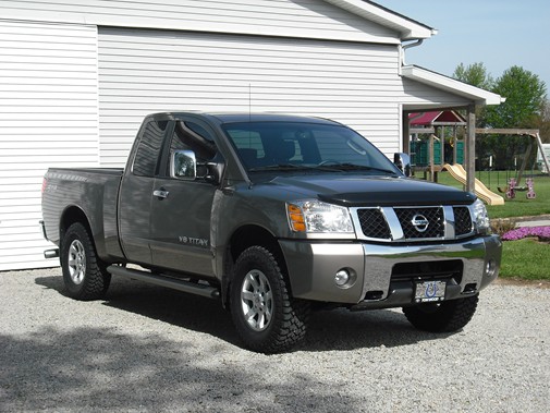

Just left my local gravel pit after having my newest truck weighed. With me in it (165#) and 3/4 tank of fuel my new King Cab Nissan Titan 4x4 weighted 5,840#. The max GCVWR is 14,850# leaving 9,010# for towing. The book list the max at 9,200# but I carry a tool box, 3 different hitches, and have all the options like leather seats, navigation, sat radio, ect.
Chris
