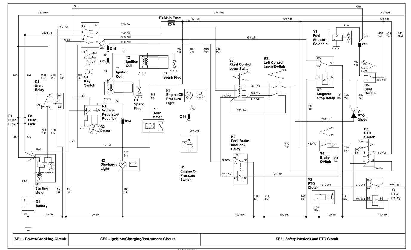

Yanmar 195 and Kubota 2920
I swapped a Predator 670 engine into a John Deere 757 zero turn. I started the engine, engaged the pto, cut some grass, but the engine was smoking very badly, so I removed the engine, exchanged it and the new one runs great but when I turn on the mower it dies. The belts are free, the clutch shows about 2 ohms, no grounds. When I disconnect the wire plug to the clutch the engine continues to run when I turn the pto on. The battery voltage drops about 1 volt when I hit the starter. Oddly, the battery voltage does not drop even though the pto starts to turn the belts a little before the engines quits. I attached the wiring diagram form the manual if that helps. I am at my wit's end!

Here's how I would troubleshoot it. The PTO clutch has two leads, black and blue wires. I'd unplug it. Then (not running of course) use two clip leads, one to ground, other battery +positive. Just for a second or two and you should hear it click (engage) each time it gets power. Now I'd start mower and connect again. Caution! Of course you have to be careful doing this! Harbor Freight sells a clip lead set...you may want to make long ones so you can try it while in seat.
If this works and engine doesn't cut off you know clutch and drive system is fine.
Then looking at diagram next is PTO relay. It gets power from PTO switch, however, all those safety switches like brake, seat and control lever switches must be good and engaged to work otherwise motor cuts off.
My guess is it's one of the safety switches either bad or not engaging as it should.

Okay, here's the skinny. When I installed the Predator in the John Deere, I turned the PTO clutch around to allow the belts to line up. The magnetic hub is close to the engine and is shutting the engine down. (no idea why) I have some room to put something to block the magnetism, but I have to find out what works. It's either that or extend the engine shaft about 2 inches, but that's scary!! Thanks for the suggestions.

When I installed the clutch the correct way with the magnetic hub away from engine, then energized it the engine continued to run. It's only with the hub close to the engine that it shuts down. I repeated the test to be sure and got the same results, got to be magnetism.
   / Engine dies when pto engaged #20
Could the magnet be pulling on the kill switch or a terminal and causing it to activate and ground the spark? Can you see if the switch makes ground connection when you trigger the PTO? Maybe ohm from the open side of the switch to engine ground and then watch the ohmmeter as you push the PTO button.
