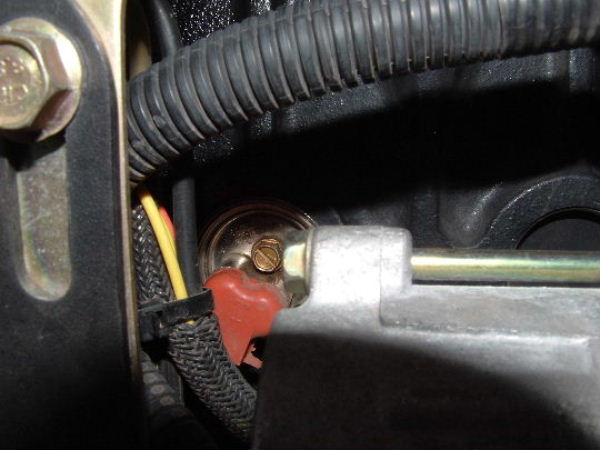

My block heater is installed where the front freeze plug was and the NH technician did not have to remove the alternator. Swinging the alternator out of the way might make for an easier install, though.
   / Engine Heater for TC33 #12
My neighbor, Poleclimber, just installed a block heater in his TC35A, which is the same arrangement as yours, and I believe the exact same engine block. It went into the same spot as Dieselmonk's picture. He received the block heater, along with directions. I'll email him, and be sure that he reads this. Maybe he'll take, and post a picture for you. He also said that removing the old freeze plug was the major part of the jobbie. I don't think he said anything about removing the starter.

I'm not sure if this info will help or not. I did notice that your starter is larger than the one on mine. My starter looks more like the one on the TC55. Also I noticed that your engine compartment is arranged a little differently. I don't know how much different the TC tractors are from the DX case models but that could be the differance. My heater installed at the freeze plug hole adjacent to the starter.As you can see in the photo 2 freeze plugs are visable. All I needed to do was lift the starter wire out of the way to expose the freeze plug.and remove the exaust shield. I drilled a series of 1/8 hole from the 12 oclock position to the 6 oclock position and from the 9 oclock position to the 3 oclock position on the freeze plug and drilled a larger hole for a dent puller and the plug popped right out. The series of holes is for the freeze plug to shrink as it's pulled out.I positioned my heater between 6 and 7 oclock. . Be sure not to run the drill bit to deep. /forums/images/graemlins/blush.gifHope this helps you out. /forums/images/graemlins/grin.gif

You probably did a lot more drilling than most of us did. In fact, I don't recall doing any! I think I just took a long chisel and pounded near one edge, but not right at the edge for fear of scratching the block. With a few good wacks the plug pops free and a with a pair of long nose pliers, can be removed easily. In these hard to get at intallations, I think I'd simply pull the starter first.

Just a thought. That center bolt or screw. Is that what holds the freeze plug heater in? Or do you have to drive it in. Or a combo of both.
   / Engine Heater for TC33 #17
I considered taking the starter off, but I had already decided to use a dent puller. It didn't work the first 4 tries so thats when I decided to drill more holes to weaken the plug. I guess I was determend to do it my way instead of the right way. /forums/images/graemlins/smirk.gif
   / Engine Heater for TC33 #18
That center screw is used to pull 2 tabs against the inside wall of the block and hold the heater in place.
   / Engine Heater for TC33 #19
Center bolt presses the assembly out to a larger diameter, like a pancake, and causes it to fit extremely tight. I can't recall for sure, but it also might pull a tab or mechanism in on the back side, to really pull it in and tight. Regardless, no driving in - it just slips easily in.
   / Engine Heater for TC33 #20
O-ring is pulled tight and makes the seal.
