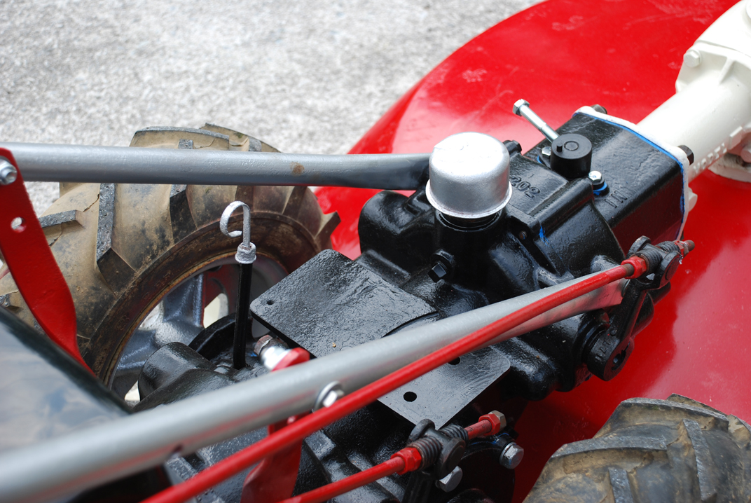

Did you use a part from a Comm 10 or something for the F/R lever? Pictures?:)
You've done a great job on that machine. I am still looking for one...
I happened to have a part.
Gravely made to flip the forward reverse.
So I used it I will try to take a picture of one
You push at the top and pull at the bottom.
So now when you push the lever the tractor goes forward.
pull back and the tractor backs up.
I am used to that way. :thumbsup:

You put a frowny face next to using two spacers. I see absolutely nothing wrong with this. Yeah, one piece would be better but so what if its two? It'll work just fine.
Are you going to make the top hat for the L any longer than the one in the picture? Based on my experience I think longer is better because the load of the planetary is spread over a larger area. Of course I've been wrong many times before!

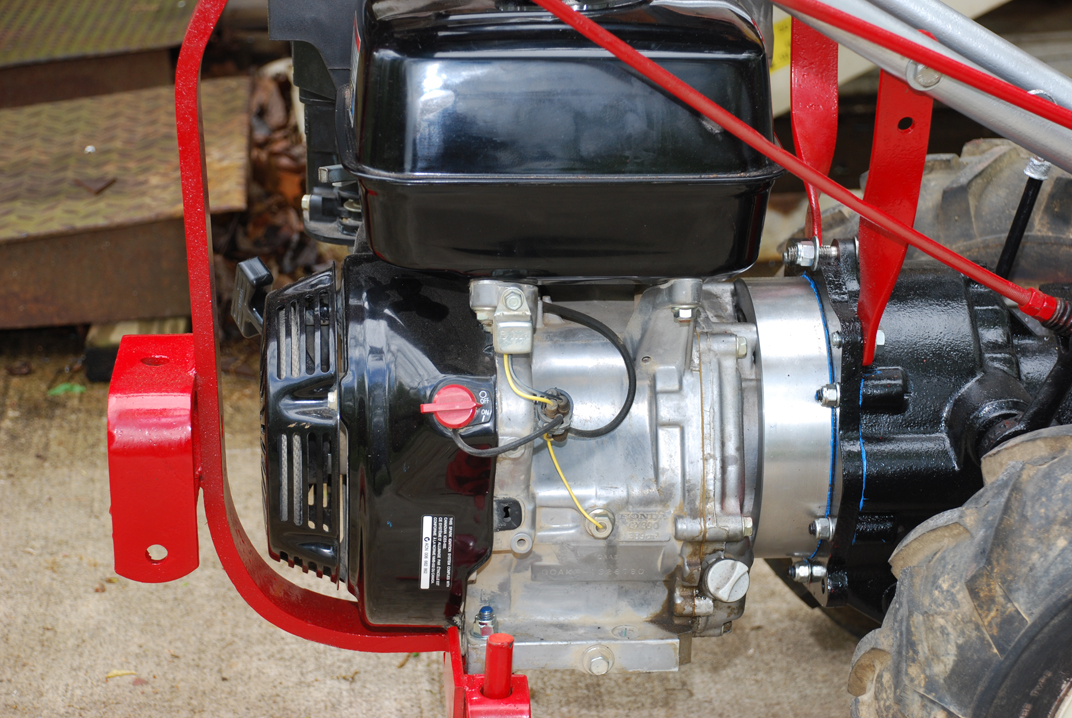

Well I finely got my figuring done .
I had forgotten about the thickness of the Kohler
So now I can make it from one 2.00 thick aluminum plate.
Instead of two at $100.00 would be $200.00
That saves $100.00 so that is money in the pocket.:thumbsup:

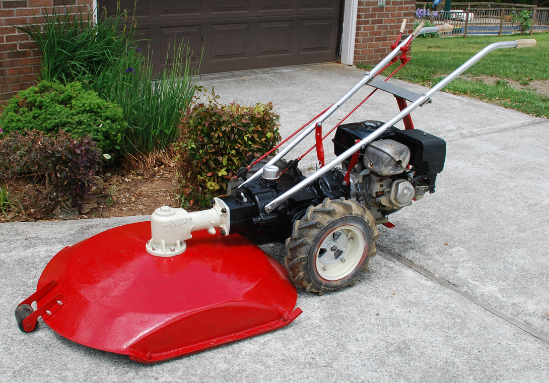

So final set up is like this.
Kohler adapter drilled to fit the Model C & Model L transmission.
I can drill their adapter for $5.00 or sell one drilled for $60.00.
The muffler does not need any work except take the cover off.:thumbsup:
The cover could be notched for the handle bar
The gear and top hat are $170.00 together.
The seal went up to $8.00
And of course shipping is about $15.00

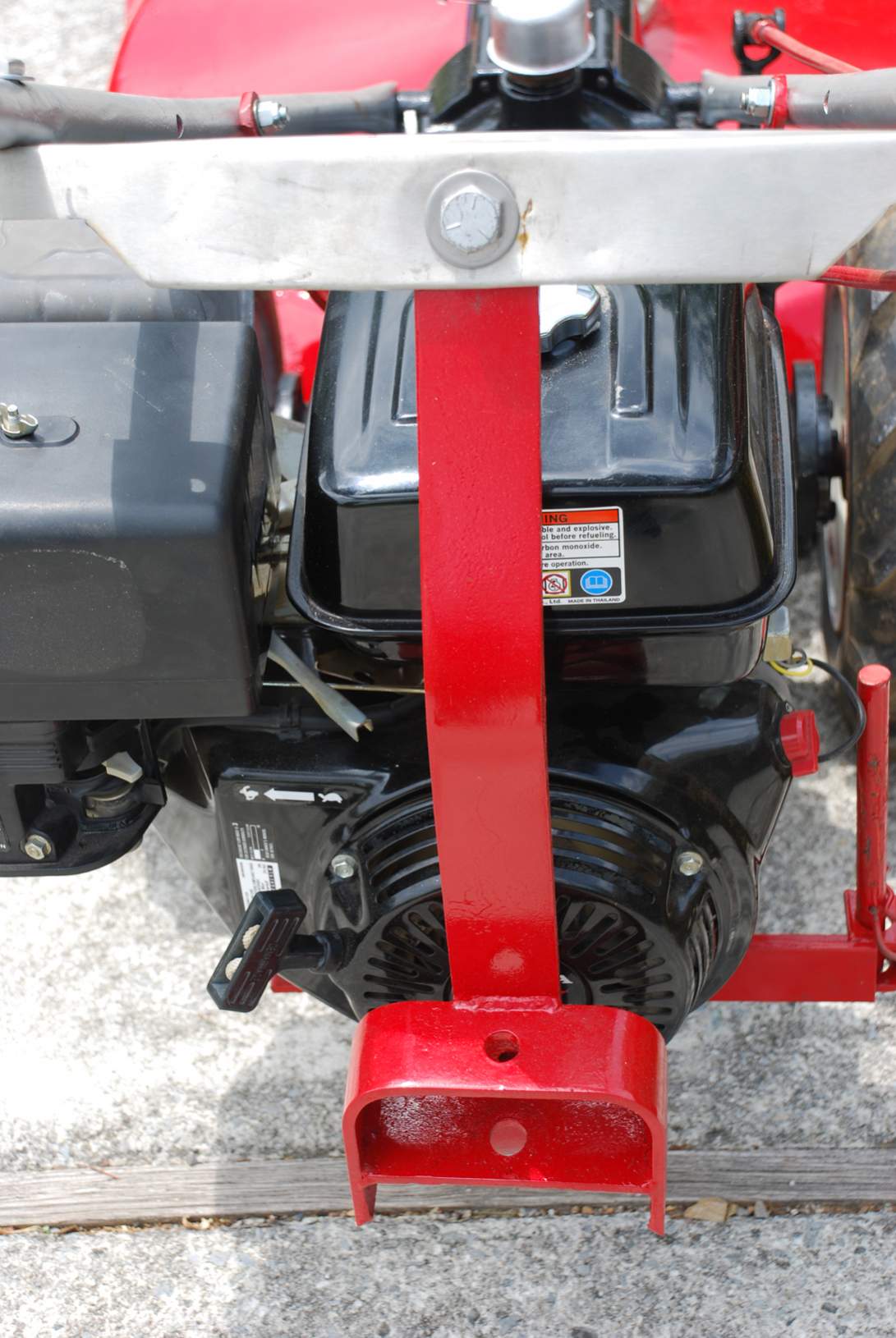

I made two braces from 1/4 X 1 wide Twisted 1/2 turn.
It makes it a lot stronger Twisted.
For the back I took a draw bar from a 5xxx series tractor
Bolted it right to the bottom of the engine.
Made a cross from piece of angle iron
It is a LI set the speed max at 2600
I like the way it handles
