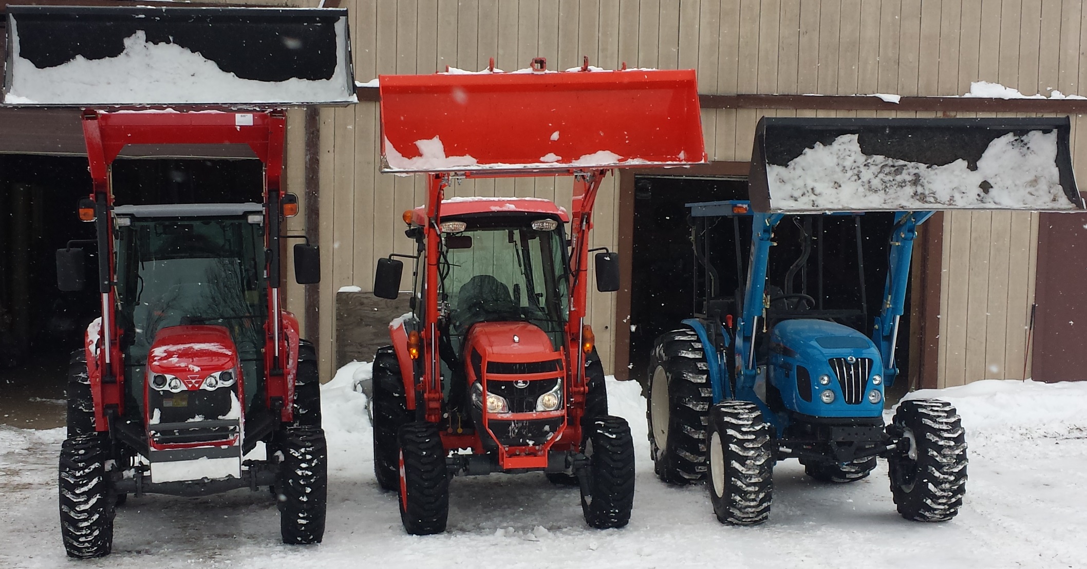

Yeah, I agree that "behind the axle" is a more agreeable location for the steering cylinders. That, and the seemingly "beefier" front axle on the Massey were one of the things I noticed when shopping that I found appealing. Also, Kubota has a shield for their "ahead of the axle" steering cylinders (see picture). That's Ken's L3540. And, you can see on my LS that the front steering cylinders were not protected at all.
I can tell you from the nicks/scratches on my front axle currently, from brush & such that I've run into ... I definitely prefer, at least in apparent practical application, the cylinders behind the axle.

In the class, Massey had the heaviest driveline—although Deere's 4066R does use a planetary gear drive as opposed to everybody else using a bull drive. That said, the NX series uses a heavier front axle than the out-going DX series and the 3PT uses external, serviceable rams too, a nice thing to know if a guy thinks he will have his tractor for some time. Anyway, I found the need to protect that neat little rubber boot from underside damage as well. We'll see how well it all holds up next season.
