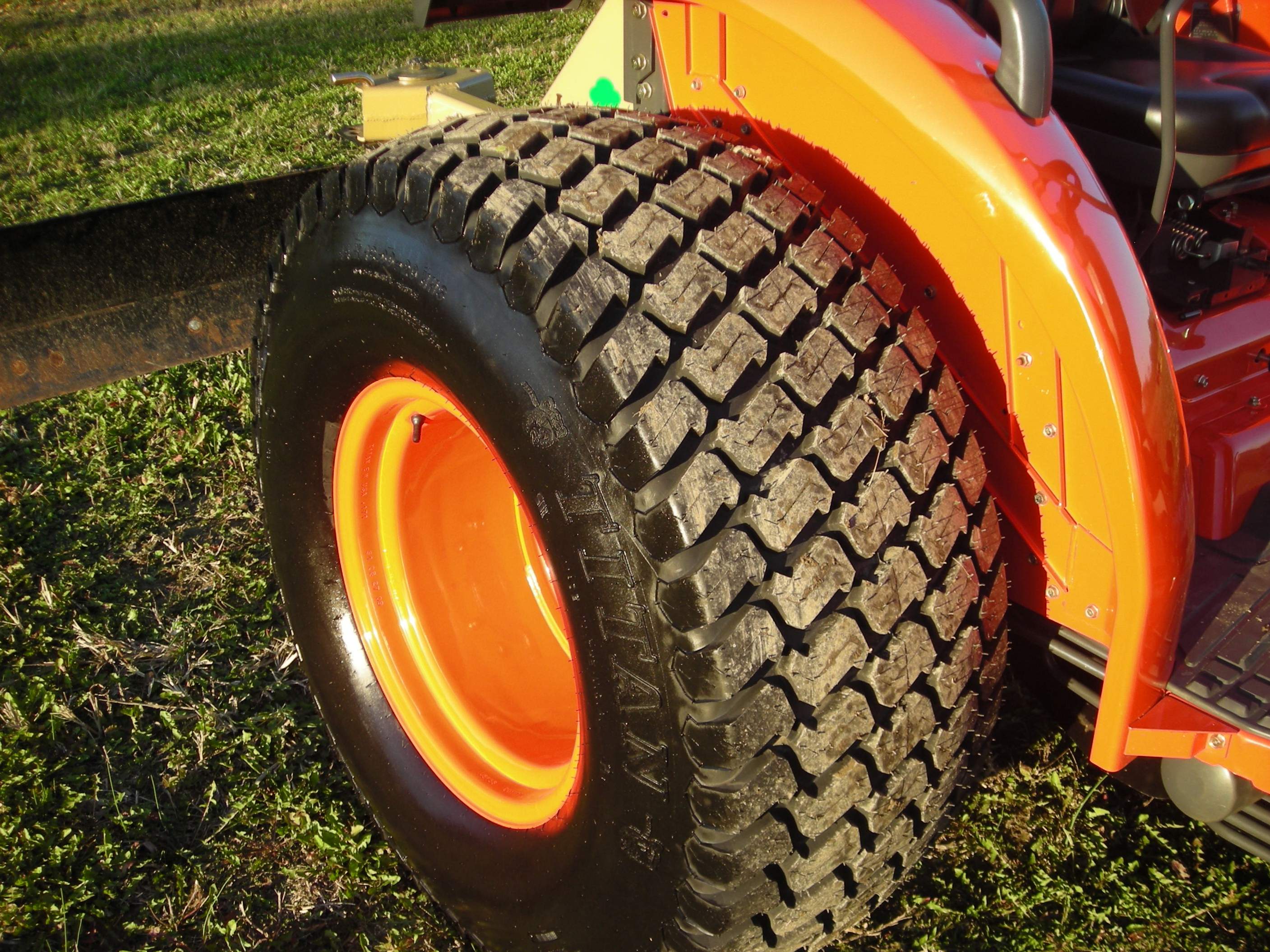

How big can I go while still not tearing or sinking in semi wet turf?

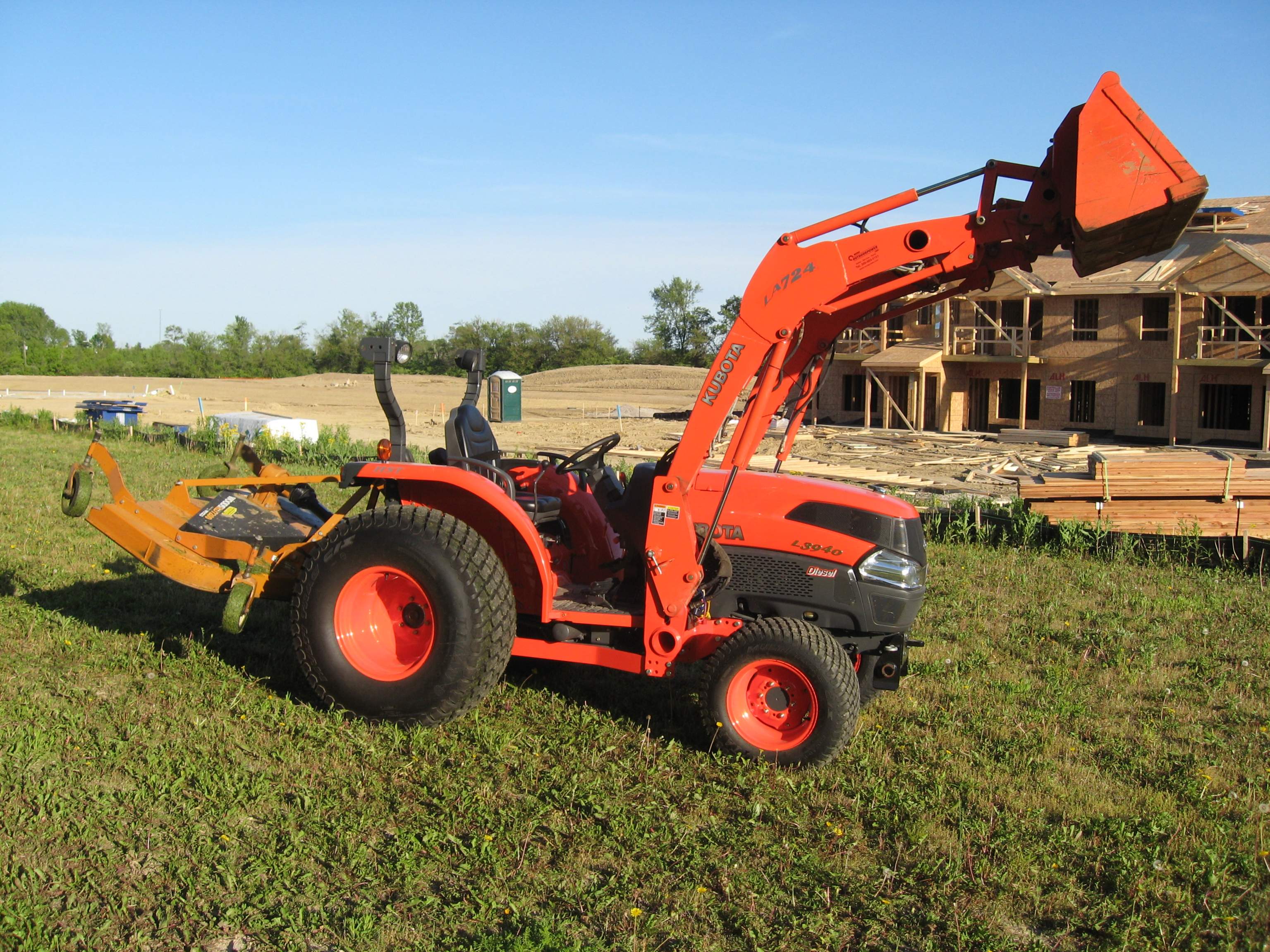

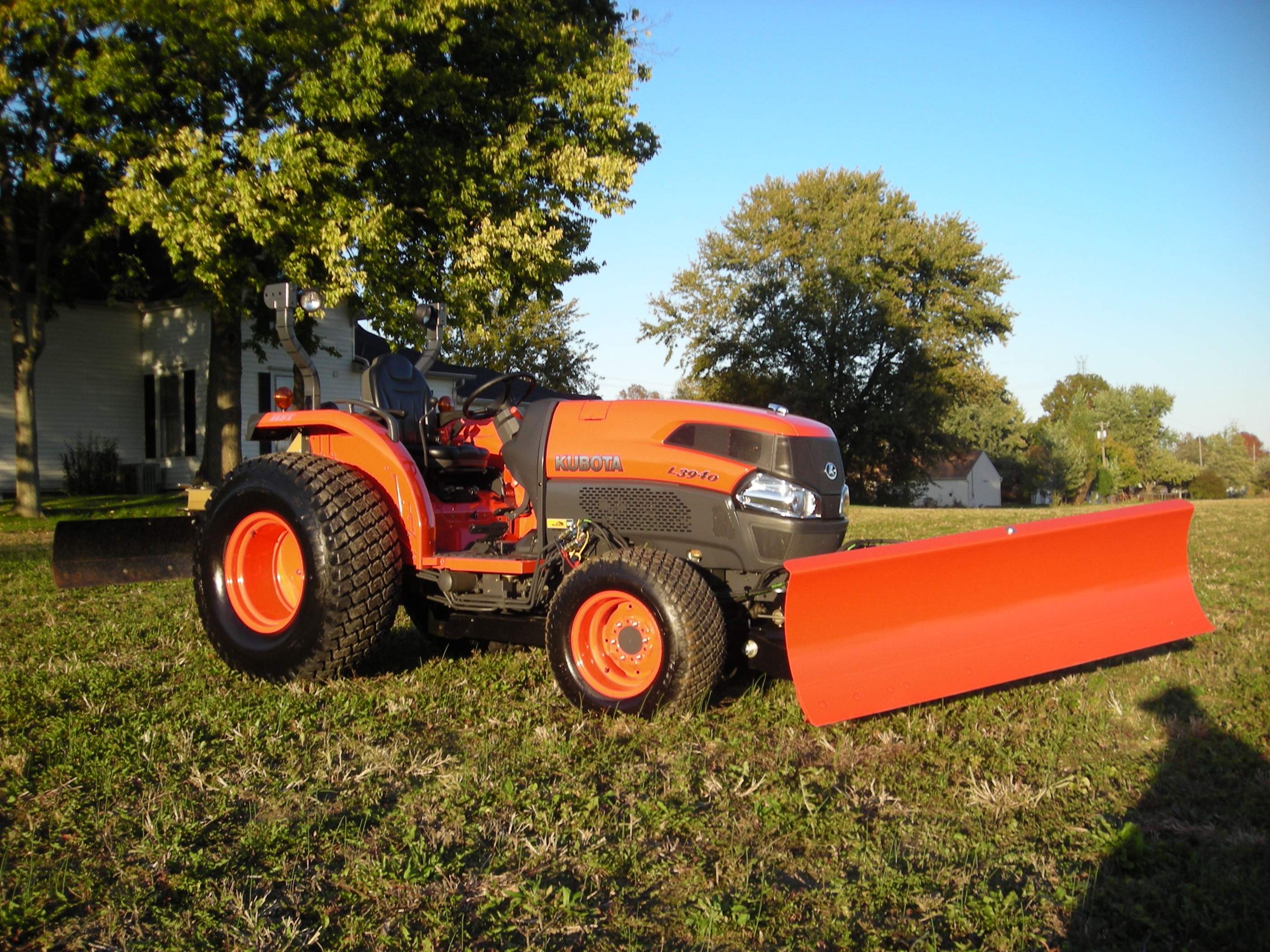

That is part of the reason for the existance of turf tires. I use mine in snow with excellant results. They also perform well in dirt. There are better choices for mud, but it still gets through. Philip.
