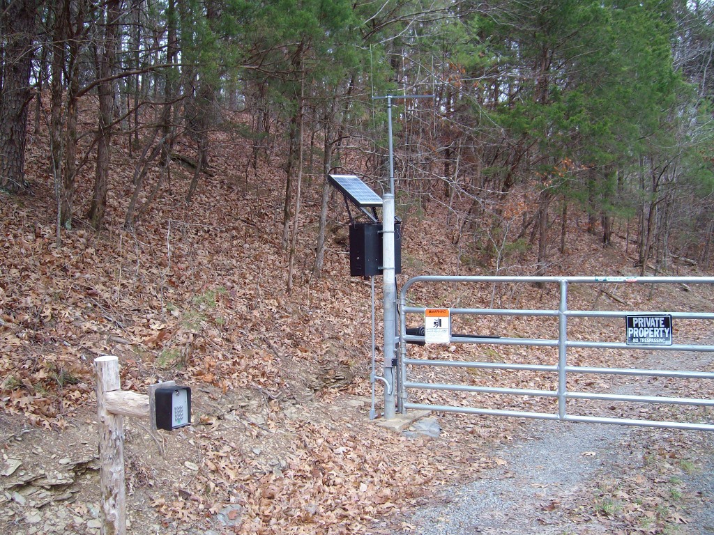

For you folks that use solar for your gates, how is that system? I'm planning on a 16 ft wide slider gate but we do not have power to the end of the drive (1700 ft to the house) so we will be using solar. We live in eastern Ohio so not really an ideal solar area. I'm just kinda worried we will run out of power if opening/closing the gate several times per day.
Thoughts?
   / Entry Gate advice appreciated. #46
Solar works fine but not with a tiny 5watt panel that usually comes with the gates. A large 30w panel will work fine with a sealed battery.
The problem isn't that it can't power the gate but it doesn't work at night and cloud cover/rain makes a 5w panel nearly useless. You need the extra to cover those times. But with a large panel it will work fine.
Thoughts?
Just make sure to get an operator with a controller that is designed for solar. I use Nice-Apollo. The controller has tons of options you can set to minimize battery drain. Their controller box holds a regular automotive lead-acid battery, so you can use a group size with lots of CCA. One recommendation I have heard is to buy a battery with the longest FULL REPLACEMENT warranty you can find (Sam's Club), and then trade in just prior to expiration. That seems a little unethical to me, and I don't think it will be necessary in my case. I use a 20W solar panel in a quite shady area (diffuse shade through trees) and it stays up to voltage just fine winter or summer, even during extended cloudy periods with an average of about 5-6 open/close cycles per day.
Thoughts?
We have gone a whole week without sun going in and out several times a day and have never have lost power. A lot would depend on your system, solar panel and battery.
My neighbor has a swing mule and his did not last the sunless week.
