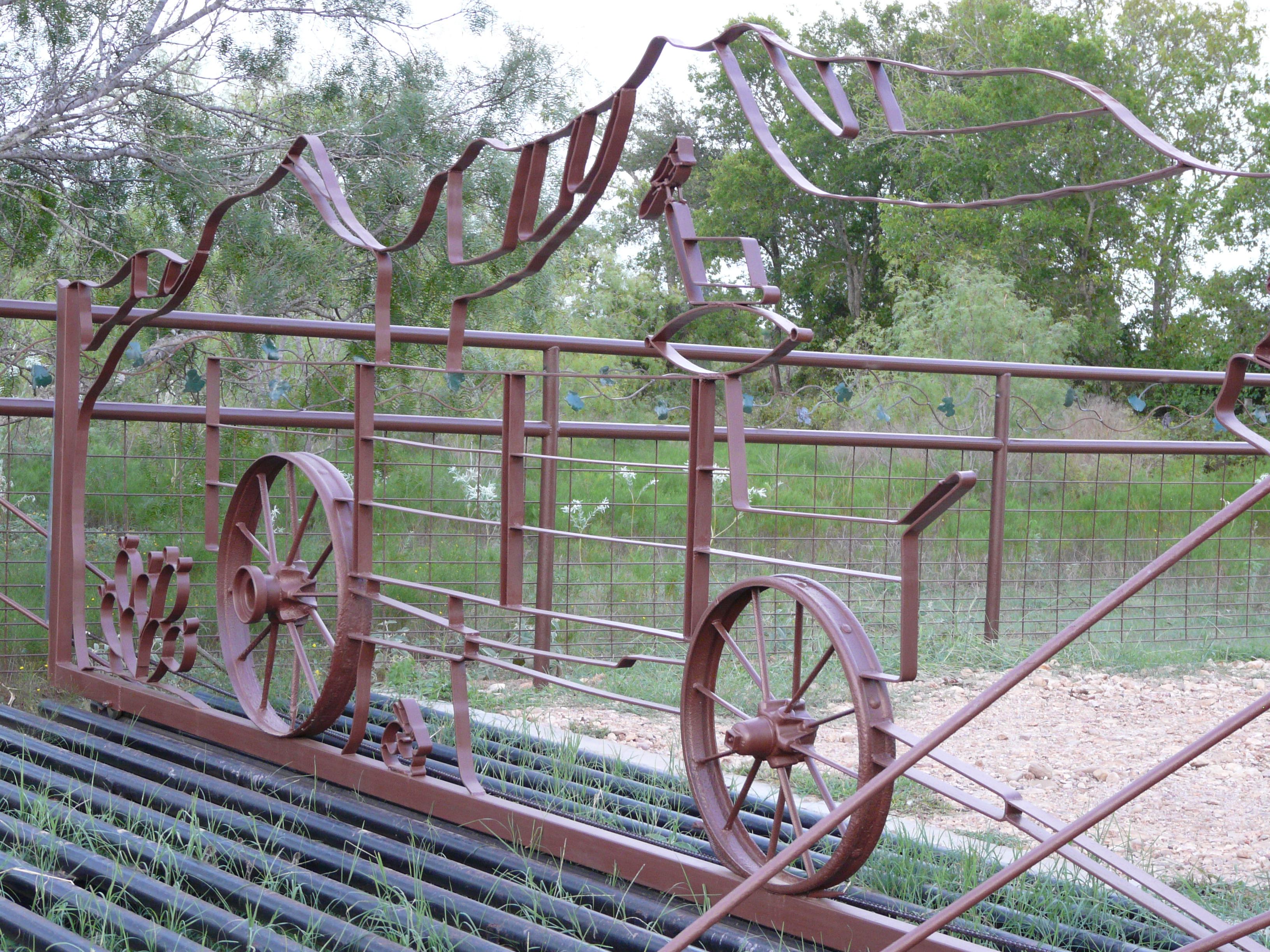

14ft is about what I'd consider the max for a decent quality (heavy) swing. Mine is either a 12' or 14' (I forget), and is the super-duty model from our local farm coop. It has served very well, mostly because the hinge post is 4" steel drilled into rock, filled with grout, and anchored with a couple of 1/2" x about 12" pieces of rebar. And the hinges are super duty, pictured below. And it is precisely leveled. I drilled and tapped a hole on each of the 3 hinge collars to add a zerk. One or two squirts of decent grease a year is all it takes to keep it swinging totally smooth and easy all through its whole range with very little force. Makes for low load on the Apollo solar operator.
Our plain galvanized "farm" gate looks a little industrial, and we like it that way. It looks like a serious gate, not something haphazardly thrown up by local yahoos. IMHO, this discourages ne'er-do-wells just a little bit. I've toyed with the idea of painting it a nice dark forest green or maybe even black.

If all you are trying to do is keep animals in, then why not go with a cattle guard/texas gate?
