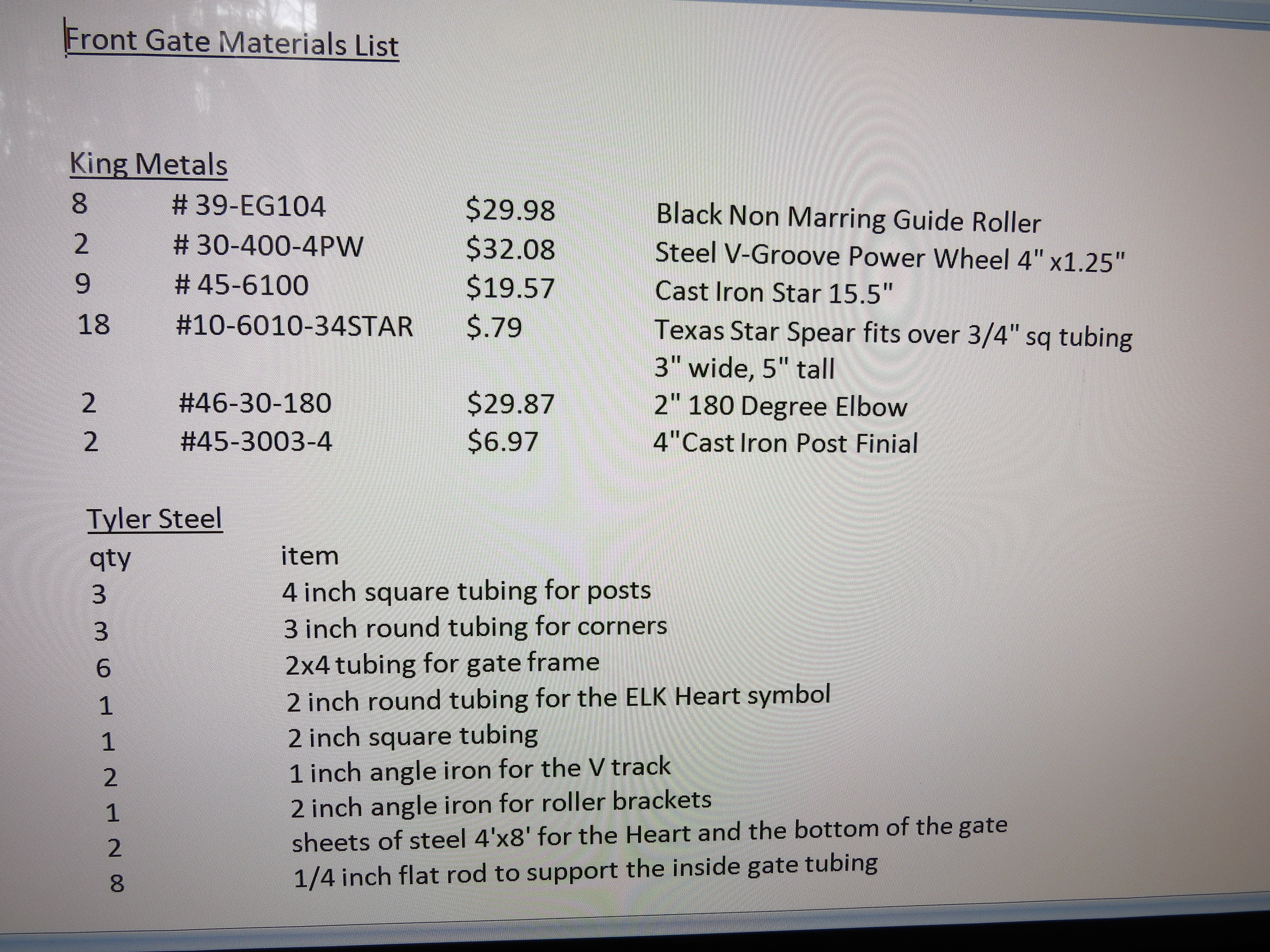

I've decided to go with a sliding gate. I've never done one before, so I'm hoping that the number of mistakes I make will be minimal. I'm looking into the wheels and track to use and saw some pictures online of the angle iron being welded onto what look like a 2x2 square tubing. The tubing is then set in concrete at the driveway, and kind of bridges out over the ditch on the side.
Is there any reason to buy or use the angle iron for the track? Why couldn't I just turn the 2x2 square tubing diagonally and use that edge for the wheels to travel on?
I'm going to order these wheels Steel V-Groove Power Wheel and see how well they fit on the angle edge of square tubing.

The reason not to use square tubing on edge is that it usually has a more rounded edge while the angle is square cornered. This allows more contact with the V-groove wheel. I'm afraid that the tubing would start to wear due to the limited contact area, much like a v belt will wear out if used in the wrong pulleys.
   / Entry Gate advice appreciated. #89
I think the angle iron would be cheap enough and much easier to replace than 2x2 half buried in concrete.

They have the angle iron welded to the flat bar that I can buy, and it's not too expensive, but I have several 20 foot sticks of heavy 2x4 tubing already. I'm going to weld the angle iron to the top of that along with some plating or more angle iron to the joint where I weld the 2x4 together to get it perfectly straight and flat. I will then set this up where I want it and pour concrete below it and along the sides of it. I have a 24 inch bucket on my backhoe and think that might be the perfect sized ditch to dig for this. I'll also lay my conduit at the bottom of the ditch before pouring concrete over it. One will have power going through it, the other will be empty for for later use. In the future, there will be cement trucks going across this, so it needs to be as strong as I can make it!!!!

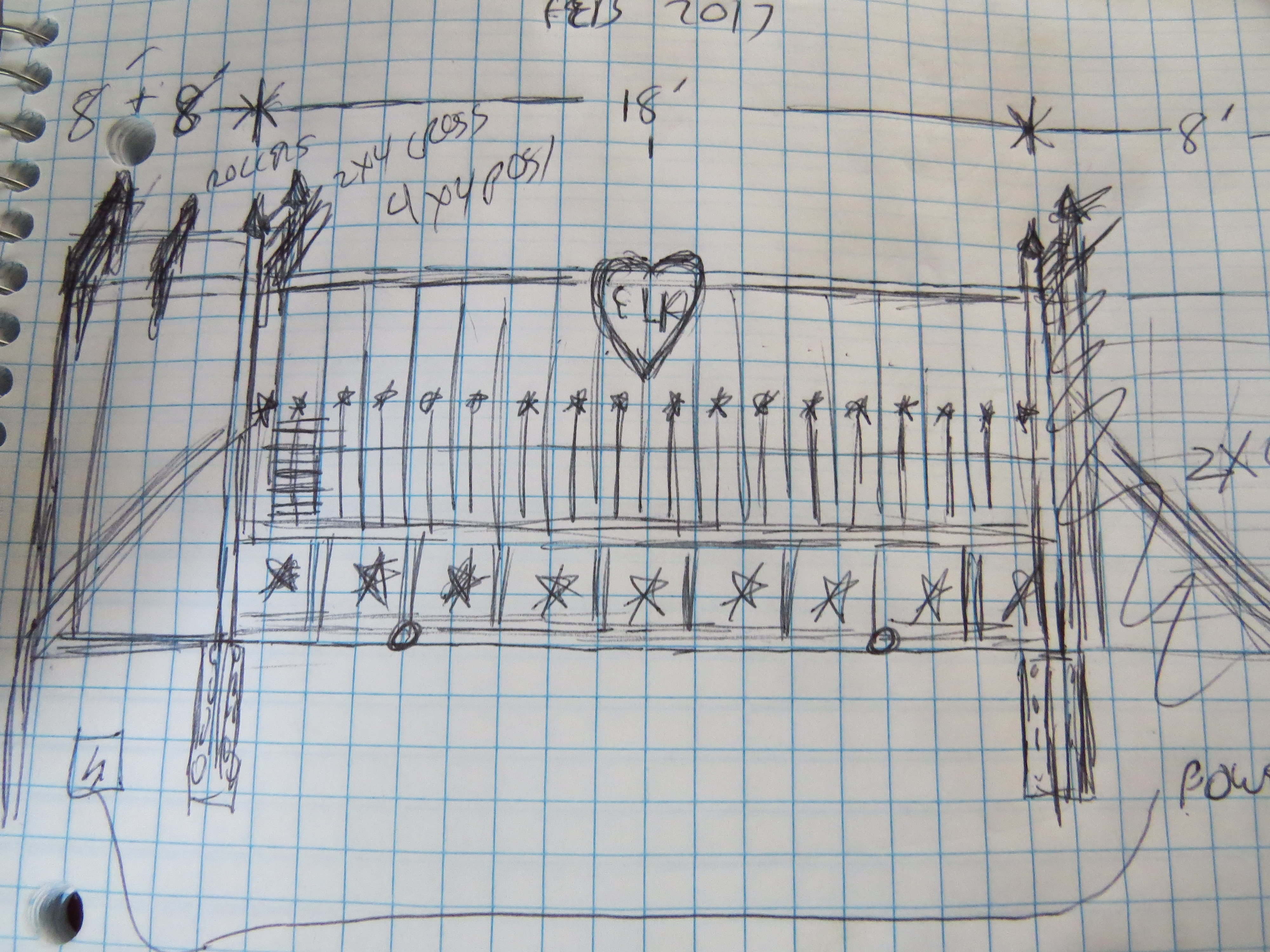

Here is the sketch of what I'm hoping to create. My current width is 18 feet, and the gate height will be just over 8 feet.
I have some steel already, but this is my current shopping list.
I'm not going to have rock pillars or anything like that. Just the four inch square posts on either side of the gate. Then there will be a flower bed built from retaining blocks along the front and over to the side that should tie everything together.

Hmm, it looks like you'll be using twice the track I'm used to seeing, all of ours had it only between the gate posts. We had one v roller on the front and the back was supported on a rail that extended in the direction it opens. That also cut down on the need for guide rollers. Just going from memory here, I didn't get in on installs very often, only when they were short handed and had to Shanghai a shop guy.
Are you putting the 2x4 down so the 4" side is up? I'd assume so so the angle can be welded to it. If so, think about drilling some holes down the middle every 2 feet or so and plug welding in a chunk of rebar to keep it from deflecting under heavy traffic. It only has to be welded on top, and since the angle iron track will cover them, the welds won't need to be cleaned up. Maybe run your conduit through there as well, unless it's too big to fit inside the rectangular tube.

I've been googling sliding gates and what I've seen has all had the track going back far enough to support the gate when all the way open, and the gate having two V track wheels at the bottom. I've seen a variety of ways to mount the wheels, but they all seem to have two of them.
I don't understand how your system supports the gate?
I'm trying to keep this as simple as possible, which means to me, fewer problems. The picture below shows what I'm thinking with the track.

That will definitely work, and is pretty simple and foolproof. I might be confusing chain link roll gates with the OI, I know that the chain link ones with wheels are supported at the back, but they aren't nearly as heavy and don't have a track to run on.
I'm sure you already know, but when your putting in the pickets, start at the middle and work out, that way you won't end up with a 4" gap at one end and 3.375" at the other.
