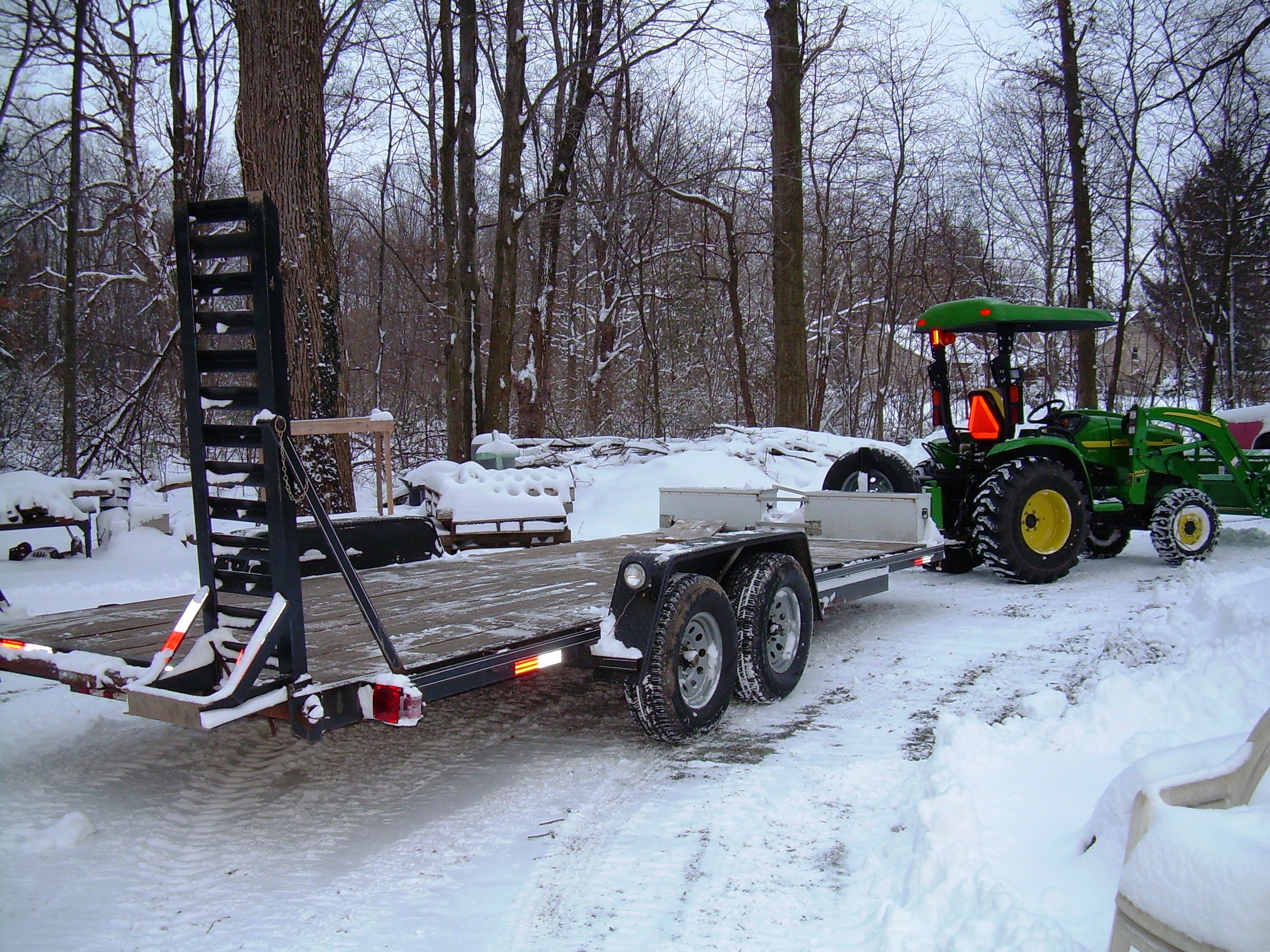

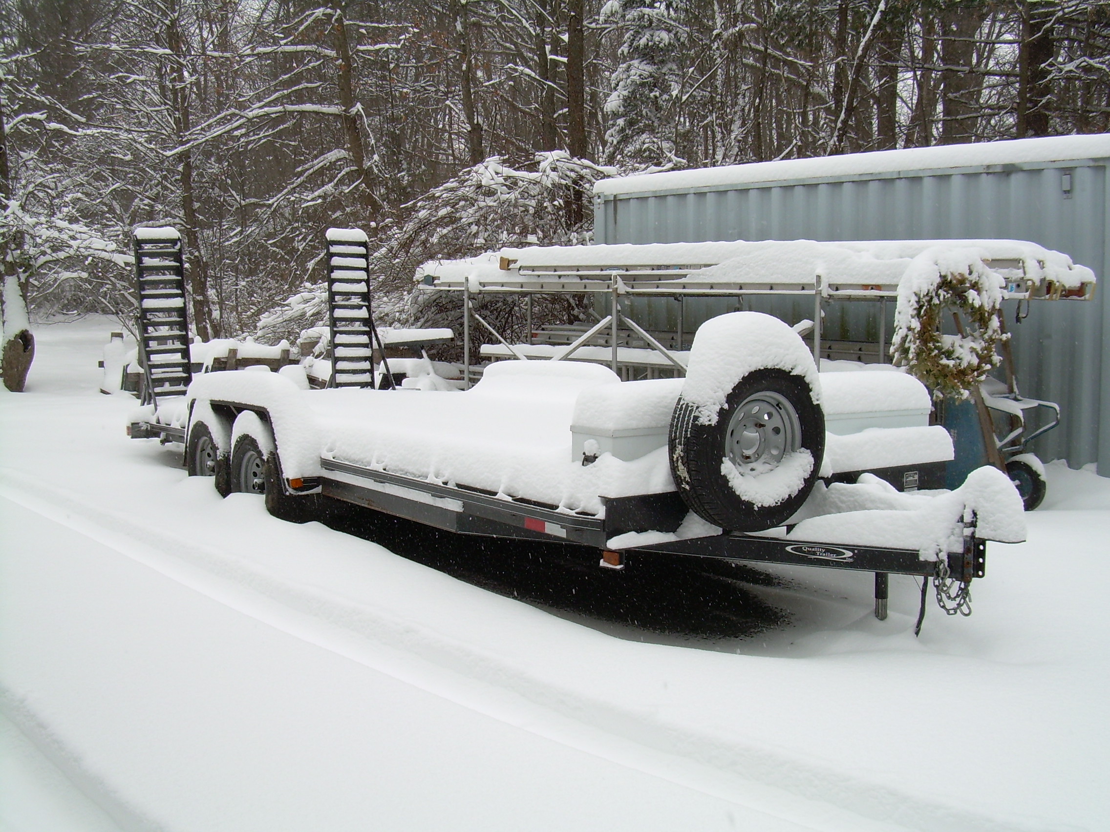

Stupid ground hog brought us more winter, we had snow on the ground all winter since early December, it was slowly melting and we were able to start thinking about doing things outdoors besides snow removal, Then bam! another storm.
I bought the trailer during the lull, most places only had snow where it was piled, now I can't even try loading tractors on trailer, will have to wait a little longer.
I hooked up my 3pt trailer hitch to it and makes it easy to maneuver around the yard and dock it in a out of the way parking spot.
Next posts will be about the best ways to tie down equipment on trailers, anyone have some good pictures of how they do theirs?

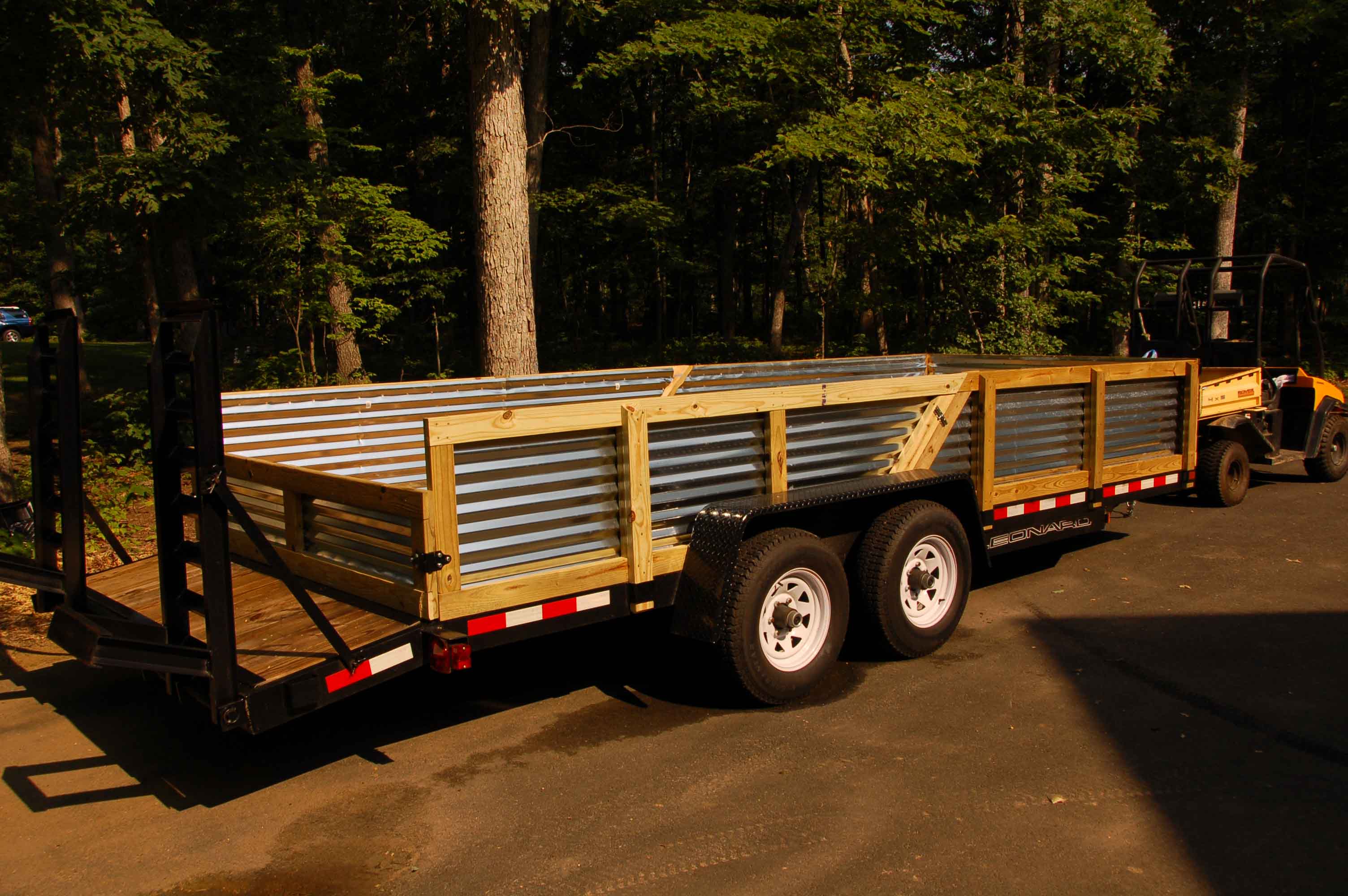

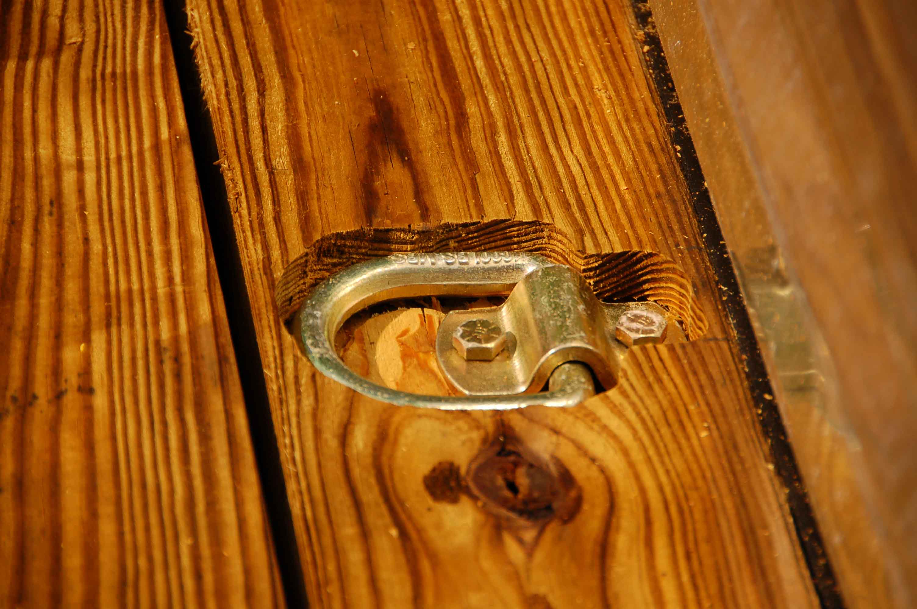

This has worked really well for me. I have a variety of places to tie down and since I also use the trailer to transport stone/mulch, I used my router to make 'pockets' so they stow flush with the deck.
Each of the tie-downs is bolted to the underlying cross-beam with Grade 8 bolts/washers. Each hook is rated for 12,000 lbs, so I'm sure the cross-beam would break before the eye does. I tie my tractor down with chains and either over-center or ratchet thingys...I have two of each. I've gotten the tie-downs quite tight with NO, ZERO, NADA, NUNCA movement in the tie-downs themselves. And they're large enough to pass the chain hook through, so tying down to them is a breeze.
In total, I have 12 on my trailer, 4 up front and 2 in the back on each side. I haven't wanted for more.
The only downside is that after transporting stone, I need to take a screwdriver and clean out the holes. Not a biggie, though...a beer or two's worth of effort on a lazy saturday.

That is a nice job you done.

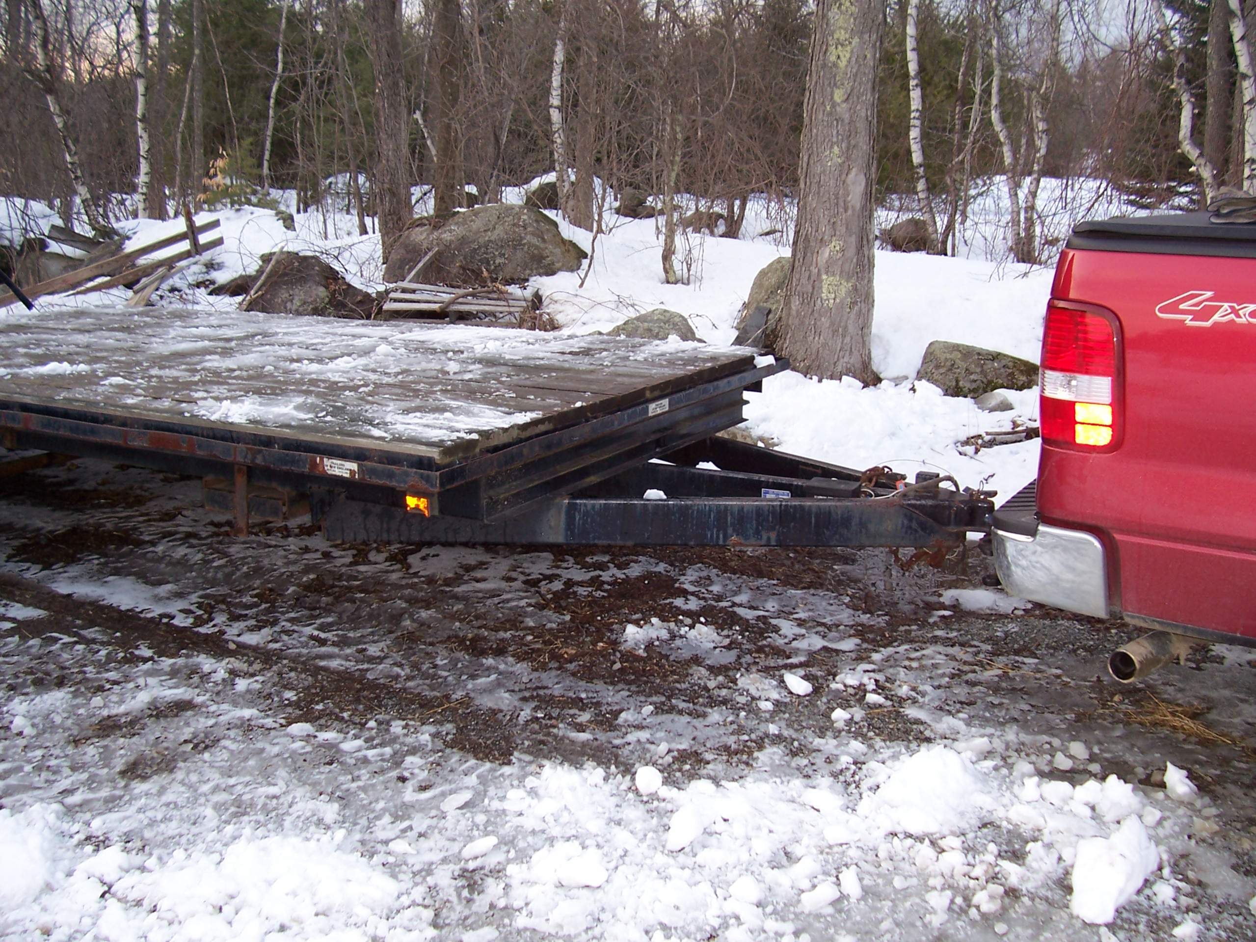

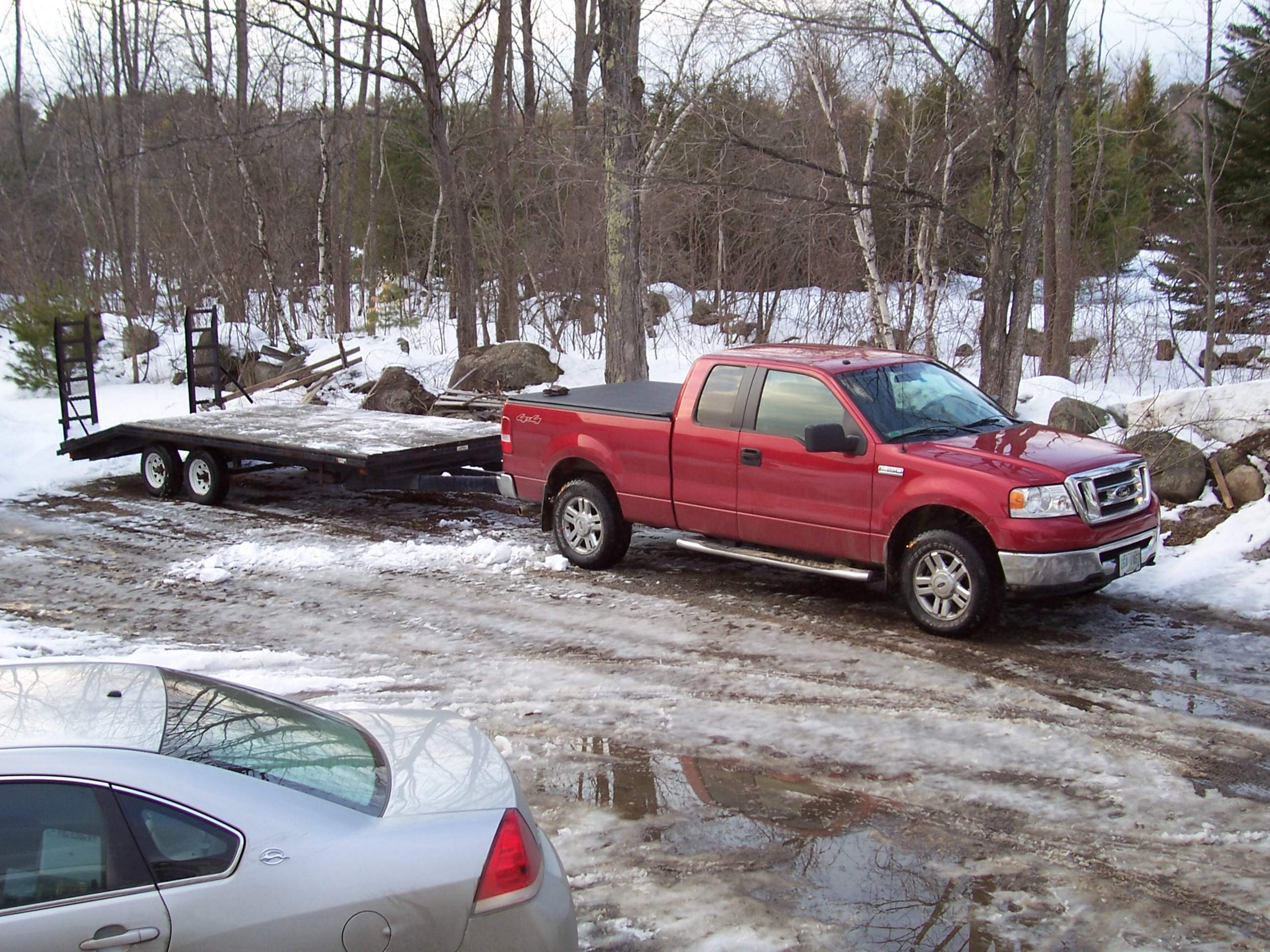

shvl73, I would like to see some pics of that without the snow. Thats an interesting trailer as its deck over but appears to be built more like a drop deck. Am I seeing it right?
I took a couple of pics today. I dragged it out and put the plate on it. Just about ready to hit the road. I changed the 6 wire plug out for the RV style to match the truck.
