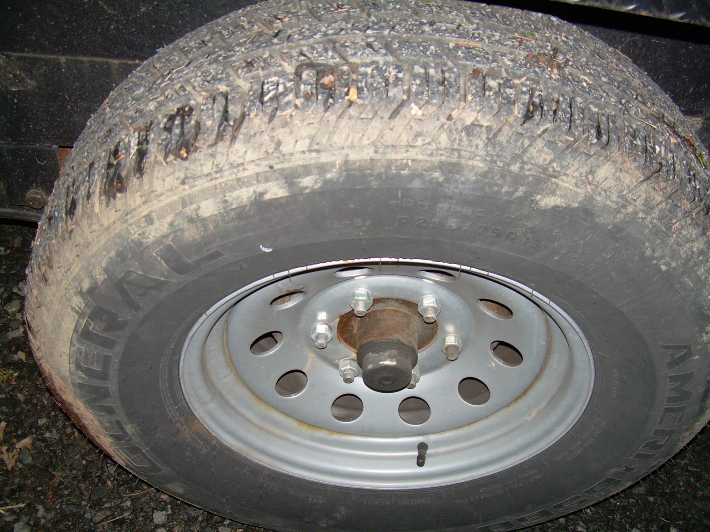

That's one heck of a deal for a trailer like that in the northeast area. I agree with the others the axles look to be 5200# units. If you decide you're not happy with it or its not heavy enough contact me and I'll take it off your hands. Definitely a good buy.
Thanks for the offer, thought if I wasn't happy it wouldn't be to hard to sell except most buyers would be looking for a full 5 ton I would think.
I was really surprised at how much my 12K MM pulls down while pulling a vehicle up my deck over. Granted its a much steeper rise but I would have thought it would do it with ease. Makes me think anything less wouldn't be up to the task.

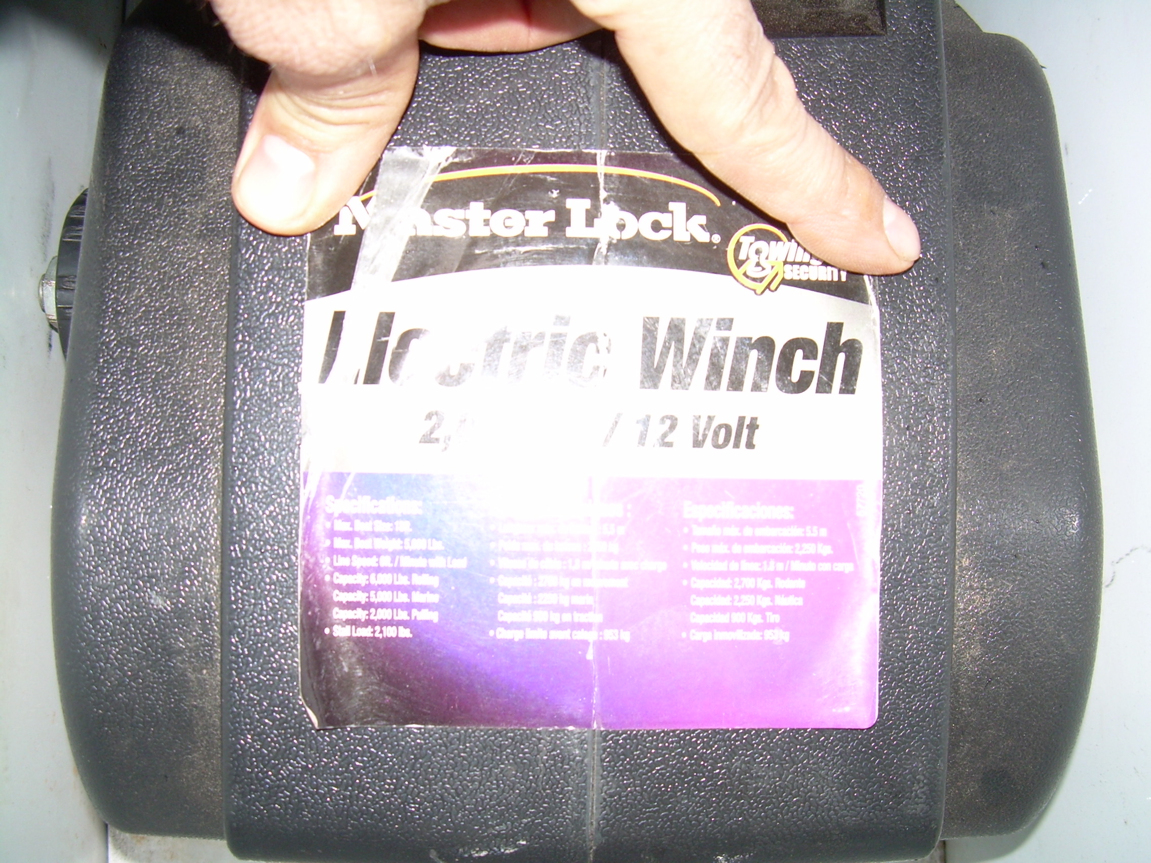

This winch is real cheesy, only 2 k, unrolled the whole cable and it sounded sick just pulling it back in with me holding back on it so it would coil up nice on the spool.

For your winch you can buy a longer roll of cable and replace the short cable you have then get the snatch block which will allow your winch to work easier pulling up a heavy load.

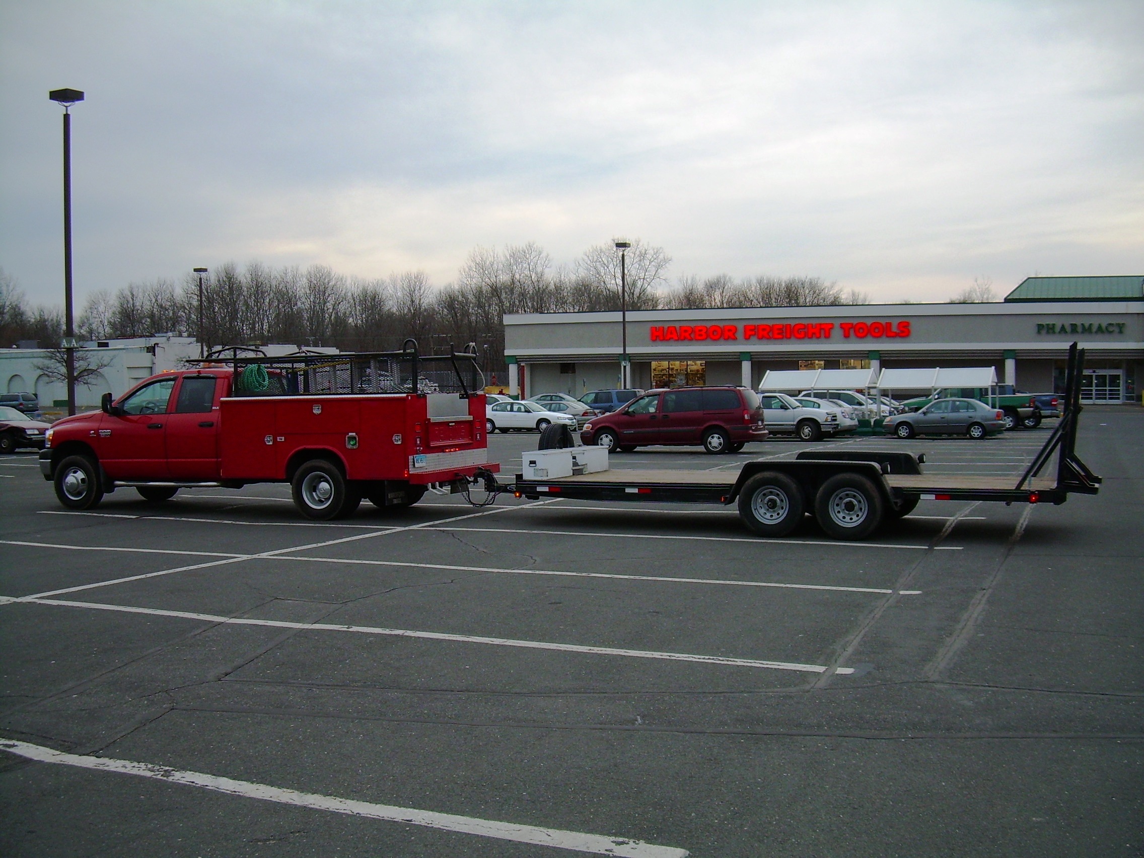

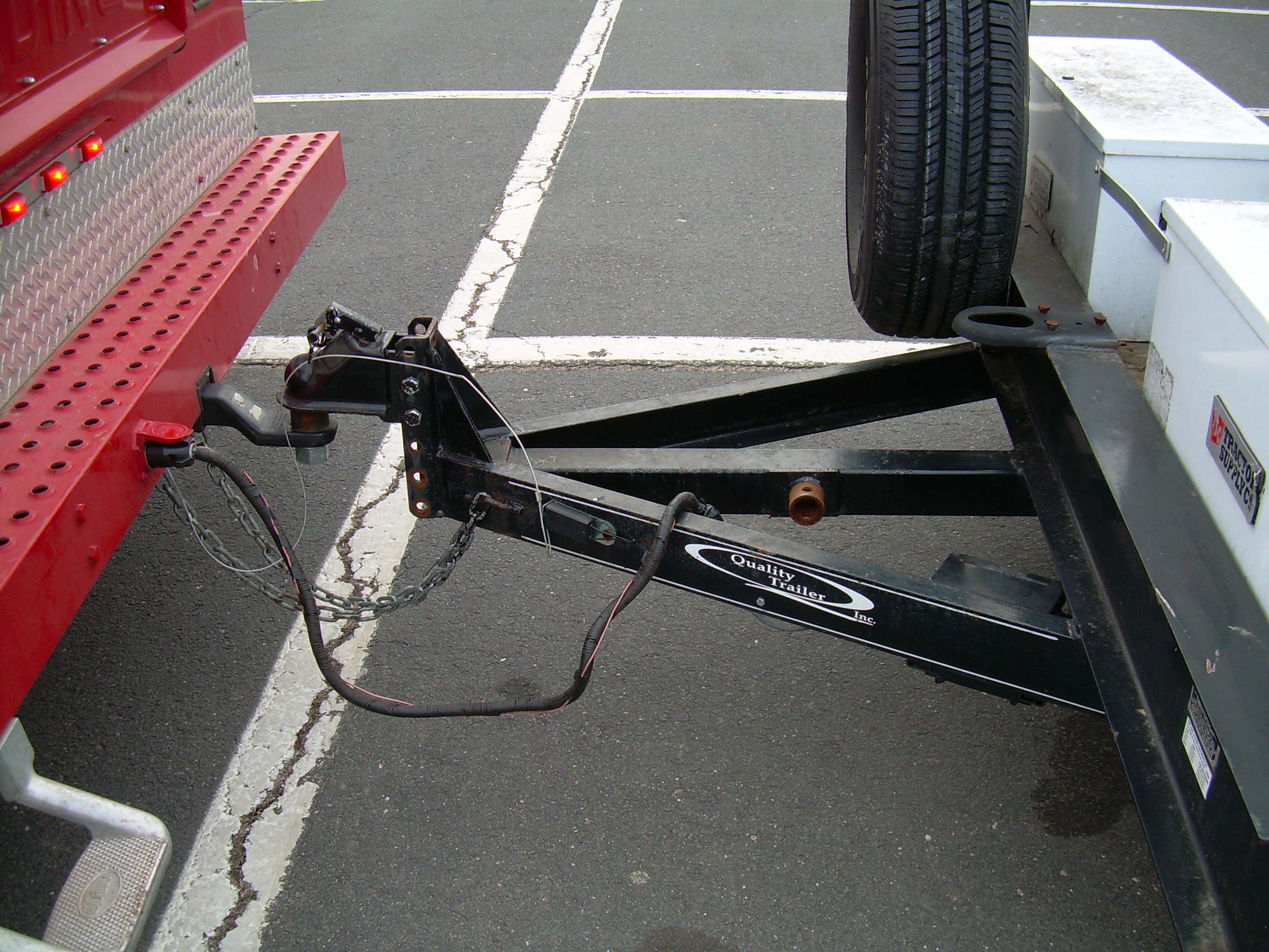

Yeah sounds like a good deal, I've seen Big Tex they do look HD, it's twice as heavy as mine. I also wanted an adjustable coupler, I've seen some that were fixed and didn't like them, seems like a necessity to be able to adjust for height. my flat bed and my dump both have the channel iron style where the coupler can slide up or down and be bolted where desired.
A little tricky finding a parking space with this long set up.

I really like those adjustable height tongues. I have one on a dump trailer. I also have adjustable height hitches that are way easier to adjust as they are attached with two hitch pins and can be raised and lowered in a few seconds. Great for my non-adjustable tongue trailers.
With the adjustable hitch I can crank down the dolly wheel on the trailer tongue to take the weight, chock the trailer wheels and adjust the height of the tongue while still plugged in, safety chains and breakaway wire attached. It is handy for adjusting the height of the dovetail, slope of the ramps for loading/unloading equipment or stock if using the stock trailer and then adjusting for proper clearance or level ride for highway transit.
