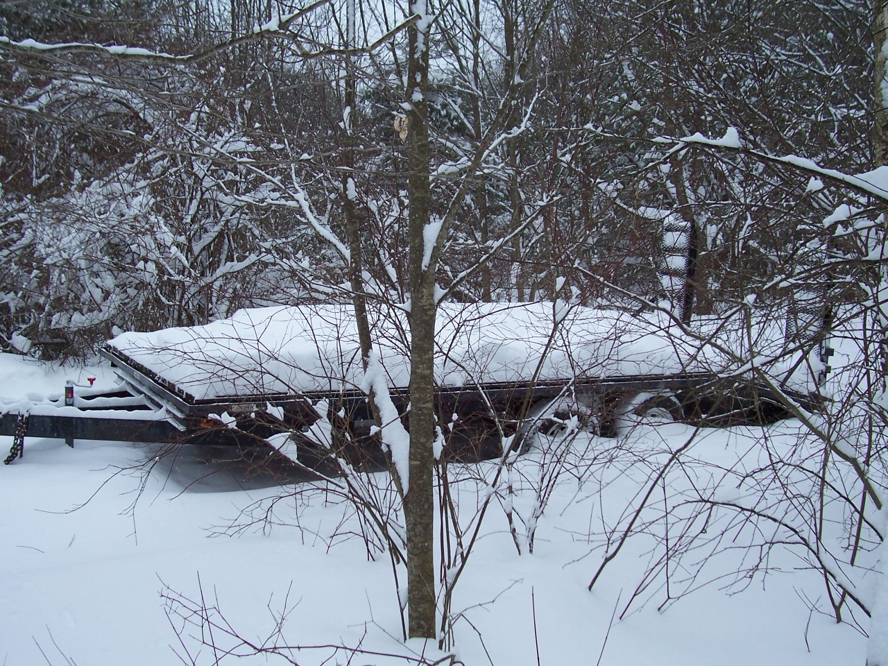

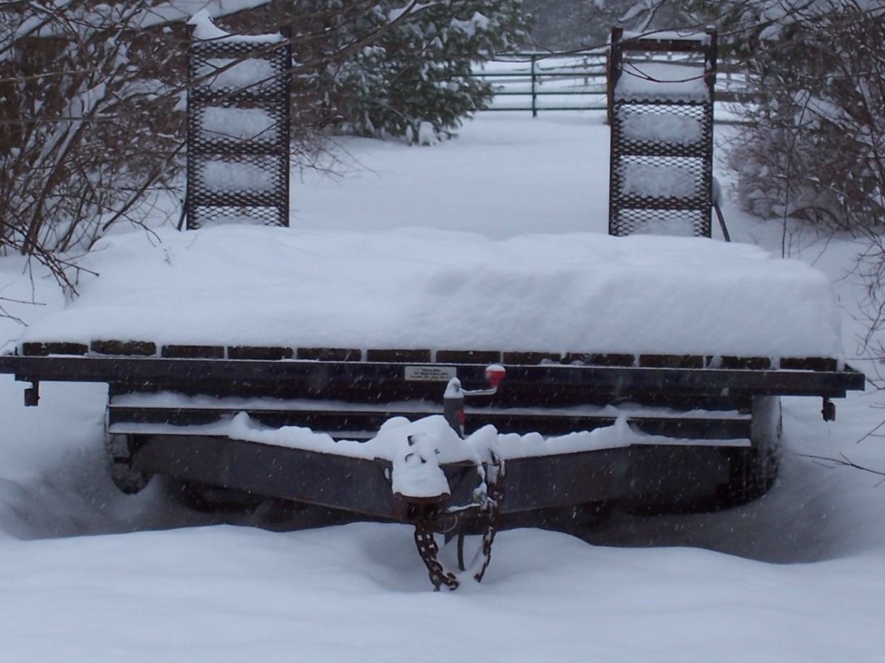

Thanks Chris, it's in suprisingly good shape. Alot of the stuff I looked at was abused and worked hard. Lots of damage, bent ramps, car tires, amateur wiring, etc...
This one has some surface rust underneath that I'll need to get after, still solid though, as I scraped and tapped the rusted areas. I just need to wire brush and paint some spots. Good matching trailer tires, one piece spoke rims, lights work (some cracked lenses - easy fix). Hubs never got hot, though I'll most likely re-pack the bearings anyway. The wood deck is old original though seems solid. Ramps are real straight, no bends. It has an additional ramp stored underneath. I didn't pull it out, though I'm wondering what it's for. Maybe a tricycle gear tractor? The a-frame doesn't go all the way to the axles :(, but it seemed solid enough constuction for the weight rating. I was curious about the weight rating, the rims are 5 spoke yet the dataplate says 7.5K, I thought those axles would be 3500/ea?
I've attached a couple of pictures, as you can see, we got some snow this morning.

The extra 500# is because they are giving you credit for the weight on the ball. You can allow for up to 10% of the total weight.

It looks like a modern trailer from what can be seen with all the snow, I see it has a beaver tail to facilitate loading, must be plenty wide. As far as the axles go, they could be like mine where the tag says GVW of 9,000# but the same tag says axles 4,000#, cause they are figuring some of the load on the tongue which is legit as long as you don't exceed the axle rating or tire rating.
Good luck, JB.

shvl73, I would like to see some pics of that without the snow. Thats an interesting trailer as its deck over but appears to be built more like a drop deck. Am I seeing it right?
