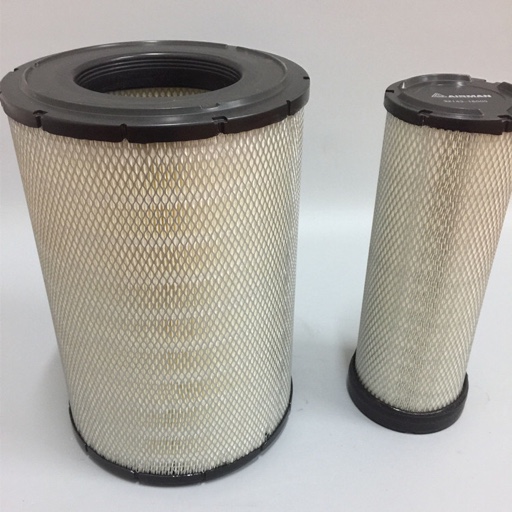

The inner filter is basically a safety filter in case something gets past the outer primary one. The NX comes with the primary filter only and no inner safety filter. The inner filter pushes into the plastic housing first then the primary goes over the inner filter and seals into the housing. IMG_1204.JPG
