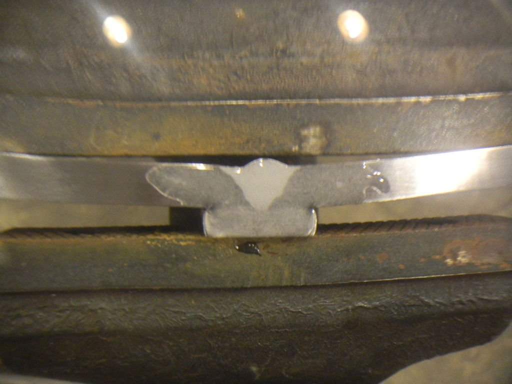

I love this phosphoric acid! It give results very fast.:cool:
This is really dis hearting:shocked:. This is the 3/8-inch thick V-butt test plate I ran with the Everlast 120-volt Mig welder. Wire speed maxed out, and the voltage turned down just a bit. This is the last 1/2-inch of the plate. So it should have been about as hot as it was going to get. And I preheated this test plate before I started welding.

Oh it does Dave! Only takes a couple minutes to see the results too! :cool2:
   / Etching welds. #24
Very interesting. What phosphoric acid concentration are you using for the tests?

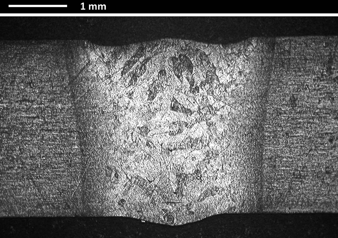

Back in the mid 60's when I was working on my degree in metallurgy, I spent a couple of summers working for Kaiser Steel in the metallurgy lab. The acid we used for etching was hydroflouric acid. It will actually disolve metal and leaves a very clear image of the grain structure. It has to be stored in a special plastic bottle as it eats glass.
It looks like this.
