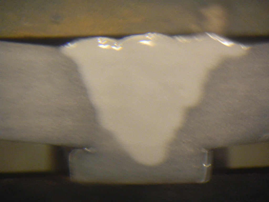

Third picture is the weld made with the Lincoln V350-Pro,
Shield Arc, that V350-Pro must be an awesome machine. That etch is picture perfect. :)
I've never seen an etch weld pic showing that much penetration down into the corner before. :thumbsup:
/ Etching welds.
#32
Oh yeah she is a sweet machine. These inverters just amaze me with the control they have over the puddle. That weld was run with 0.0 on the pinch / arc force. Need to run a fillet weld with it, and set the pinch / arc force up more and see if that gives any more penetration.

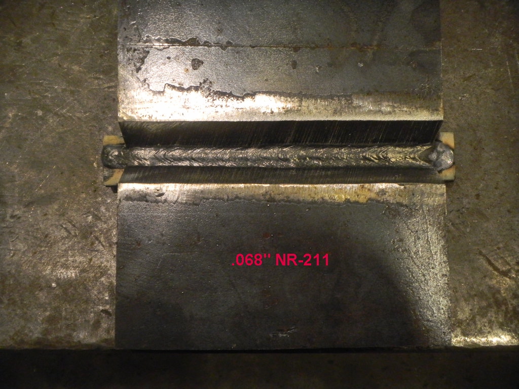

I was just in the shop cleaning up around the saw. I found this 3/4" thick V-butt weld I did last summer with .068" NR-211. I thought, well lets see how it did.:laughing:
/ Etching welds. #34
Looking good. :thumbsup:
Now that you've got your etching skills perfected, you'll probably be etching anything and everything you've done in the past, that you can find.
You might even need to order a couple more bottles of that etching elixir. :cool2:

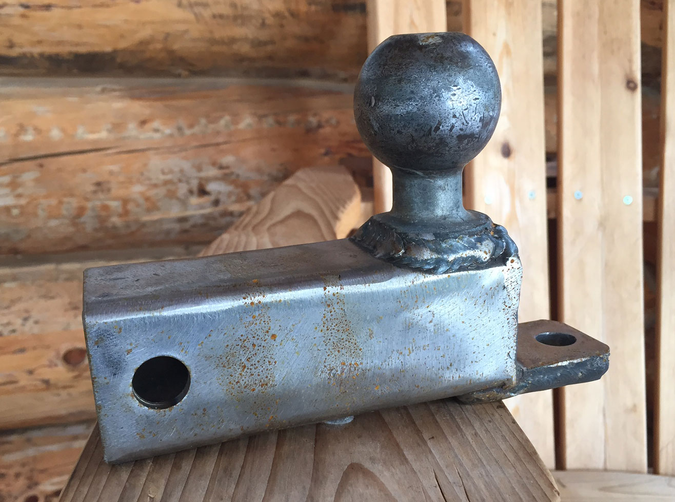

Here's a natural etch, using water.
I welded the ball onto this simple pin hitch. It's for a neighbor's ATV, used mostly to move his firewood splitter around. He wouldn't go on the highway with it, this is an ATV unit.
I welded the ball on, then realized that the ball was too close to the hitch so had to move the hitch pin hole. I cut 3/4" off the end, cut in the middle and welded it back in with 1/8" gaps to get a full inch.
