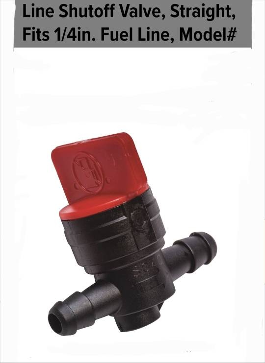

Yesterday a neighbor & I were talking about ethanol gas and carburetor damage. He showed me he puts one of these in line gas valves in every mower & small engine. Before shutting off you close valve running carburetor dry.

Yesterday a neighbor & I were talking about ethanol gas and carburetor damage. He showed me he puts one of these in line gas valves in every mower & small engine. Before shutting off you close valve running carburetor dry.View attachment 3558088
I have a Honda lawn mower and genset. Both come with shutoff valves from the factory. Owner's manual for both recommends running the carburetor dry, and it also recommends to use non-ethanol gas if possible.
