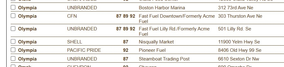

I know I went to Boston Harbor Marina with no luck... may have been timing?
It would be a miracle if you have a source in or around Oakland California.
Edit: It does show 19 for all of California...
Edit Update... Just called the nearest one listed in Sunol California and they do sell leaded racing fuel but no E0
The person I spoke to said not for a long time yet it still shows on pure gas.
