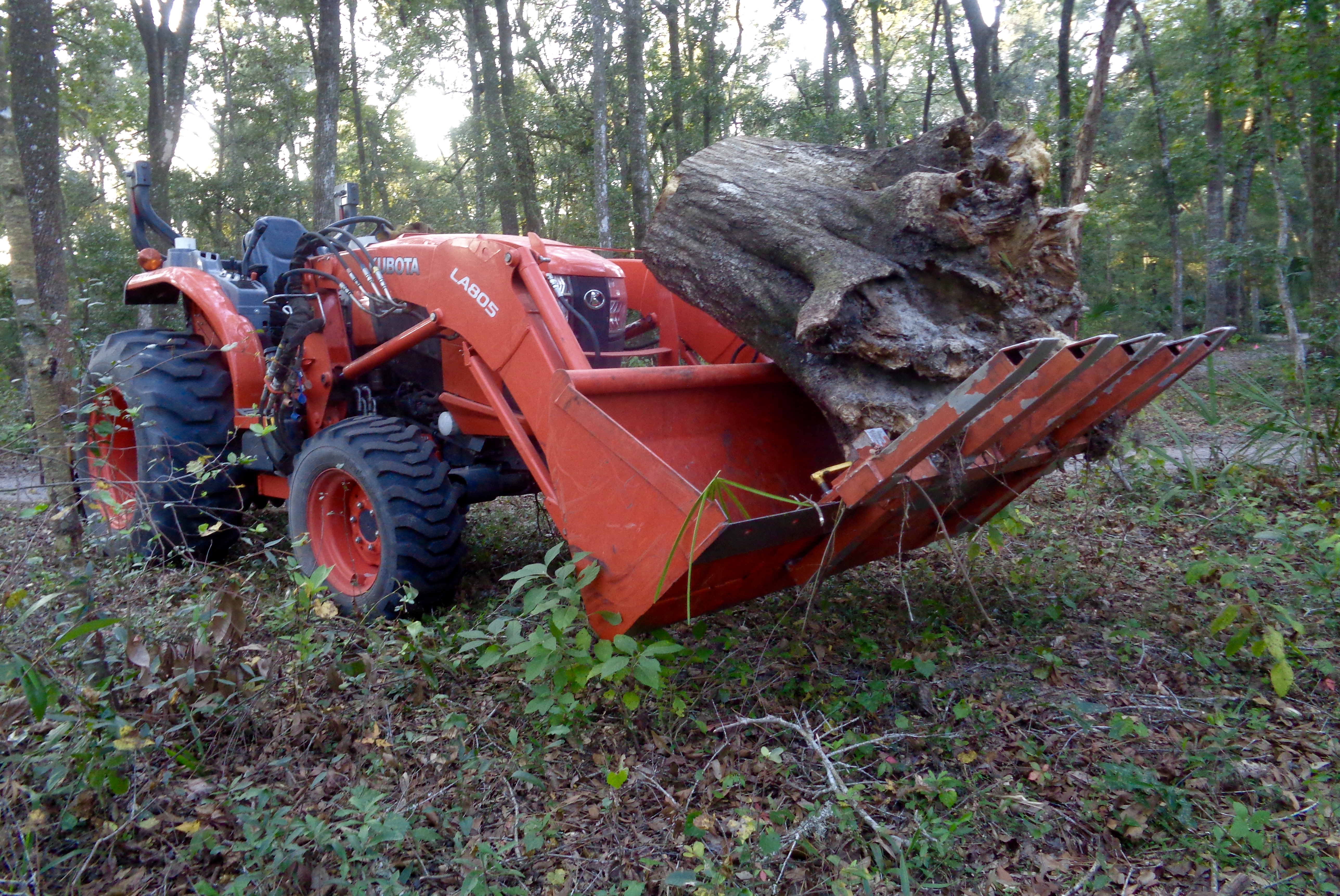

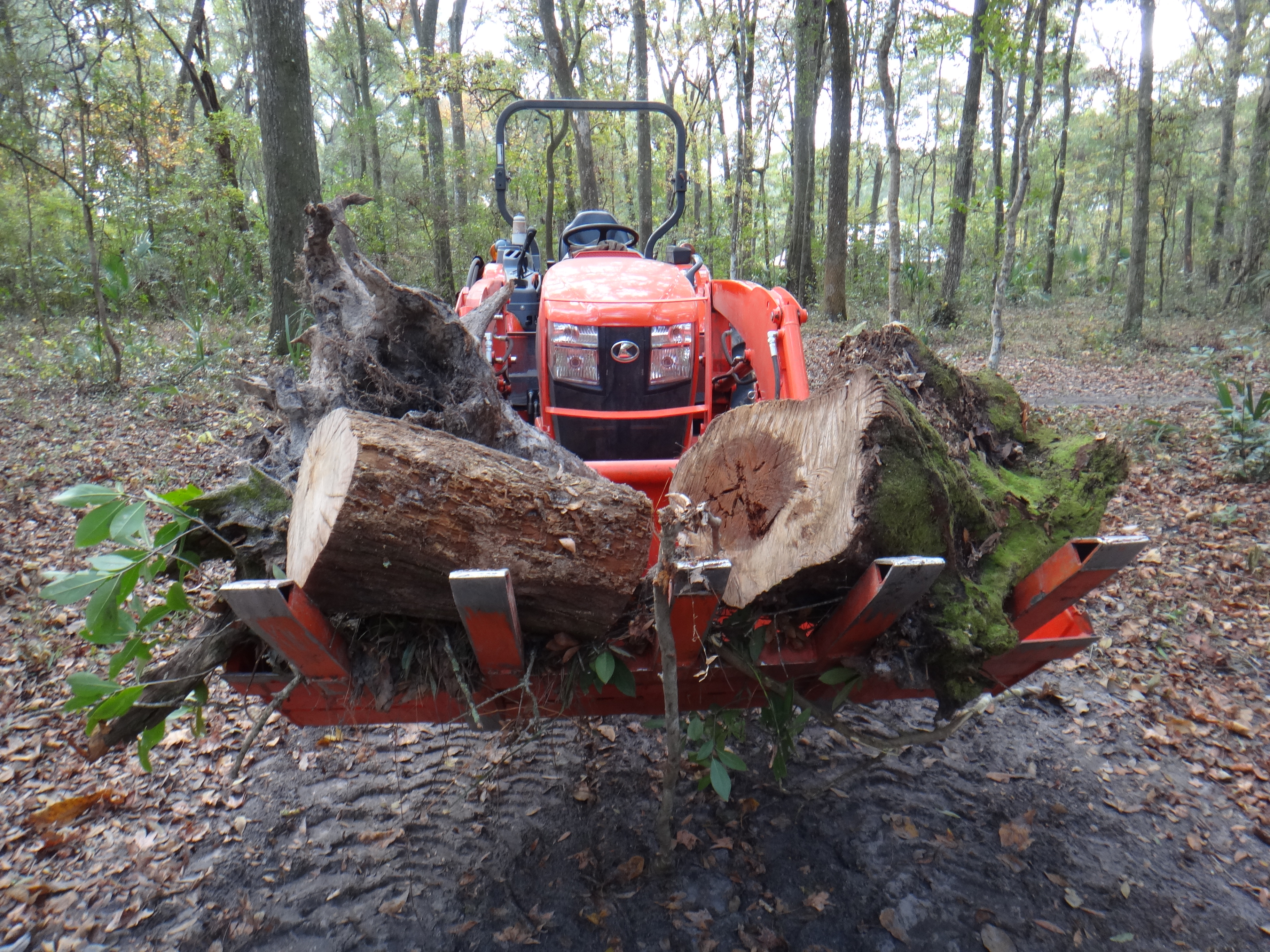

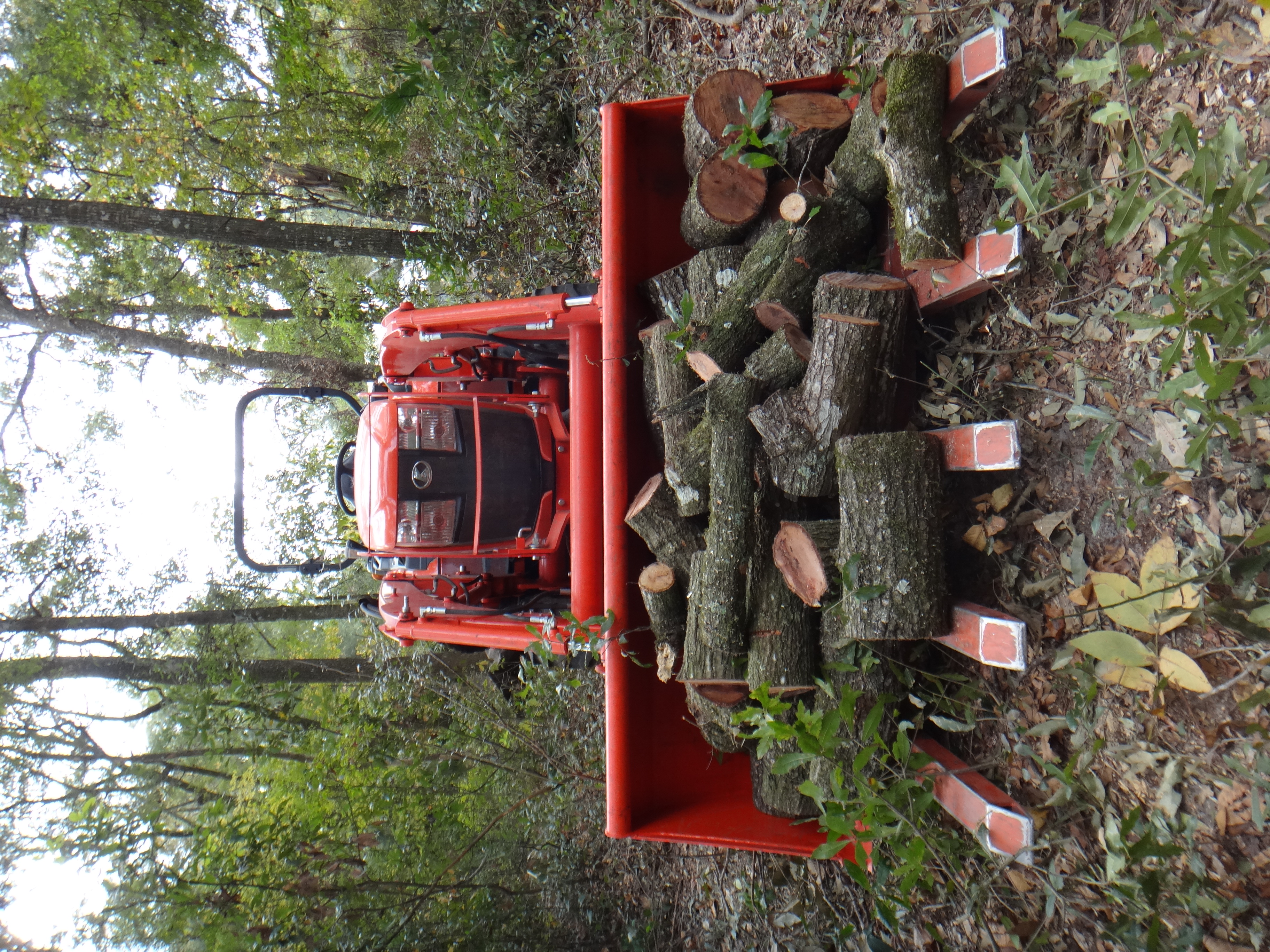

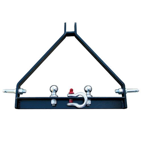

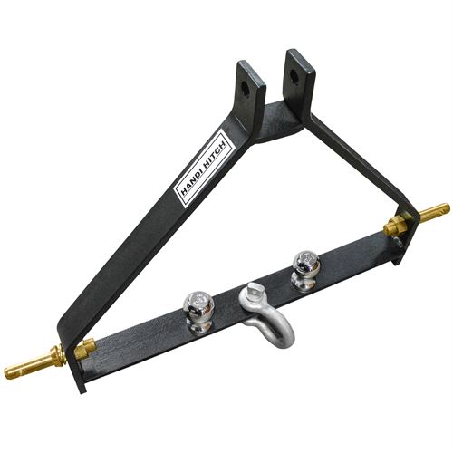

Firewood harvesting and hauling (I have a small wagon for hauling cut wood back to the house)
Photo #1, #2
Most, however, would use FEL bucket, sometimes with forks.
Other Photos.
