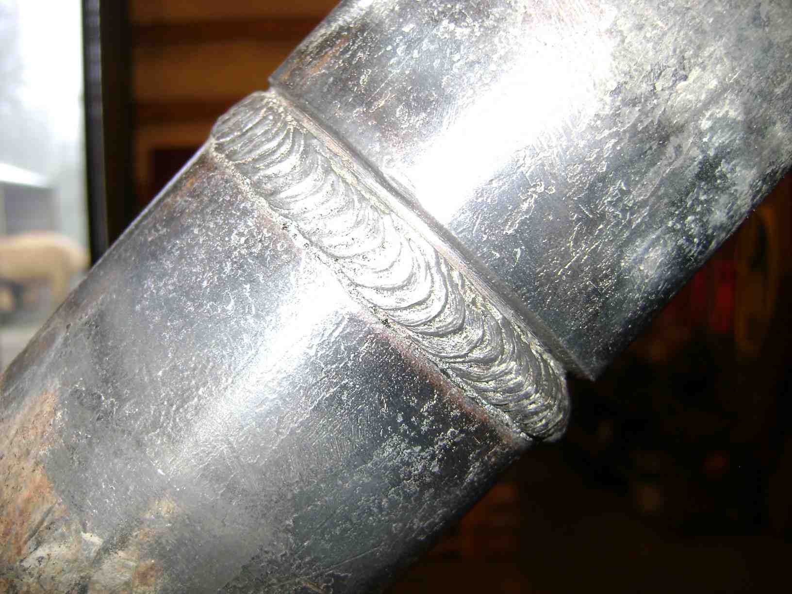

If you can possible swing it, get the PA 300 with adjustable hot start, and arc force.
If you blind folded me I couldn't tell the difference between my Lincoln short hoods and my PA 200 when running 6010.
