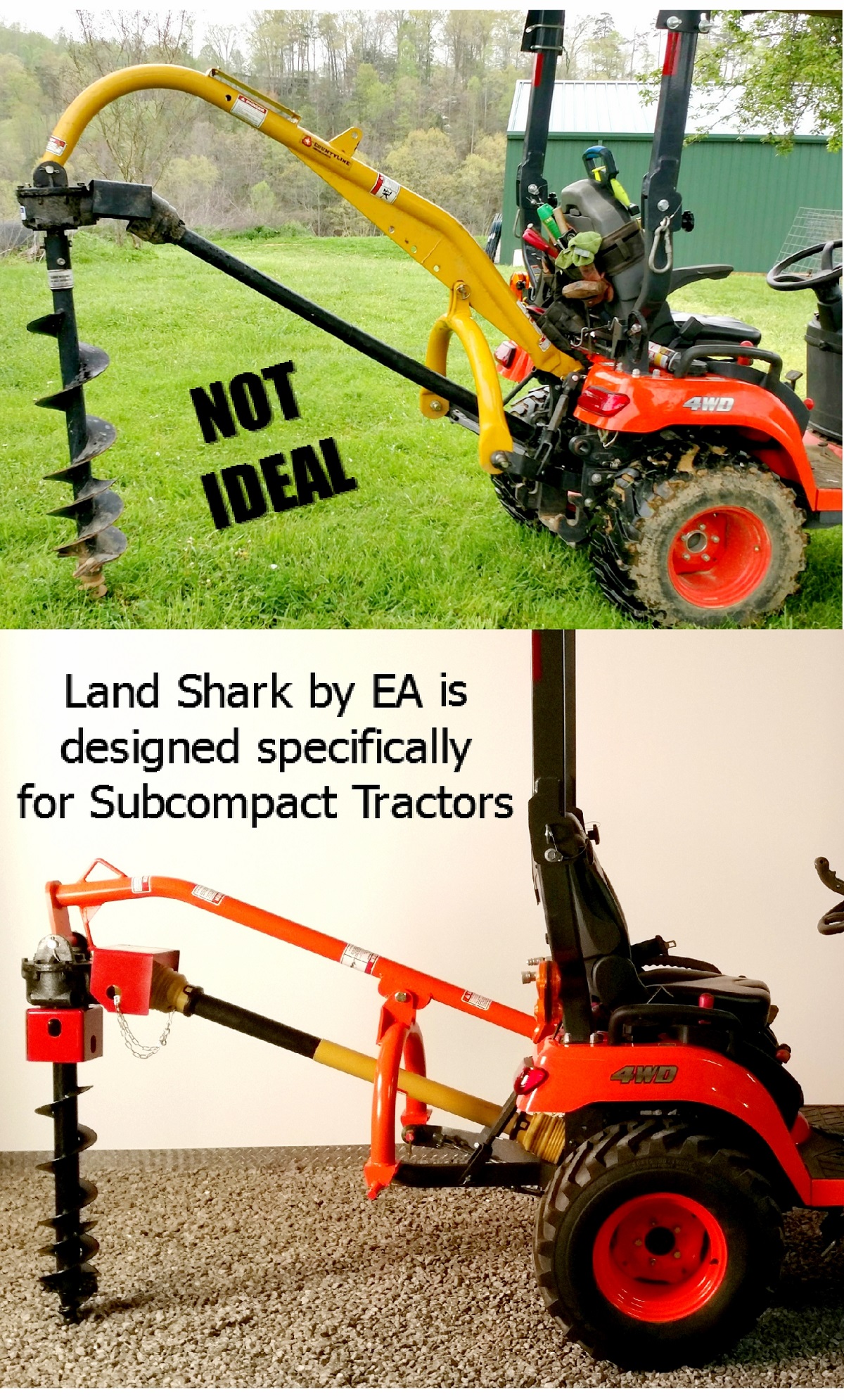

I知 looking for a post hole digger for my JD 2025R. Bout the size of a 2601. I致e watched all of Teds videos. He almost says which one he prefers for a B series then gets sidetracked. So which one do you guys suggest? The compact or subcompact. I see they are the same price. Most likely I値l use it for setting 4x4s in concrete for a shed addition to barn and some deck post repair.
Concerning our B Series and your 2025R, one could really go either way. Our Land Shark Subcompact PHD comes with a 36" length auger. One complaint about tractor post hole diggers is their tendency to get stuck in difficult soil. The subcompact model features a shorter boom, which keeps the auger closer to the tractor and increases the tractor's lifting ability in difficult soil. This greatly lowers the likelihood of getting it stuck.
We've sold our EA Compact PHD for B Series/2000 series Deere tractors, and smaller, for years. It features a 48" long auger as well as a longer boom to ensure sufficient ground clearance.
Here's an illustration. It shows a "normal" sized unit with a longer boom and our subcompact model on a BX tractor.
ALL of our post hole diggers for Category 1 tractors ship FREE to your home via FedEx Ground within 1,000 miles of Newton, NC.

Thanks for the reply. Guess I’ll just have to decide. I’m still on the fence and looks like there’s not one that is clearly better than the other in my situation. I think the landshark will be best. And can you request it in yellow instead of orange still?
