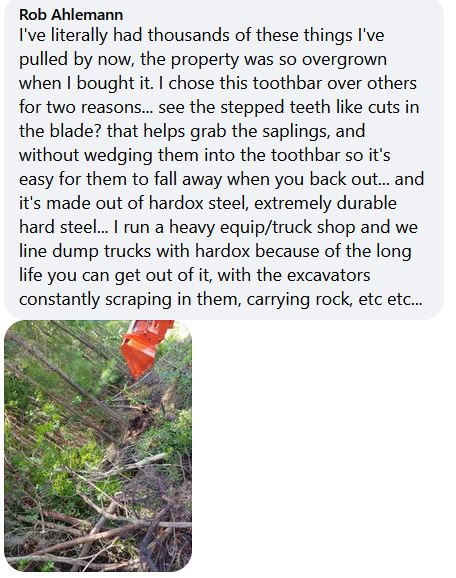

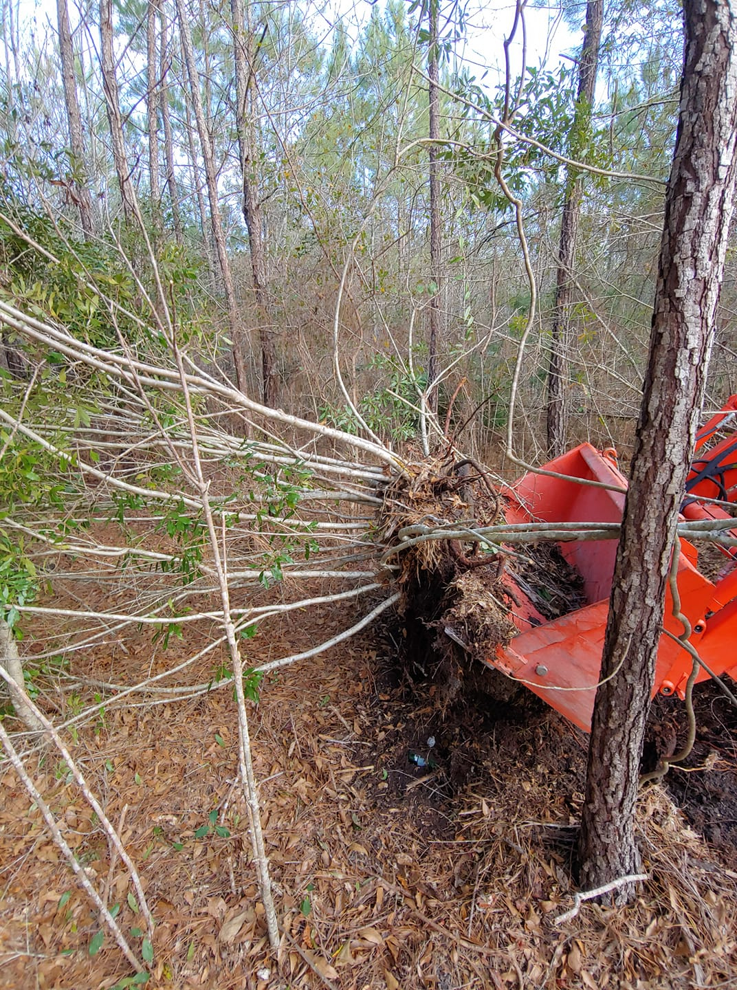

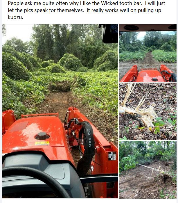

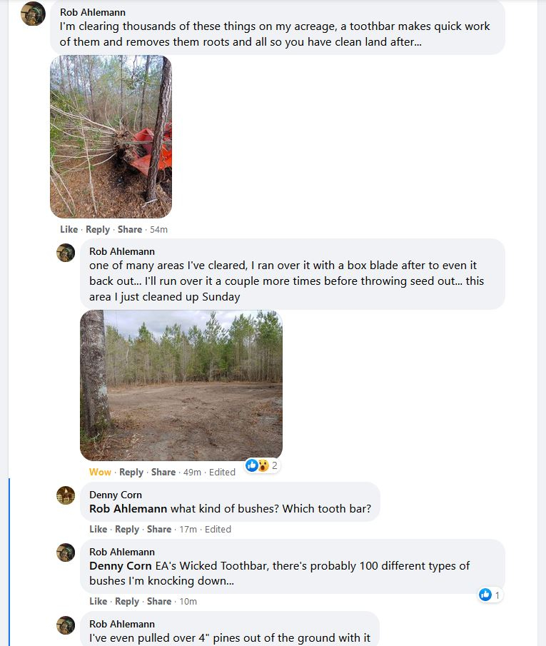

Is there an attachment that excels at pulling out shrubs and bushes such as Olive and Rose? I'm envisioning something like a grapple that opened and clamped vertically with tines close together so when clamped could grab on to the stalks near the ground. Maybe a narrow (say 16") QA front bucket or spade. My grapple isn't effective the stalks just slip through the tines so what I am mostly doing is crawling under to get a strap around the base then pulling them out.
I'd take a look at the Wicked Toothbar and all of the reviews/pics on the page. It is excellent for ripping up and digging.
Travis

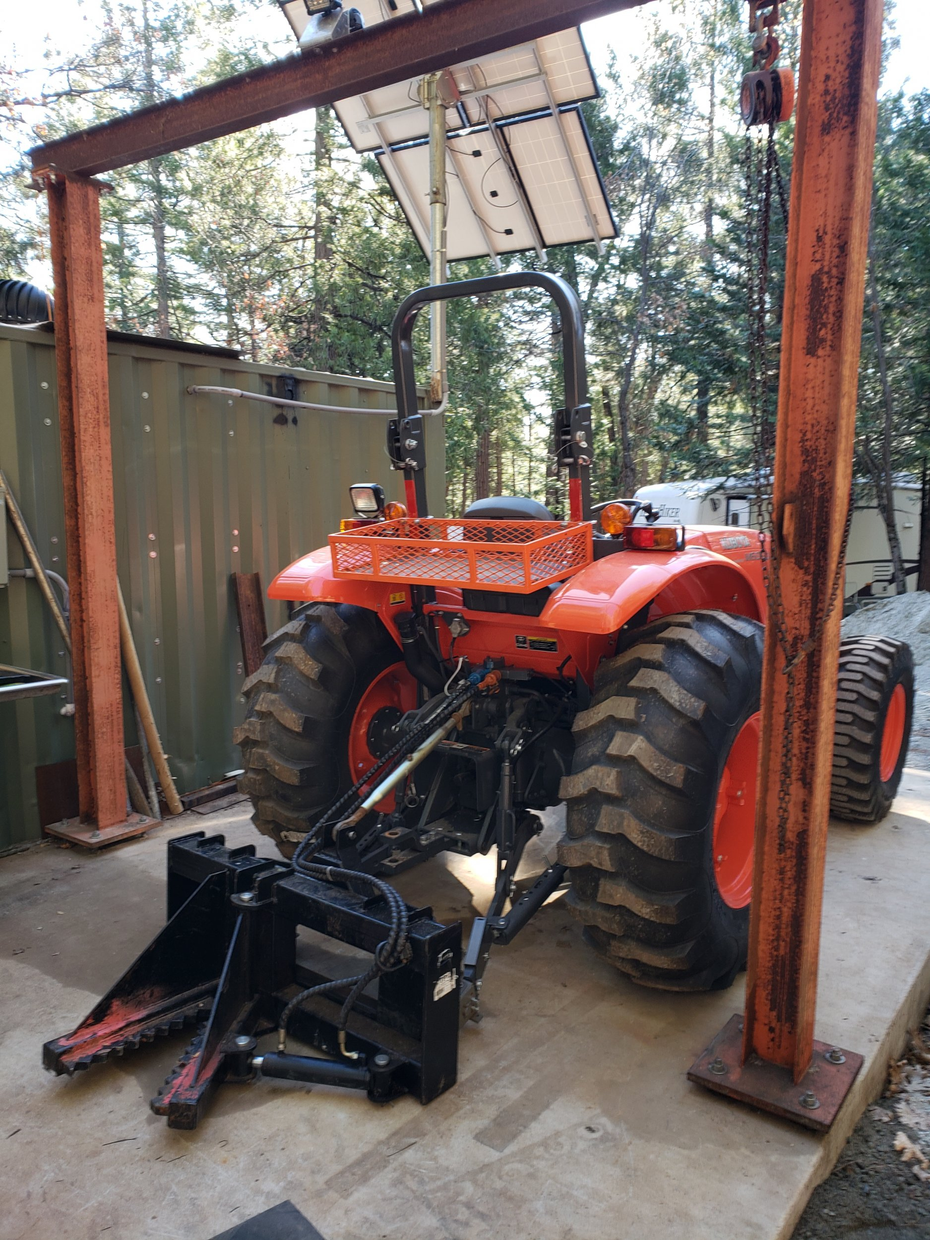

I use this to pull brush and small treesView attachment 712027
Thanks Travis, I have a separate 48" bucket with a tooth bar (not yours though) which somewhat works, but I was looking for something like a heavy duty QA serrated scoop that would be maybe 24" wide which would both dig better and do less collateral disturbance.
Ranger I just ordered a FEL version of basically what looks like your 3-point tree puller. I wasn't awarre they made them for 3-point hitches. The FEL version won't have quite the lifting power but maybe easier and longer reach, and given I'm not pulling real trees rather shrubs and 2" olive I'm hoping it'll be effective. I'll post back after it arrives and using it a bit.
