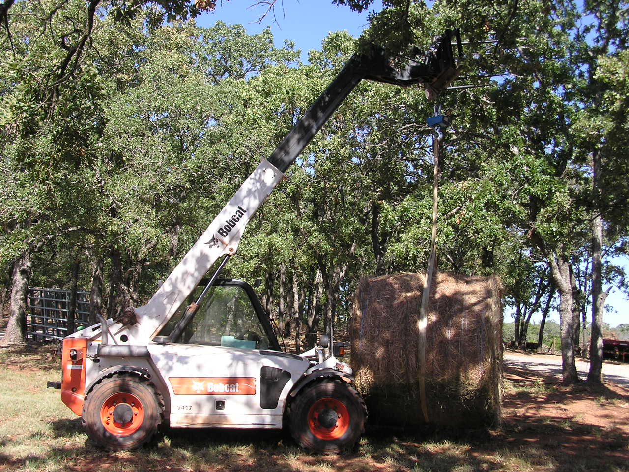

You can weigh round bales with it:

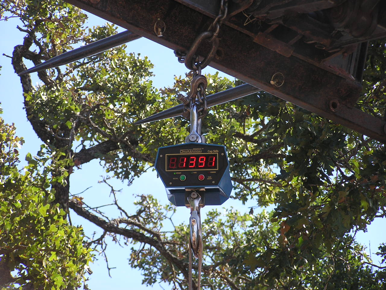

Xfaxman,
If you lower the boom to horizontal and run the boom all the way to its extent, What is the length from the front of the machine ( not the boom pivot point ) to the end of the boom without any attachment on it?
It is 16" from the front of the tire, to the front of the SSQA plate.
The inner boom slides out 66", so it would be 82" to the front of the SSQA plate from the front of the tires.
What weight can it lift if you have 12 feet extended out in front of machine?
12 feet would be 62" added on the SSQA plate.
This is what I have pictures of:
Without the bucket and the boom fully extended, at 15 degrees, it took 3943 lbs to raise the back wheels off the ground.
If you need to know exactly I can put the stump bucket on and measure it at 12 feet
View attachment 754091 View attachment 754092
Thanks. I was curious about its specs at full extension since I am trying to get better handle on what the M59 can do and you have a load cell and a good understanding of what your machine can do.
I have a Kubota supplied graph of lift capacity but it is couched with a SAE J31 spec that kinda of muddies the water about what its true capacity is at full extension at at multiple angles both left and right swift and at elevations below and above horizontal. I also don't know what its lift capability is when boom and dipper are closer to the machine.
I am buying a load cell based upon seeing your in use. Very helpful in solving my above quest for info. Thanks.
Appreciate the info.
