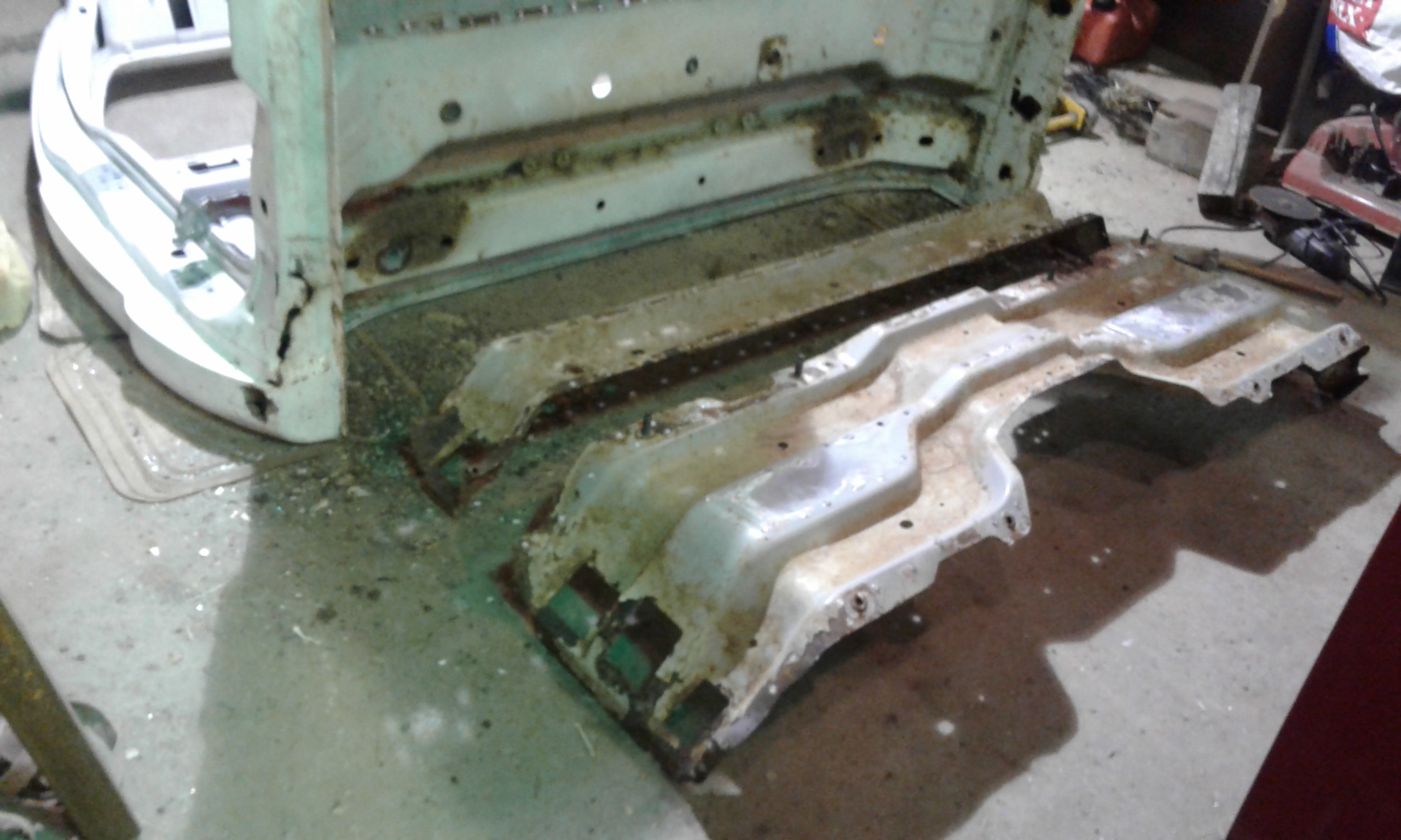

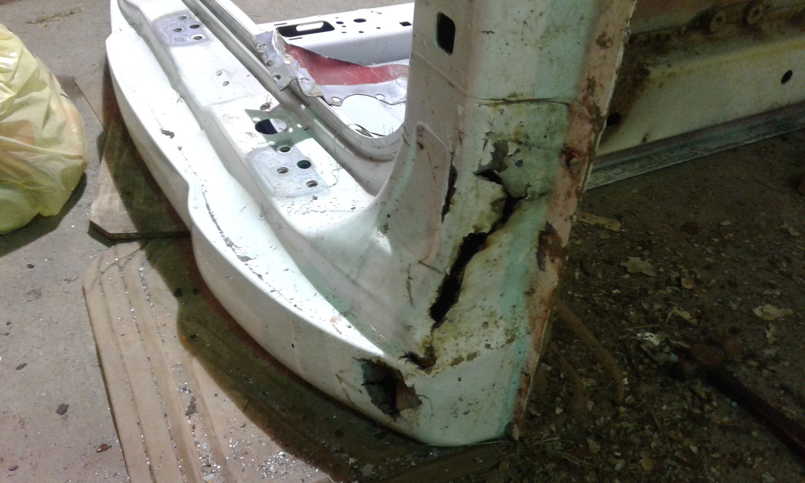

Spent about 2 hours drilling spot welds... about 200 of them... got the front seat support and the rear foot well area support off the extended cab section. The seat support was removed to allow easier access to cut the floor where I need it, and once I saw the amount of rust damage to the inner rockers and rear foot well floor support, I took it out too. I'm hoping to repair the inner rockers without removing the outter rocker, where the bottom rear door latch mounts. More details on this in the future, as the repairs take place.

One heck of a lot of tedious work. Keep it going Diesel. I know you don't need encouragement especially with a precious little one egging you on!
   / Extended Crew Cab- The SuperDuperDuty family hauler #100
Those eyes and curles...lol. Cute. That rust, yuck.
