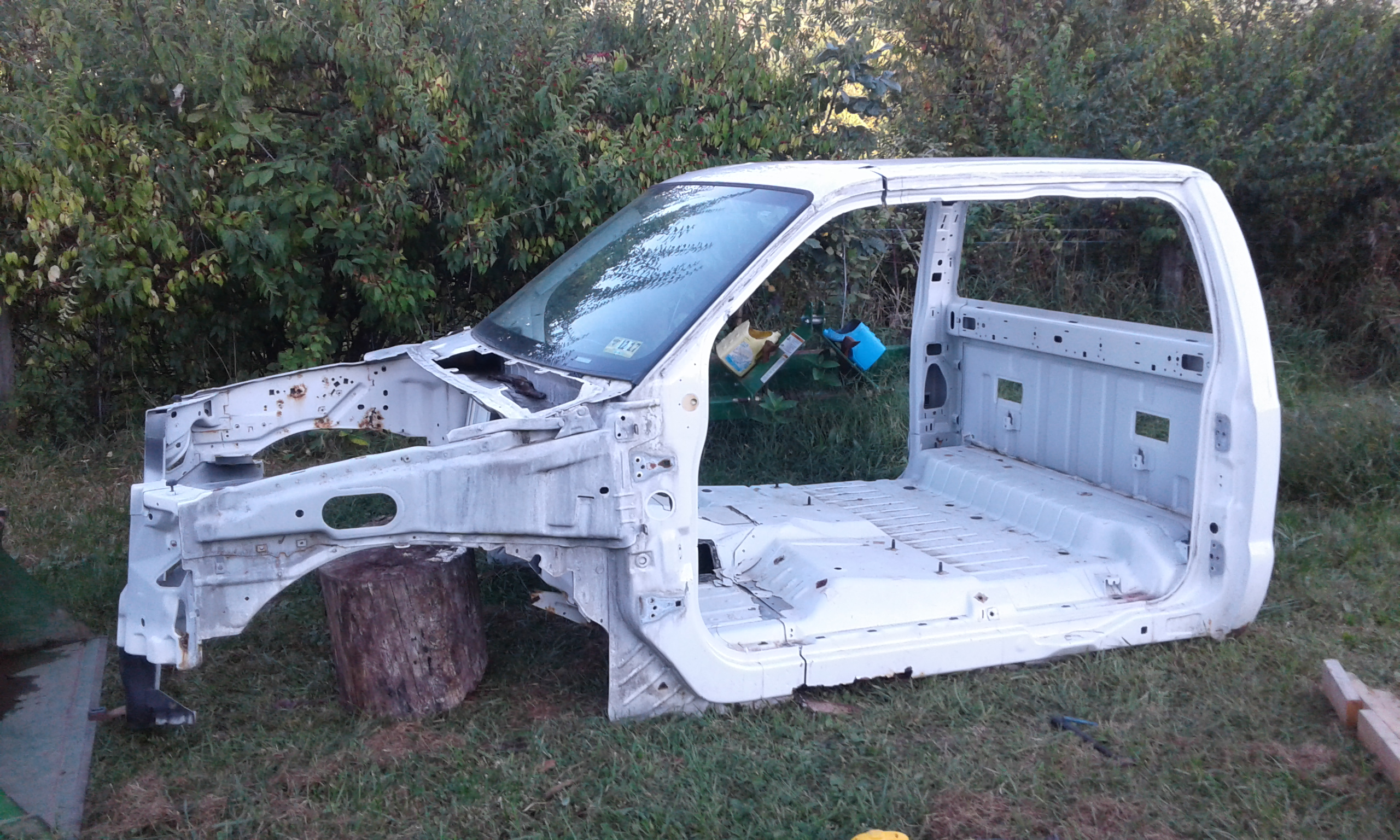

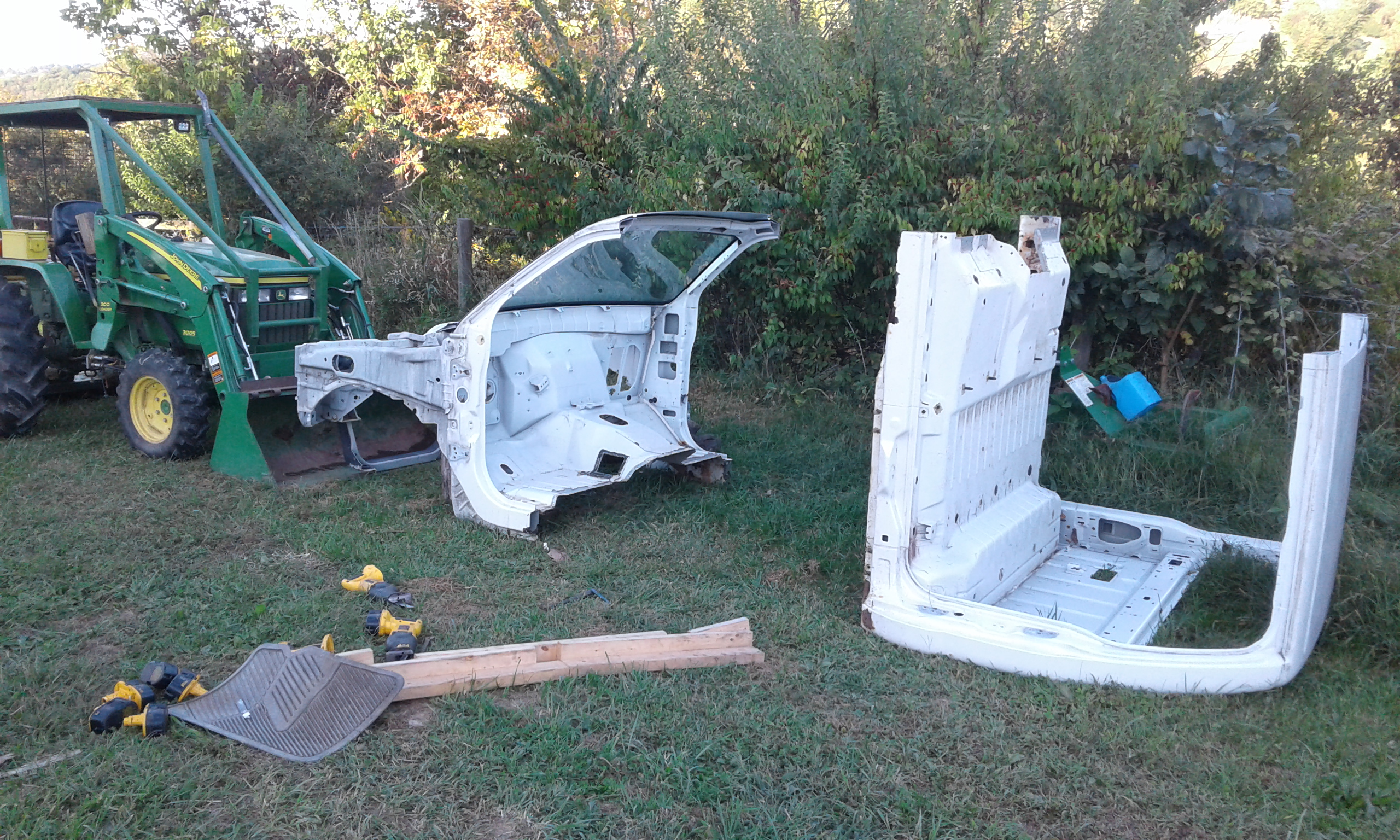

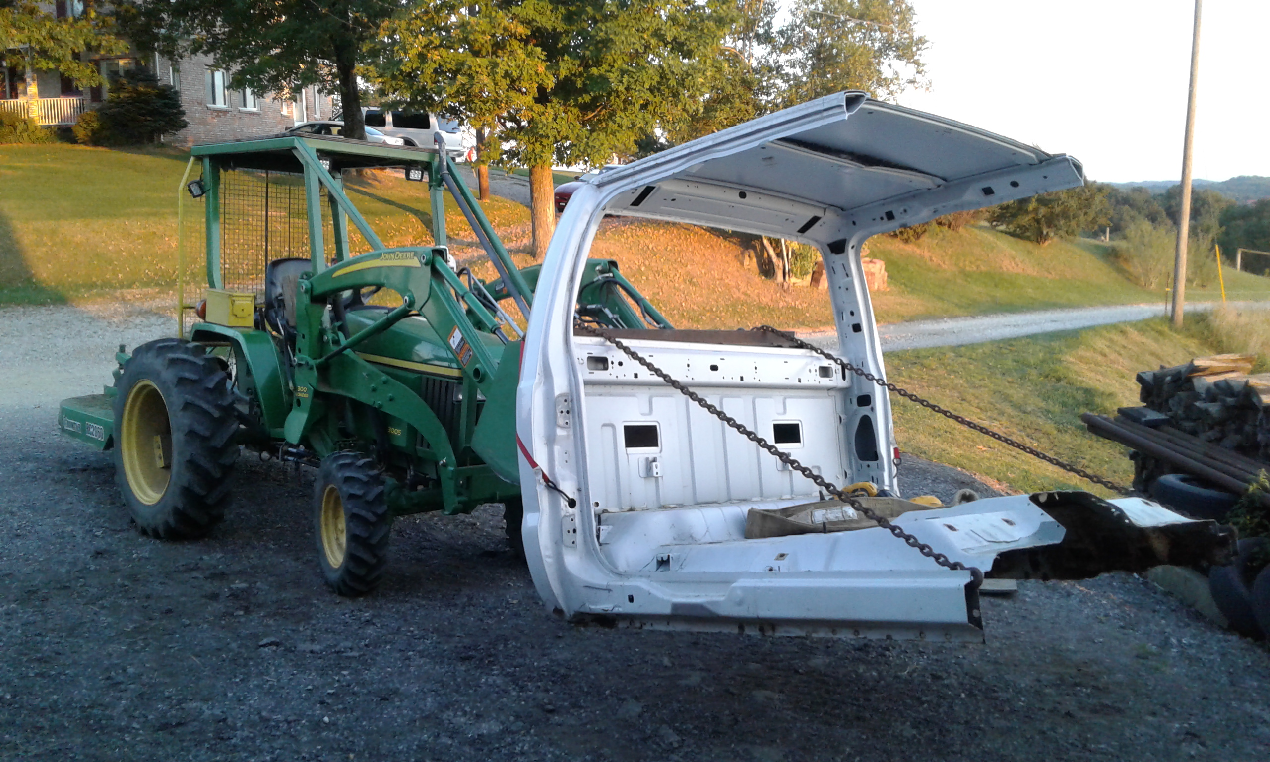

Got to the back field today with a cordless drill, sawzall, and as many batteries as I could find... And chopped the donor extended cab into two pieces. Went surprisingly easy, separating it at the seam in the front floor foot well. I cut thru the inner and outer rocker panels in line with that, and cut the roof just behind the windshield.
Hauled it up to the barn with the tractor, and wiggled it into the increasingly crowded barn. Did some measuring off the crew cab, and my other extended cab, to establish a base line for measurements to figure out exactly where it will get cut.
Because I have cut the floor, rocker panels, and roof much longer than needed, it will be trimmed back to fit. I started that by removing the outter rocker panels. To do so, I rolled the cab section onto its back wall, making it easier to work on, as well as give me a chance to get a good look at the amount of rust damage that will need dealt with... more than I had hoped, but since I only have $100 in the white cab anyway, I'm not gonna complain... too much.

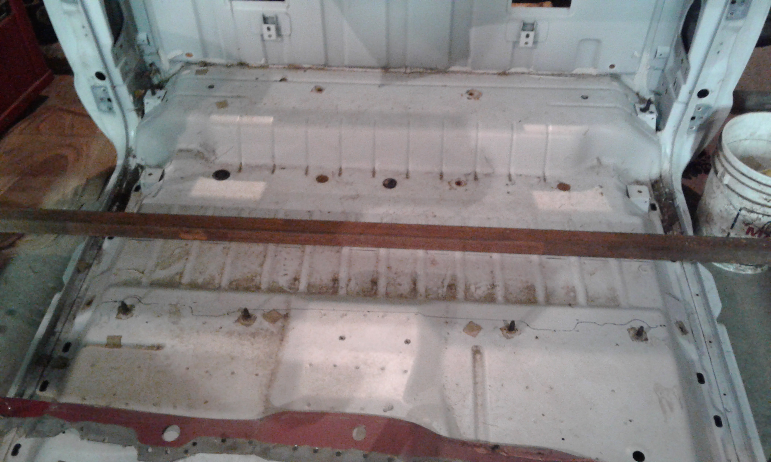

One minor issue I've discovered while taking my measurements is the crew cab rear seat mounting points are 1.5" closer to what will be the rear extended cab seat than the extended cab front seats. Which will make the already small rear seat area even smaller, unless I do extensive floor pan modifications, including moving the whole section of floor pan forward to match. Which would then mess up the fitment of the carpet. I'll likely just live with the smaller back seat area, my kids are little people anyway... *grin*

Greg - With only 2, I don't have nearly as many kids as you so I'm not quite the expert that you are. But, if memory serves me correctly - although my children did start out as "little people", they did grow! :laughing: My baby girl is now 24 and stands at 5'11.5" (and about 125 pounds!).
Seriously though, 4" is a lot of legroom to be losing. Are you sure there's not a fairly easy way to keep it?
GREAT progress on this. Guys like you amaze me!!
