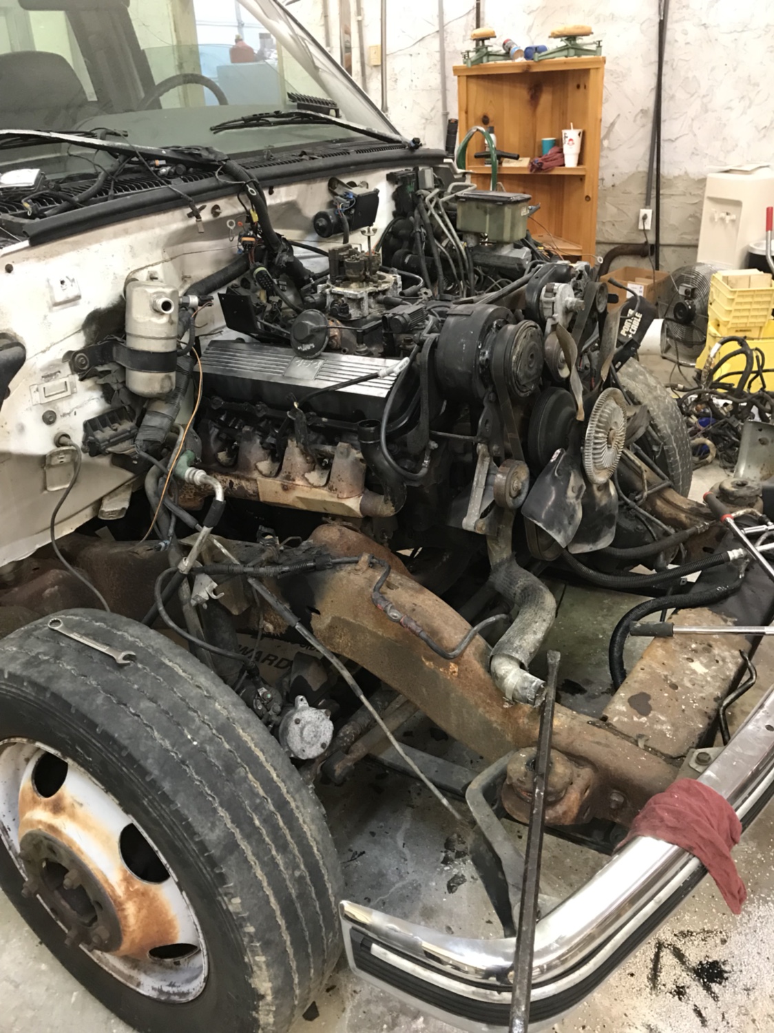

I got the motor on the shaft and it’s got 4 bell housing bolts in and the motor mounts are in. It still needs the fuel system changed and the electric plugs worked out. After that this project will be well underway. IMG_0757.JPG

Got the trans pulled today. Drained the pan, fluid was black as diesel motor oil. Got replacement trans up into place, and a few bellhousing bolts and crossmember back in place, good enough for now. Miserable day, windy and cold, scattered rain showers... and Im doing this with about half the truck under a lean-to roof off the barn, on pea gravel that the barn cats think is a great litterbox... couple layers of cardboard, and a sheet of plywood helped the gravel issue.
I'll work on the rest of the bellhousing bolts and other items still loose as time permits, but likely to be the weekend before I can get back to it.

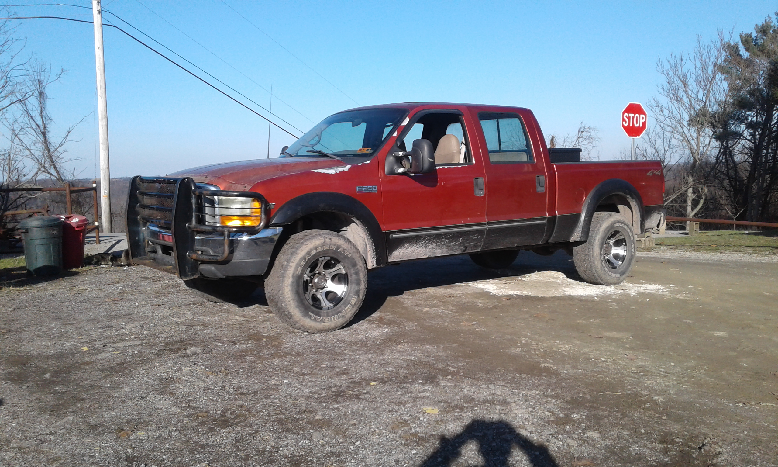

On the gas motor crew cab, I've got the trans swapped out, windshield in, state safety inspection done, bigger tires, fender flares, brush guard, all squared away. Seems to be running ok, might need to change the thermostat, as it never gets warmed up good, heater not hot enough.
Plan to drive it to work tomorrow, wife bought me a new tool box for work (Christmas present) and its too big to wrap and drag into the house... its going straight to the plant!
Now to start stripping the diesel extended cab... back doors needed first, plan to remove entire interior since it will be exposed to the elements once the doors come off.

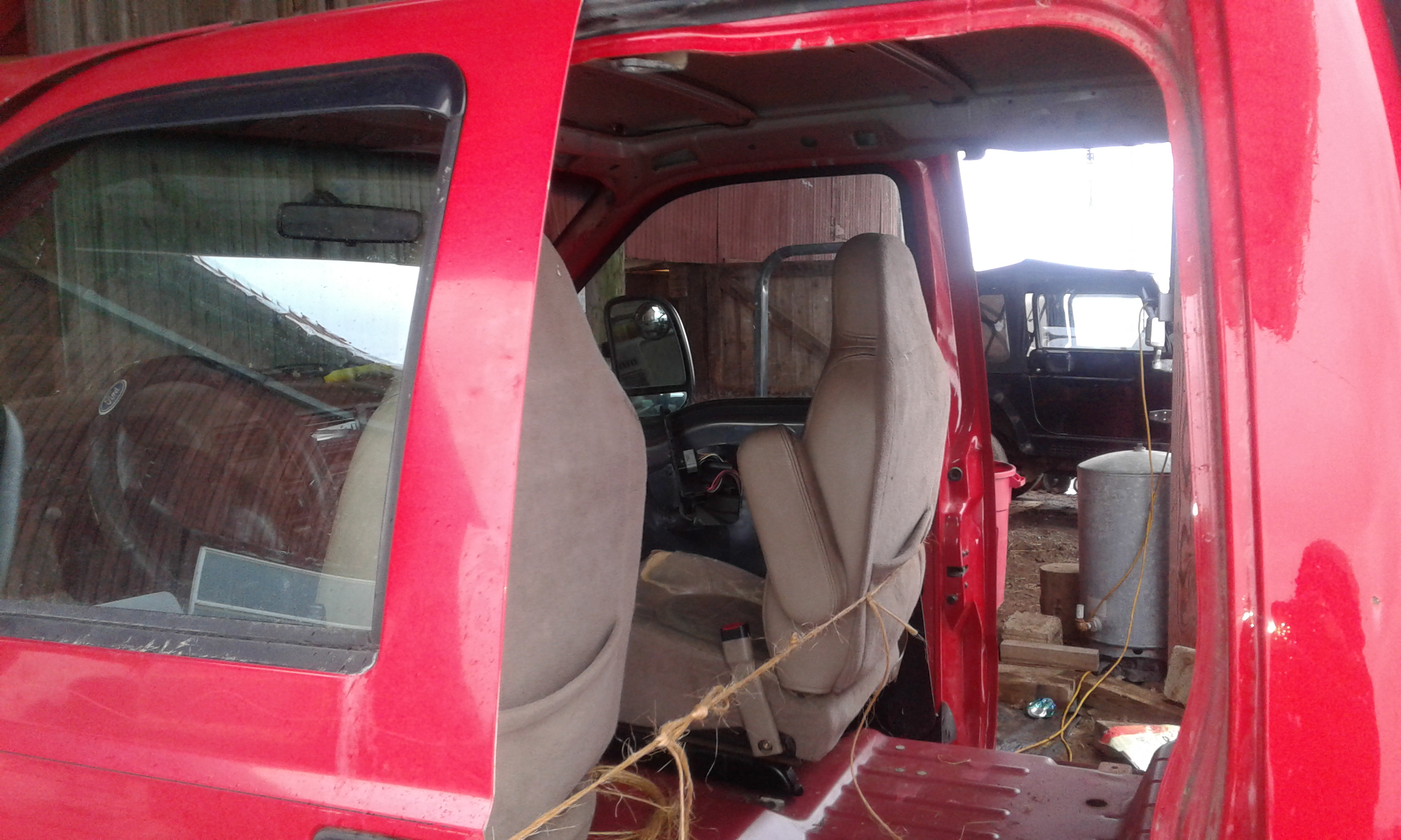

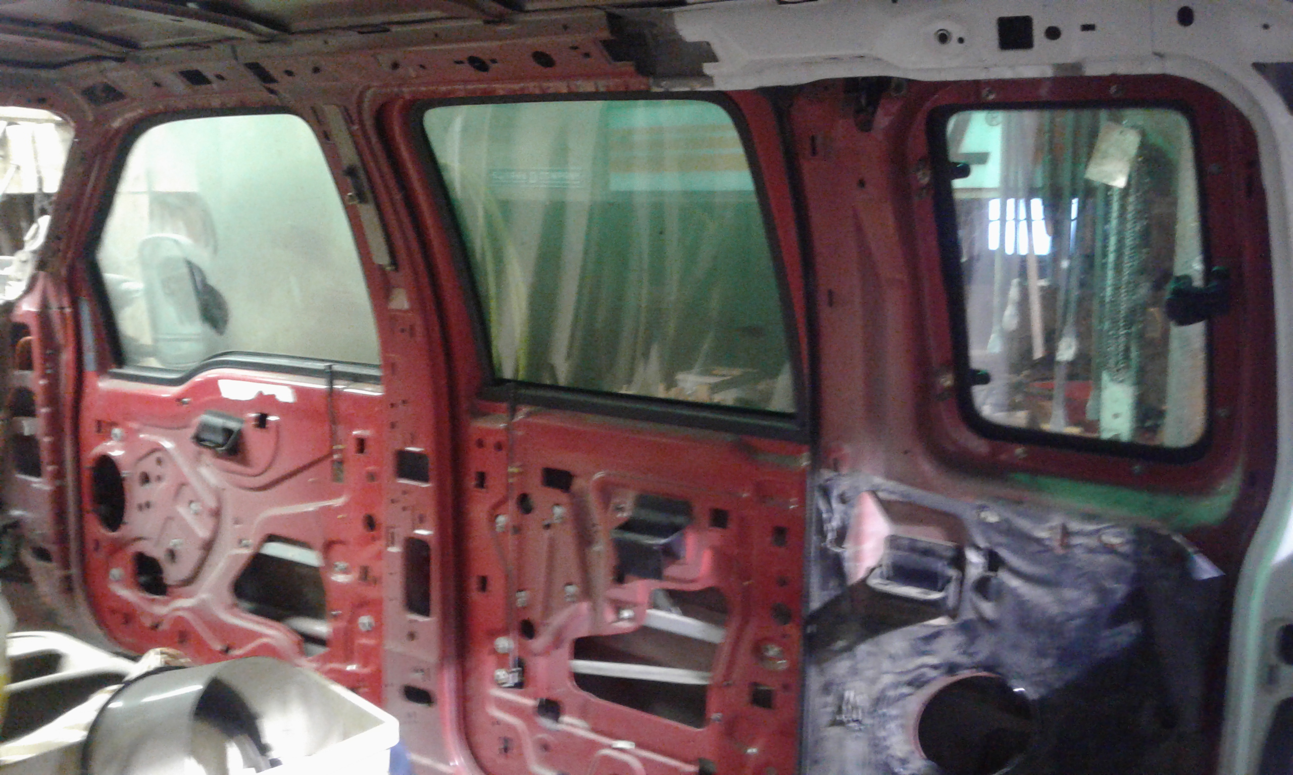

Finally got the interior out of the donor extended cab, and the rear doors off... hardware and trim bagged and tagged, and stored until needed. Couple hours last night and a few more today, but it sure feels like progress! Tossed some old seats back in it, not even bolted down, so I can still move it around the driveway.

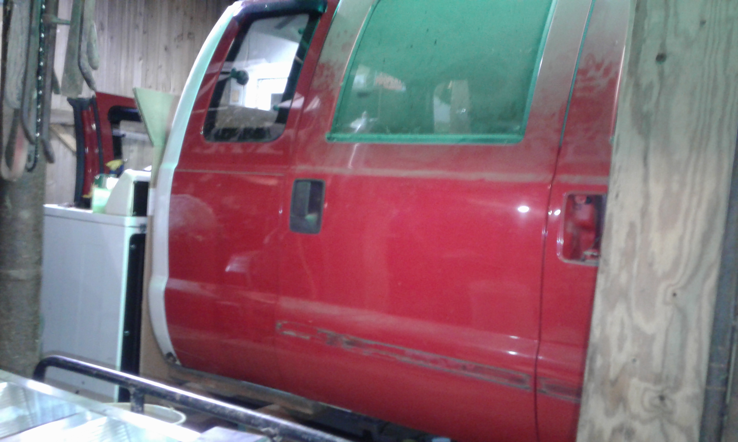

I went back out to the barn a bit this evening, and stuck the back doors in place. Its obvious how mis-aligned the rear cab section is in relationship to the front, the door latches dont line up... yet.
Next, I need to clear a year's worth of accumulated junk that has gotten piled on and around the cab, and correct the alignment issue.

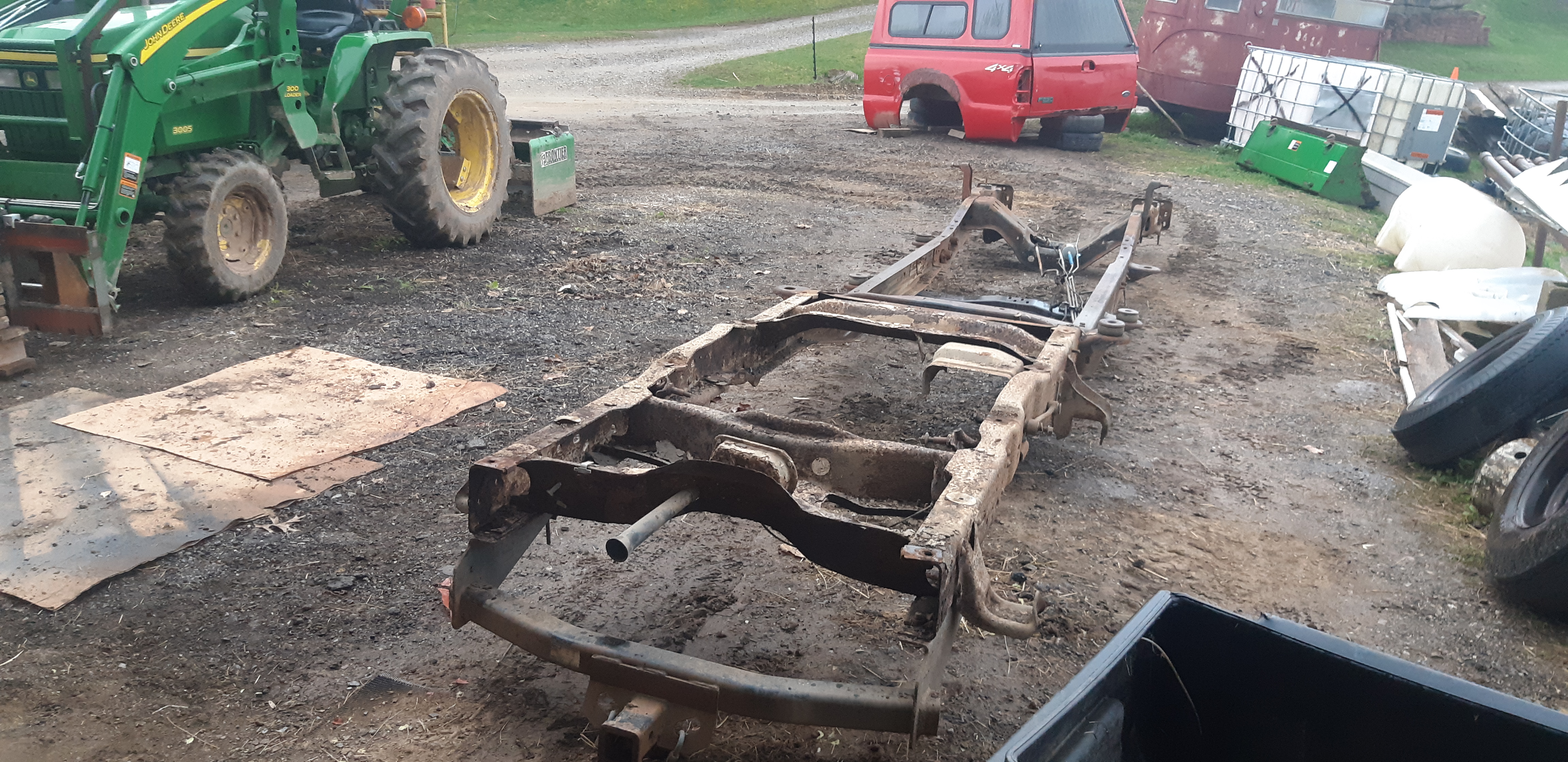

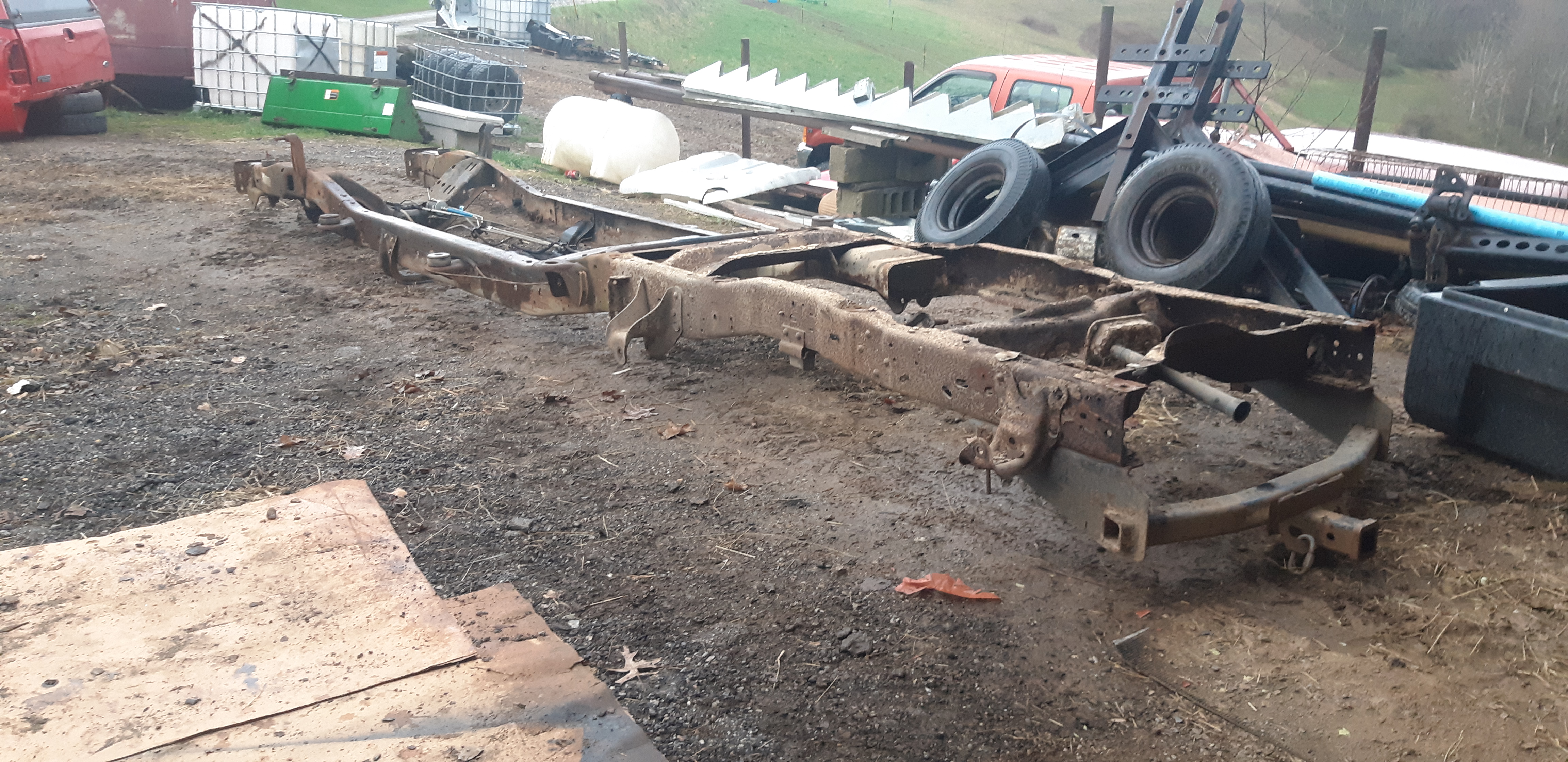

Another year or more has past... little to no progress... until this past weekend, I got the frame that's donating the rear section to this project stripped of the bed. It's been sitting by the barn since I removed the rear springs for the gas motor truck. Got the junk cleaned off it, the bed off, and its nearly as bare as it can get. It's nice to have the space by the barn cleaned up again... wife is a little happier about that part...
