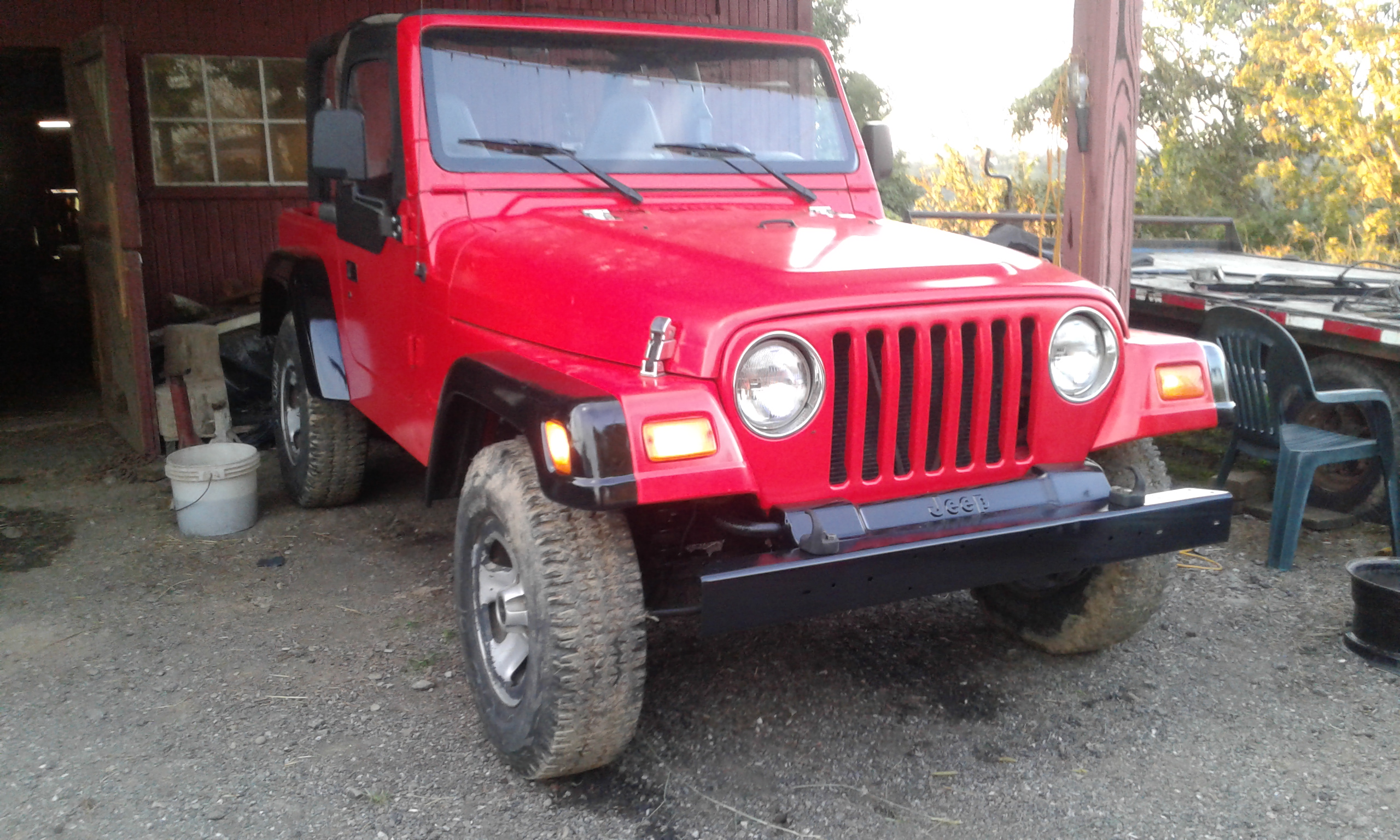

Spent 2 months of any and all free time getting my oldest boys '97 Jeep Wrangler road-ready... fixed body mounts, straightened a bent frame, rattle can paint job, and he's been driving it daily for over a month now.
But the truck? Nothing. Donor truck is waiting to get the rear doors pulled off... gotta get the other gasser crew cab truck road-ready and legal first, been truck-less with 3 in the driveway for 2-1/2 months, driving the ol' '96 Probe GT to work. But soon... somethings gotta happen.
