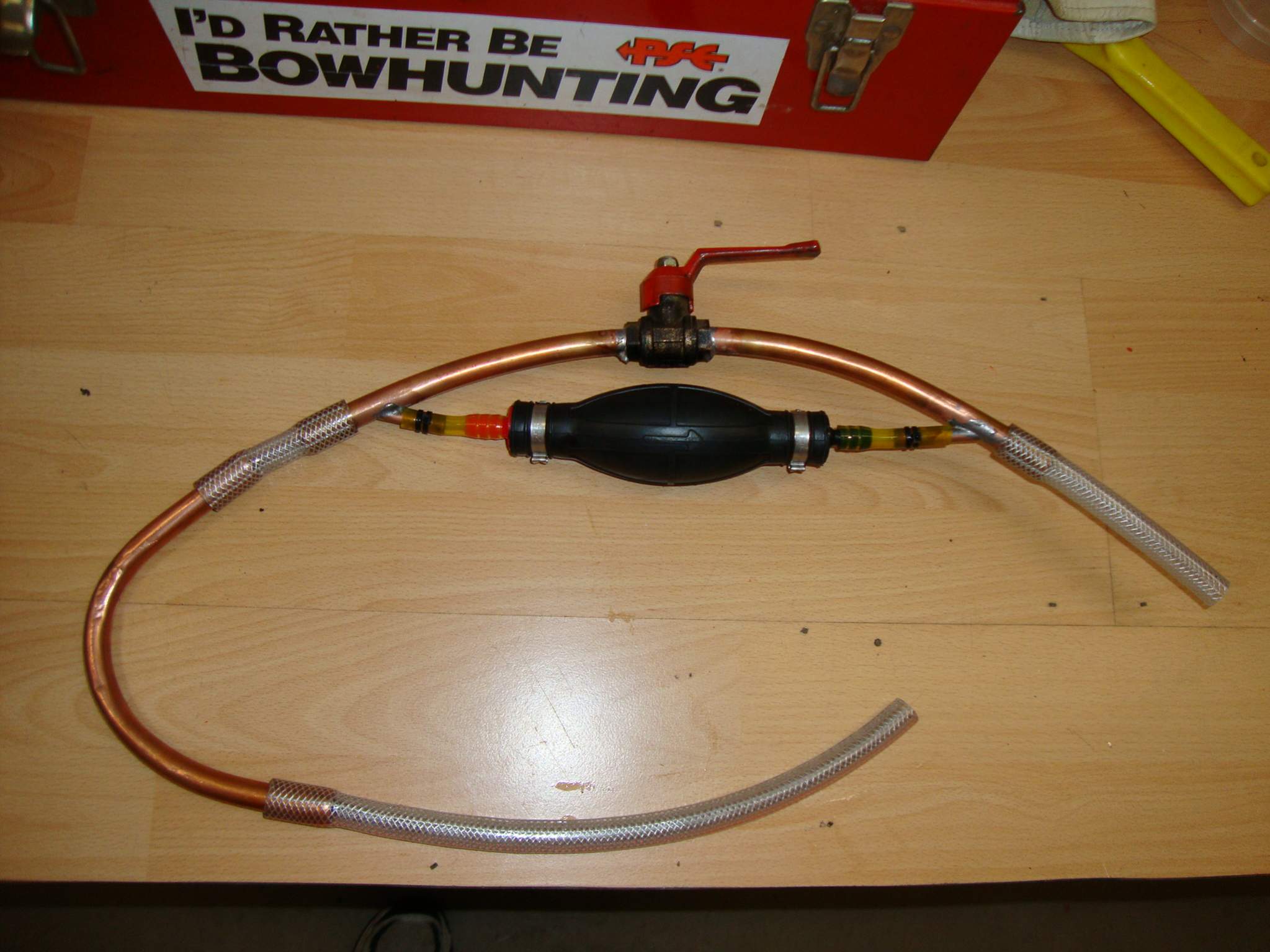

This is what I use. Once the fuel can is above the tank (it does have to be up there with this setup) you stick the long end of the siphon into the can, put the end with the primer bulb into the tank opening, close the valve and squeeze the primer until you get fuel flow, then open the valve.
If you want to stop the flow mid-fill, close the valve.
The 3400 has the filler on top of the hood, awkward to get positioned securely enough to pour a full 5 gallon can of diesel. This empties the same can in about 3 minutes.

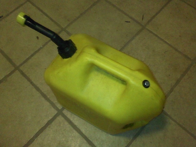

My solution to the glug-glug. Get a grommet with a 1/4 hole in the middle, drill a hole in the can to fit the grommet and stick a 1/4" bolt in the grommet to plug the hole. Pull the bolt when you fill up and diesel gushes out both holes in the spout.. the one designed for the fuel to come out and the one designed to let air in. Empties a 5 gallon can like they used to before the epa got hold of them, maybe even better cause the old cans didn't have an air vent that big. Cell phone pic.. sorry.

Very clever Chilly......and I still like the PSE sticker too..:laughing:
