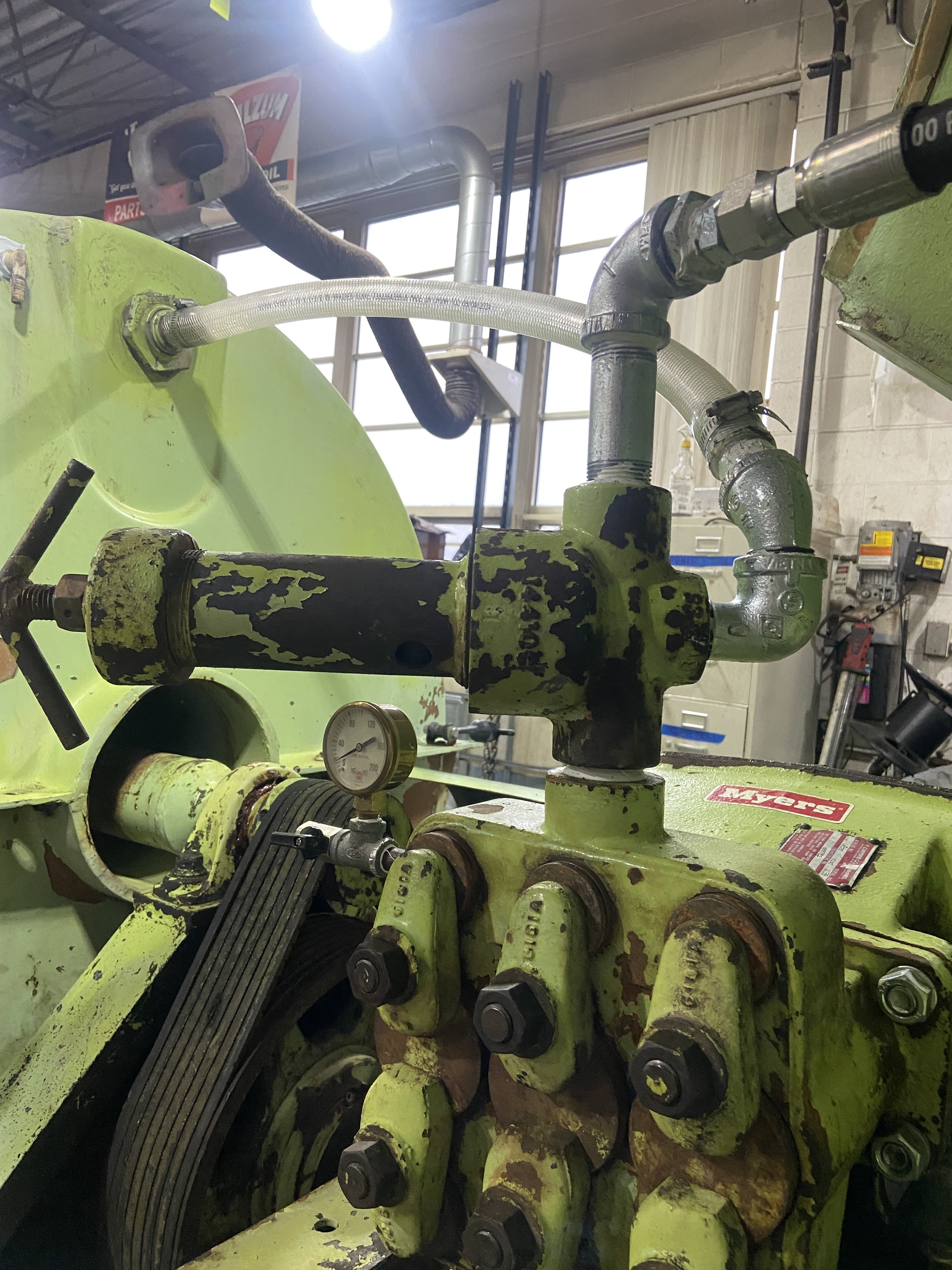

In the last couple of days I have handled a number of issues.

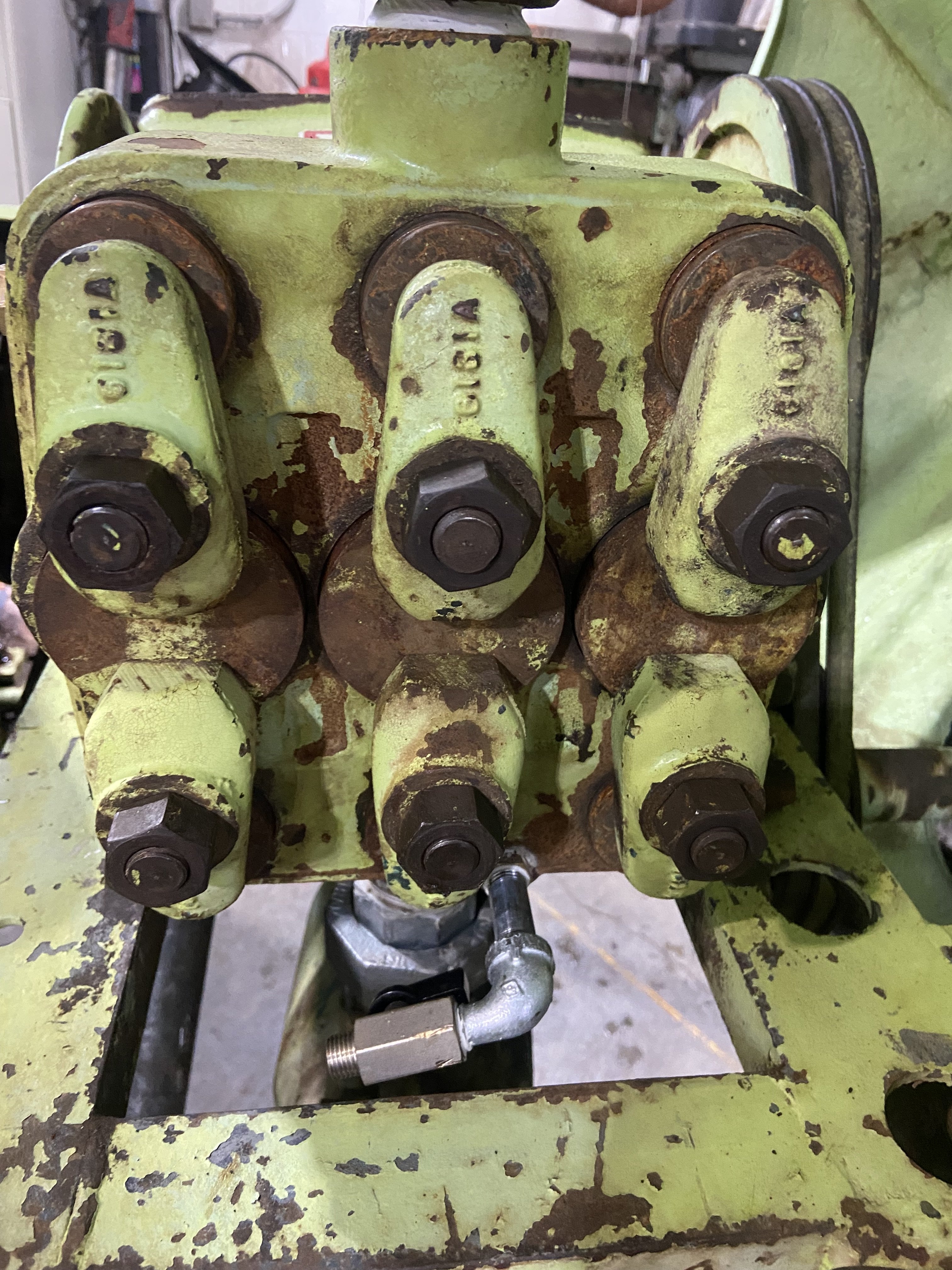

1) Pump 'resealed' with new o-rings and cups.
2) All 1-1/2 intake pipe replaced with new galvanized pipe as well as the intake hose from tank to pre-filter.
3) New 3/4" solenoid valves. (I know motor valves were recommended, but for the price point and the luck I have had in the past with the same units, I will give these a try until I can upgrade to TeeJet.)
4) Disassembled and cleaned the pressure regulator
5) All new bypass plumbing, hose and hose barbs from regulator to tank.

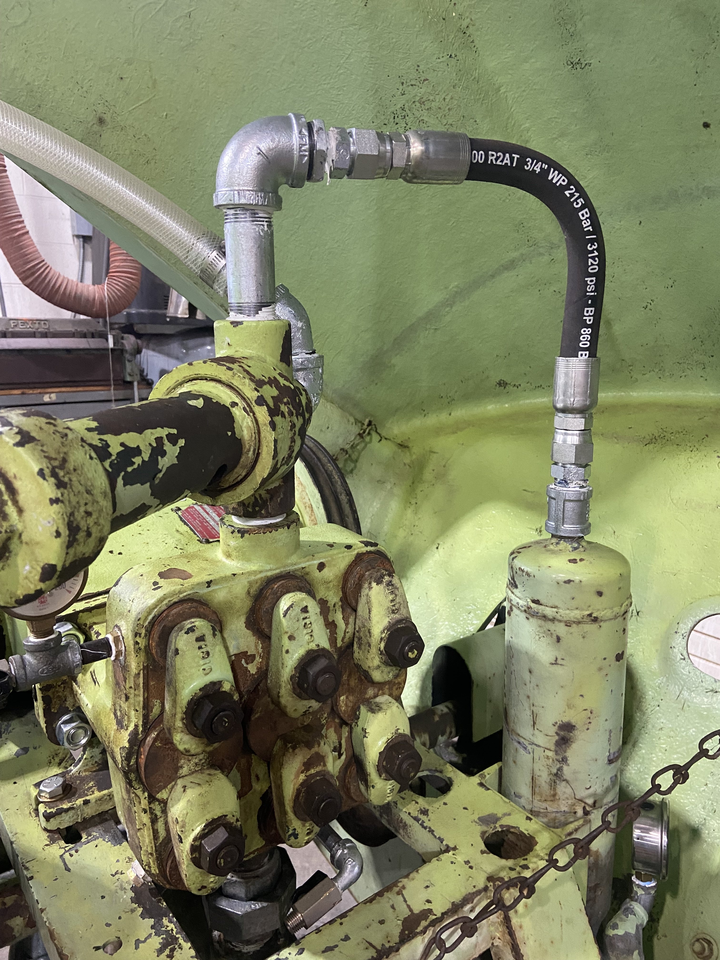

6) New 3/4" JIC fittings and hydraulic rated hose from pressure side of pump to the 3/4" feed lines.
7) Tank was rinsed out for 30 minutes with an older lawn sprinkler which was able to reach all internal sides of the tank. Water ran very clear by the last 10 minutes.

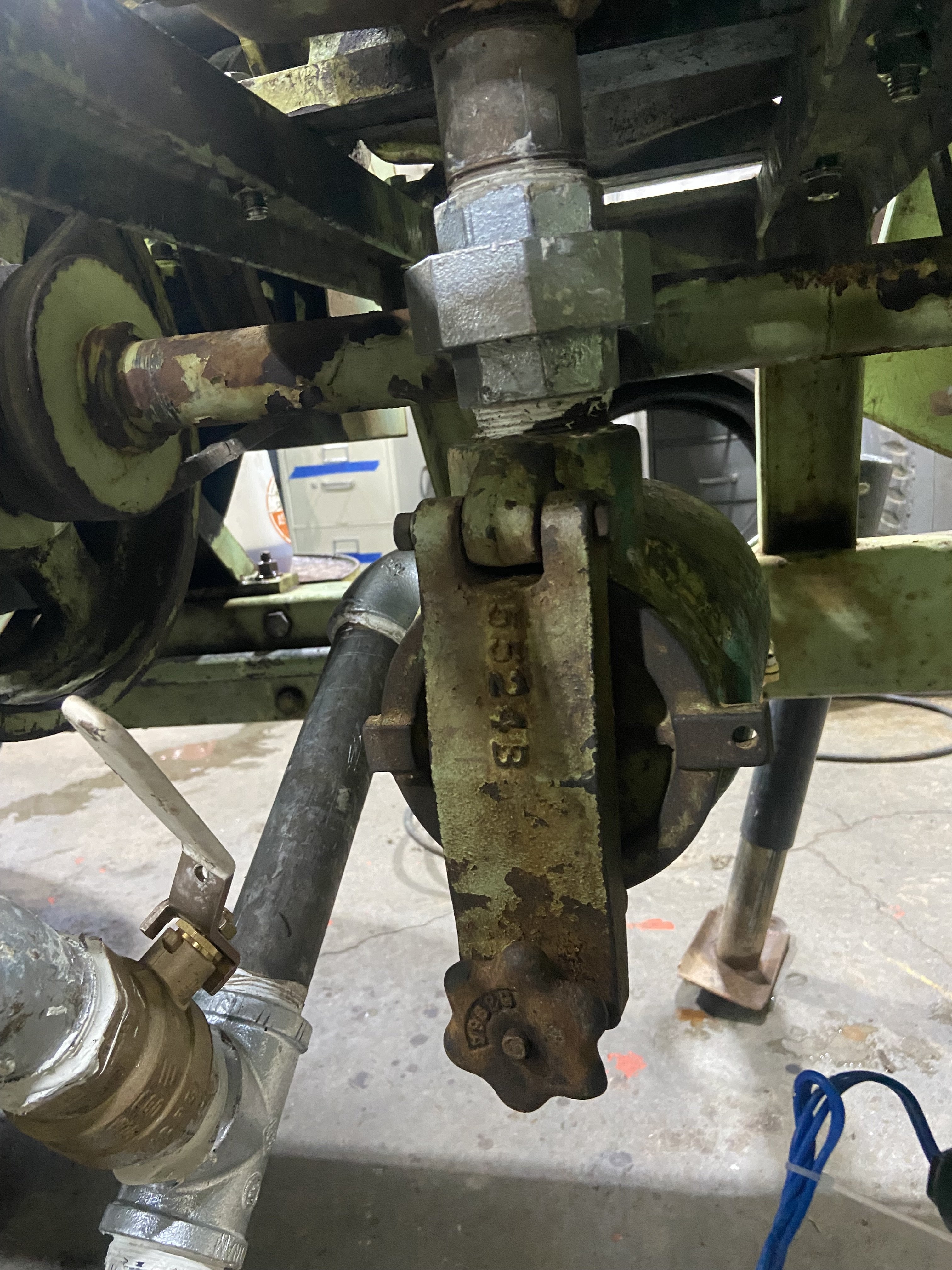

There is also a center drain in the middle of the tank that is a little worn. I am concerned that this is where the tank has been routinely drained and the threads are a little loose. Once I am done with the fiberglass repair, I plan on threading in a 1-1/2" PVC bushing to adapt a 1-1/2" pipe to the back of the tank so I can add a remote ball valve. This will prevent me from having to crawl under and drain by unscrewing a plug and instead simply turning a valve to drain.

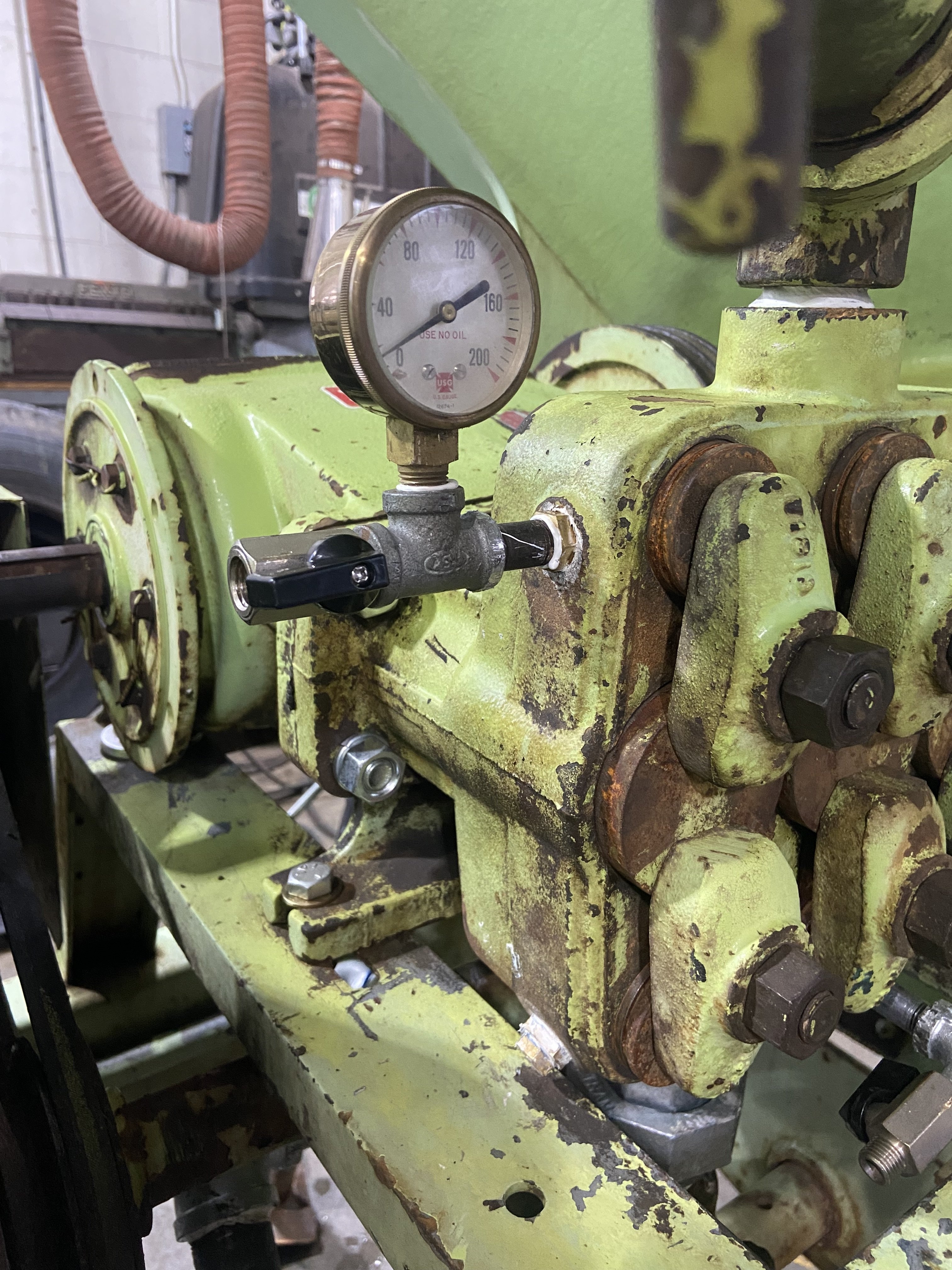

Pump and new pressure gauge

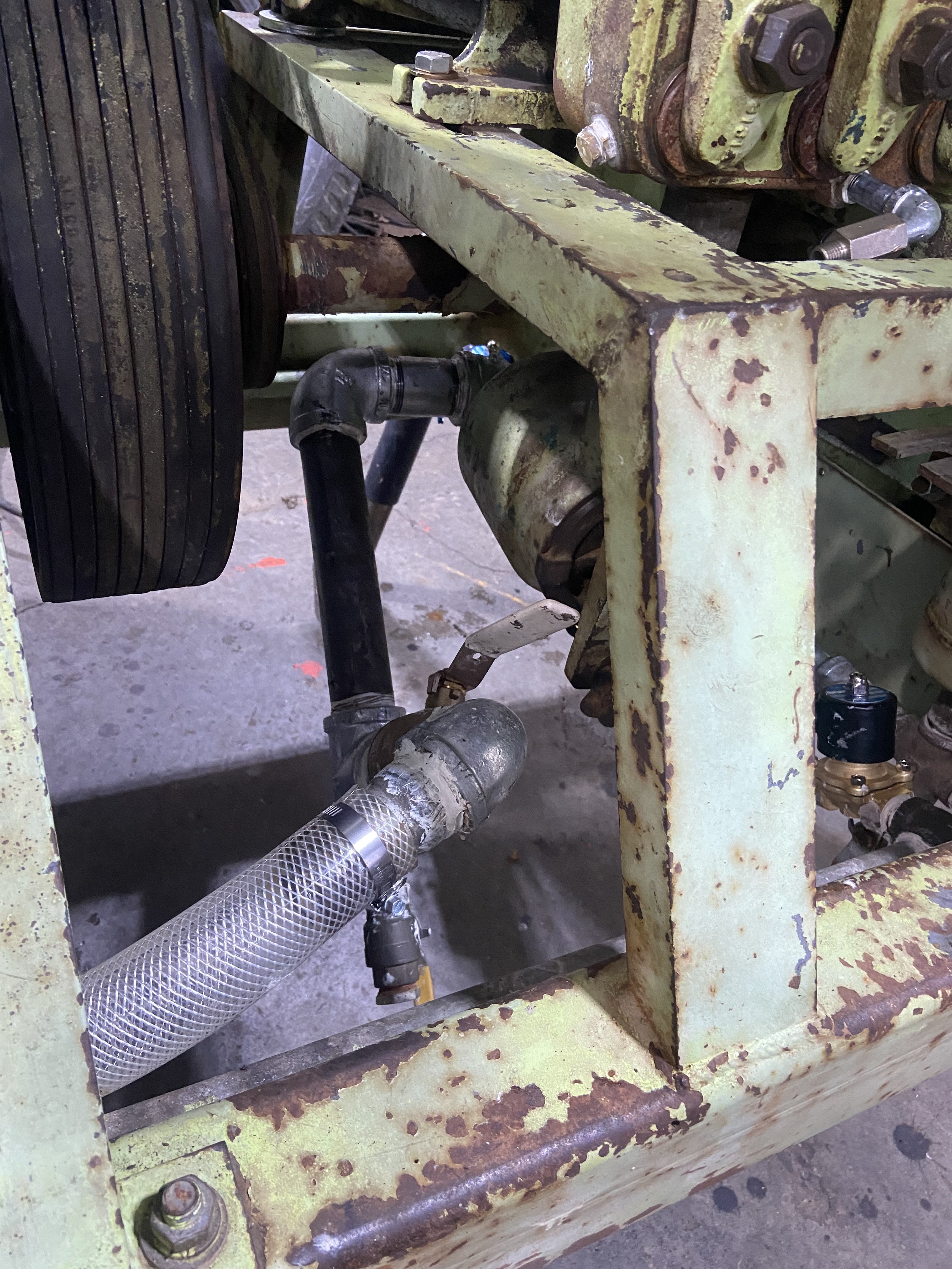

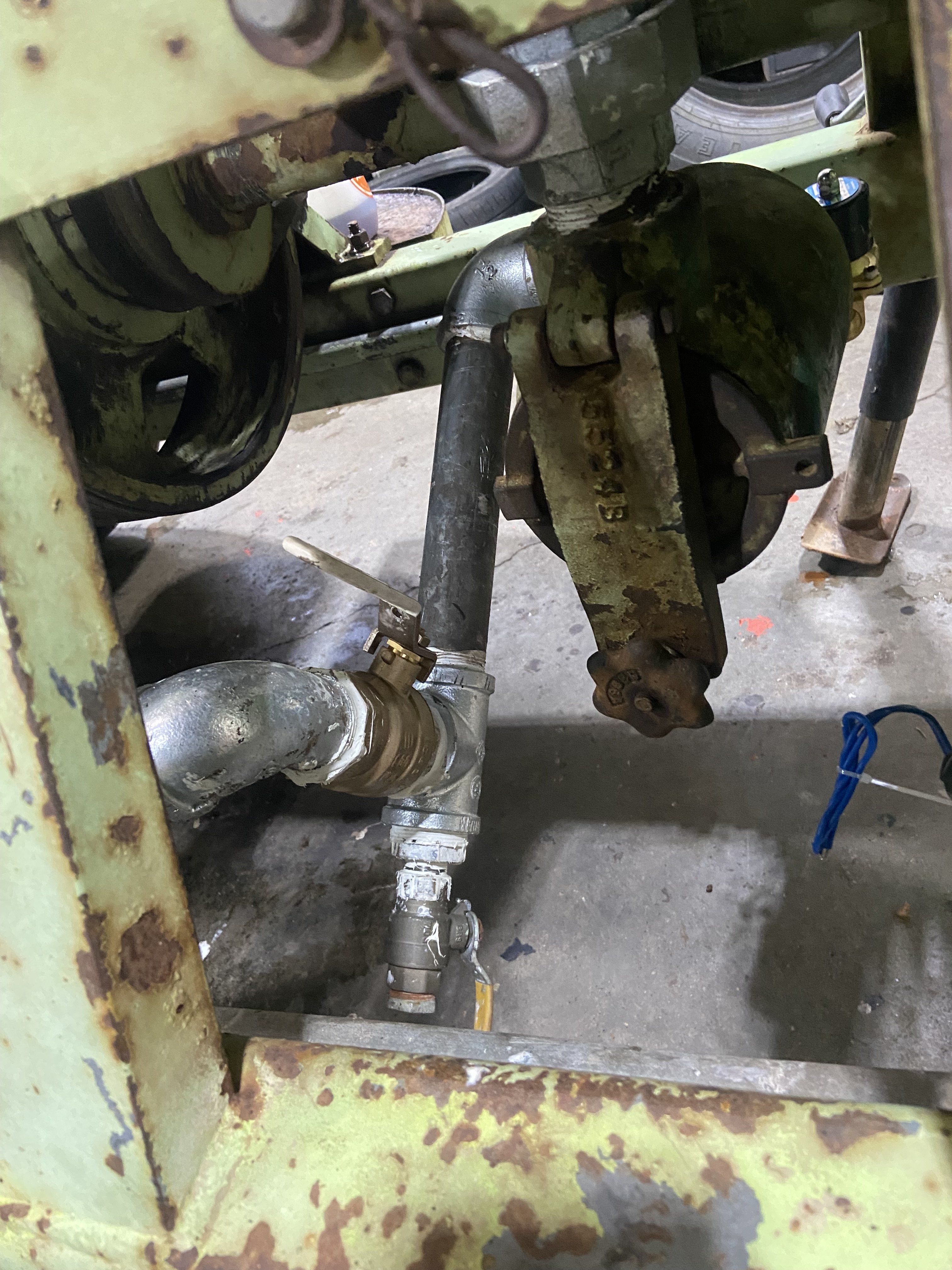

Some new plumbing

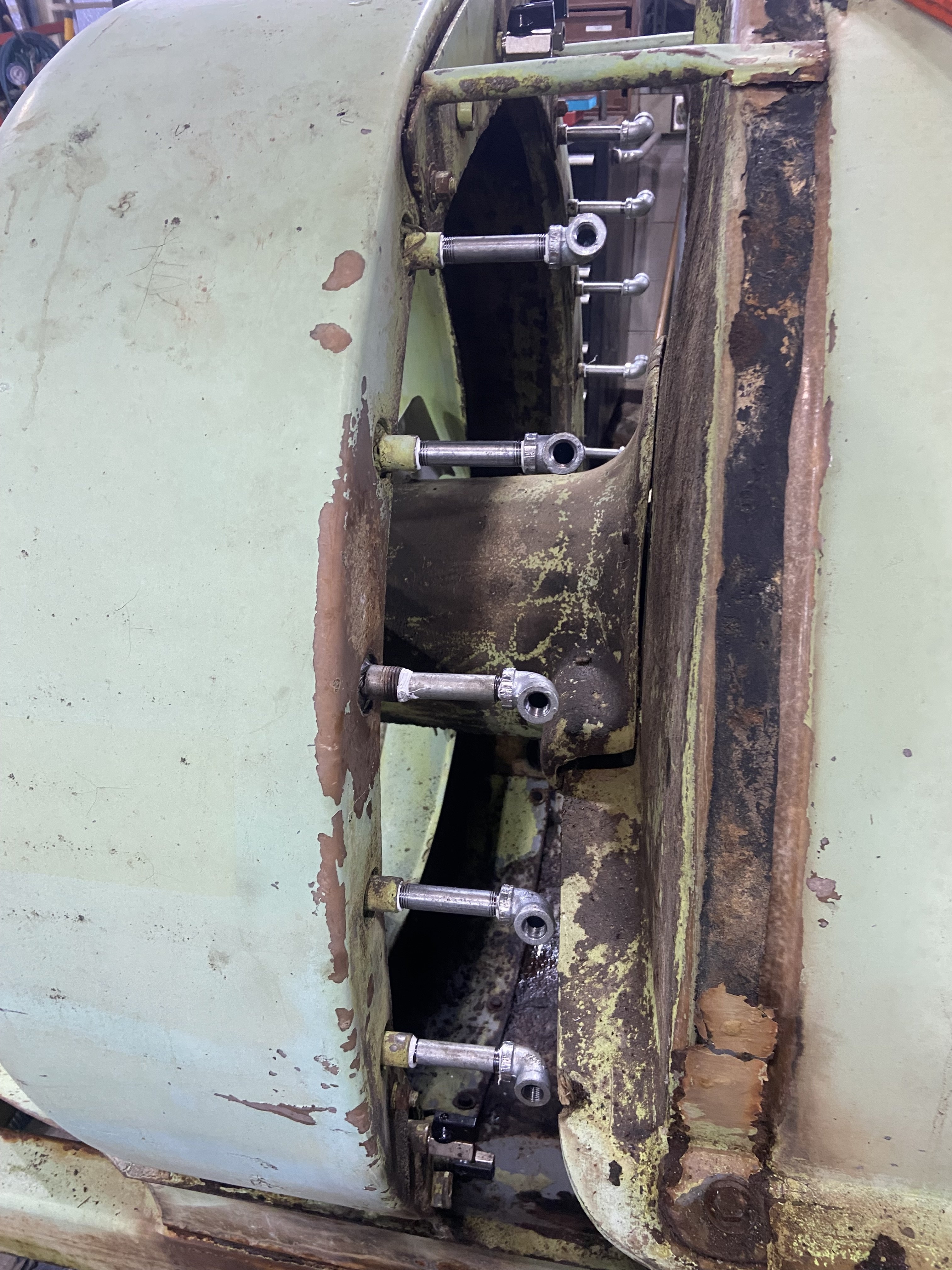

#57
Lower suction side and nozzle ports. I was able to get all but one pipe nipple out. Someone capped the outside of a nozzle port with a 1/2” pipe cap roughly threaded on. I pulled that off and I couldn’t get a drill bit through. I tried a Dremel and I was able to expose the end of a broken tap. Sweet. Took a little doing, but I was able to work it loose and pull it out. I retapped that port and installed a new pipe nipple.

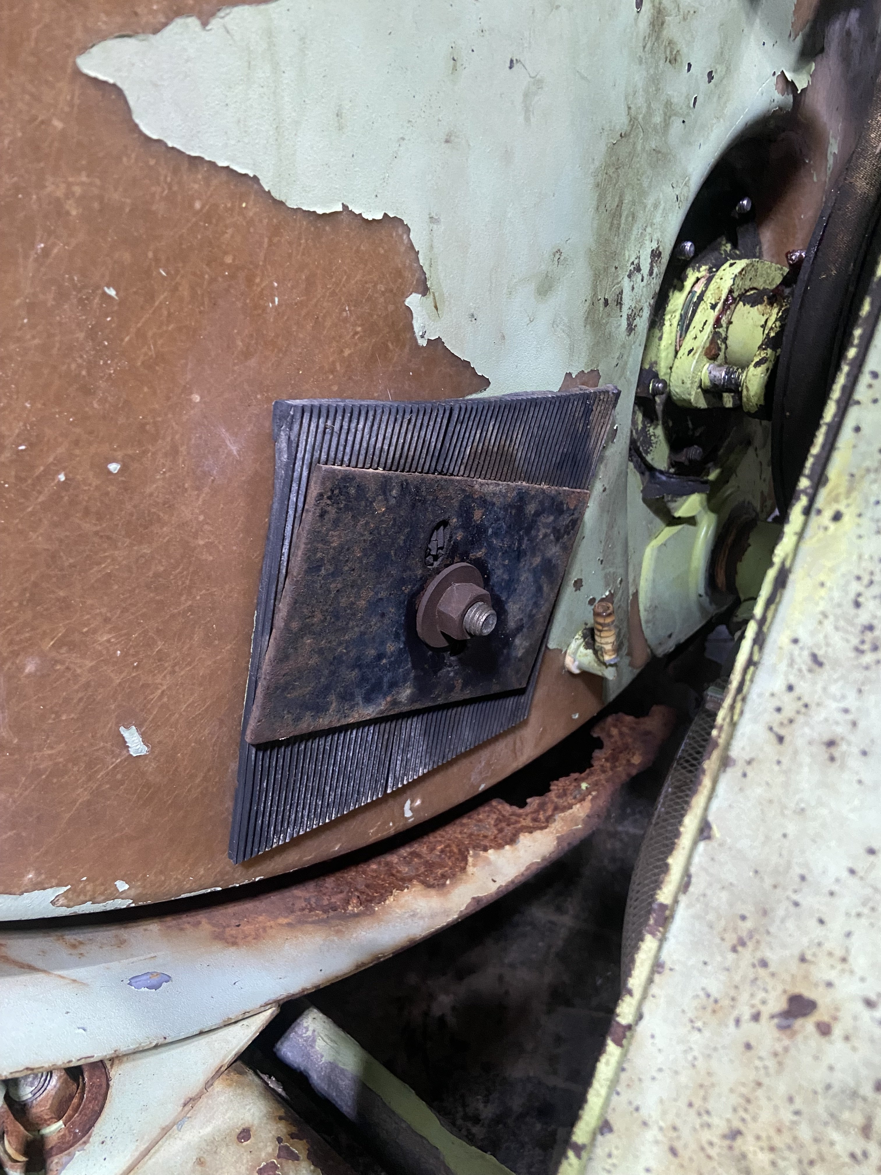

Here is the patch. Not sure how well it holds. I might just leave it alone if it doesn’t leak. Otherwise I’m going to have to do some fiberglass work
