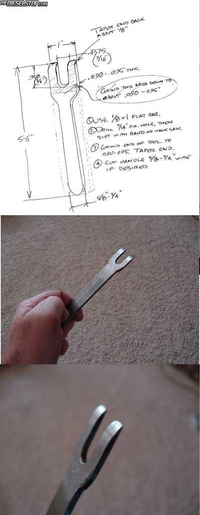

Back stepping a little...
Made a quick HPOP line tool out of an old weedeater nylon finger to release the quick connect fittings. Based on this, it worked poorly, but worked, took about 5 minutes to make, and cost me nothing.
My tool
Tonight, I only had a few minutes to spare, but pulled out the '03 HPOP. You can see the heli-coil, and buggered threads...
Good fitting vs bad
