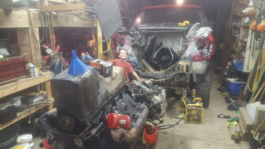

Made more progress today...
A/C condenser tied up without disconnecting the lines and loosing the freon, radiator out, fan and shroud out, intercooler tubes, battery cables, glow plugs feed, all disconnected. Hot as he!! out in the barn today, 95° in the shade... box fan blowing on me the whole time, still dripping with sweat. Sure made a few cold beers taste great!
Wife has to work tonight, so she's napping for a bit while I watch our youngest (2 yo) daughter, who liked the napping idea... on my lap, snoozing. Maybe more tomorrow.

Put in a few more hours today... top side is ready, alternator and power steering pump and bracket off, A/C pump and bracket off, down pipe loose, starter out...
All that's left is bell housing bolts, motor mount bolts, and EGT probe in the left manifold. Might have it out later tonight, after I get back from town...

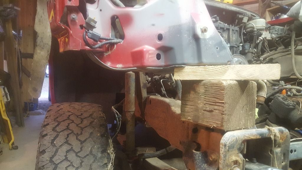

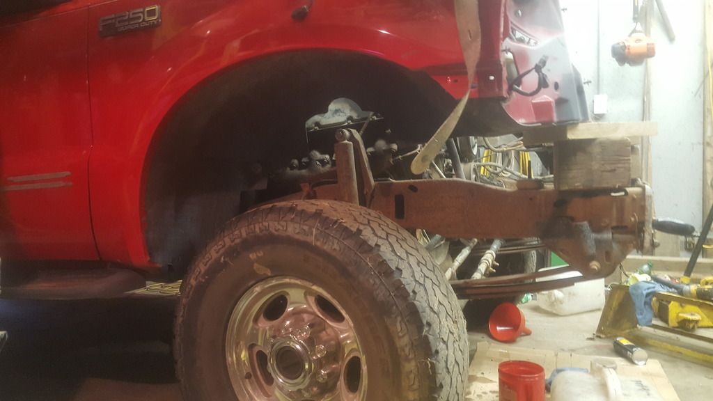

I ended up lifting the front of the cab/core support about 7", made all the difference in the world in access to bell housing bolts and removal of the engine.
And it's out... with the extra room above the motor, there was plenty of room to clear the turbo against the cowling, and motor mounts to the cross member.

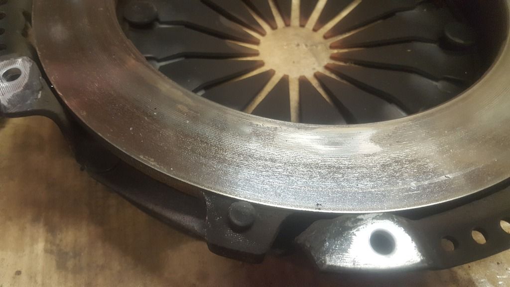

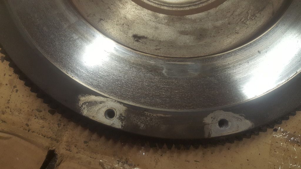

Got the truck out of the barn, and started stripping the old motor. Got the clutch apart... it had been working fine when I last drove the truck, never slipped that I know of, even on the higher HP settings (120hp 'race' tune), and having done some heavy towing (24k GCVR per scale). Minor heat spots on both flywheel and pressure plate.

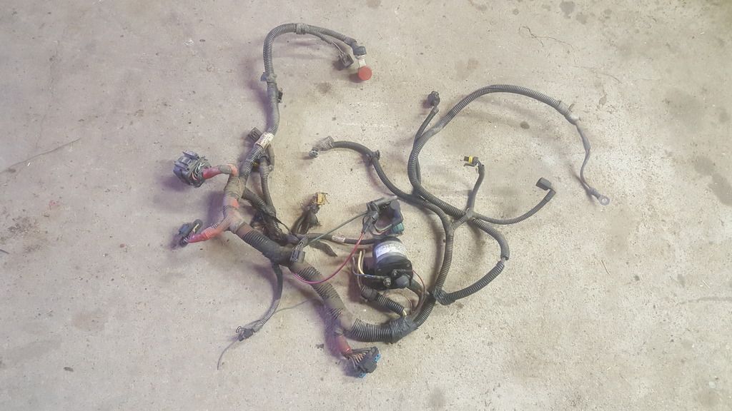

Got the wiring harness, fuel lines, fuel filter bowl, and oil cooler off...
The wiring harness doesn't look like much laying on the floor...

The clutch looks pretty good. How many miles were on it?

Guessing it's the original clutch, so 212k. I didn't think it looked bad either...
