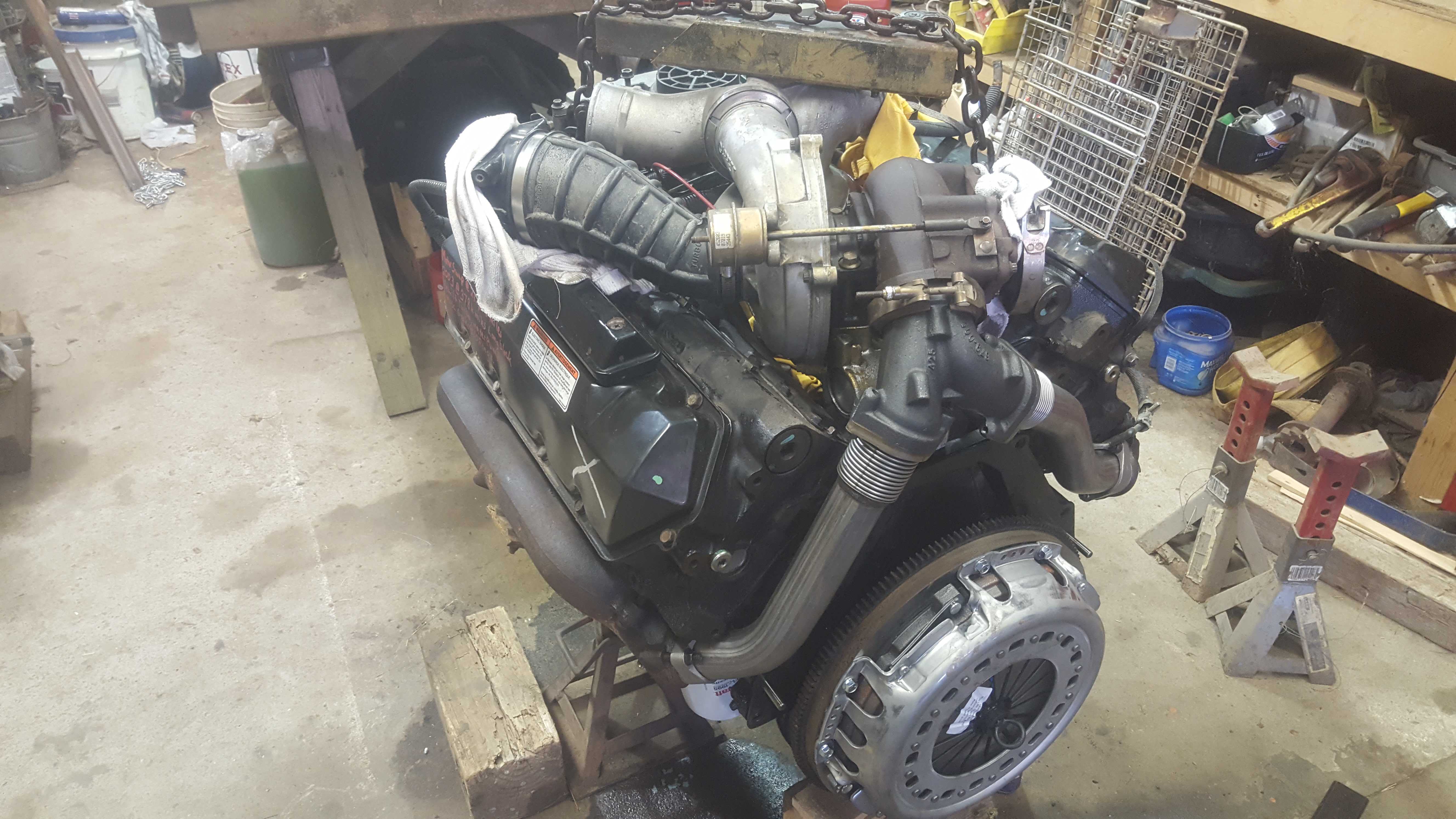

Got the second new water pump on, due to a broken tap in one of the thermostat holes that i thought needed chased. Lucky, parts store buddy swapped it out quick and easy. Thermostat in, new housing I made fit perfect, after a little die grinder work to clear thermostat.
Got the motor off the stand to start clutch assembly. Finally opened the clutch, been sitting on te shelf in the box for a year and a half! Mad at myself, minor surface rust on pressure plate surface that mates to friction disk. It cleaned off easy enough, steel wool and wd40.

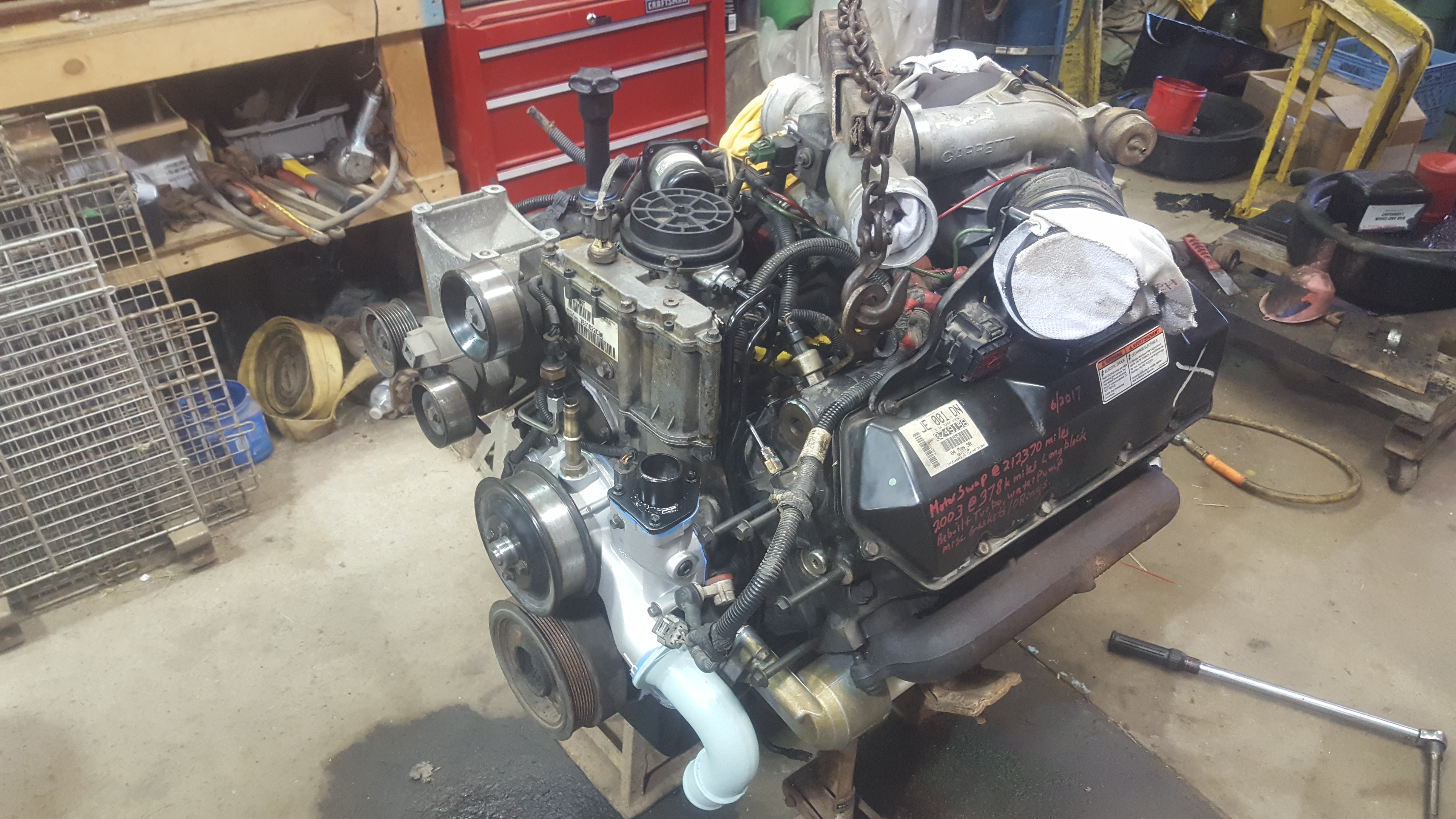

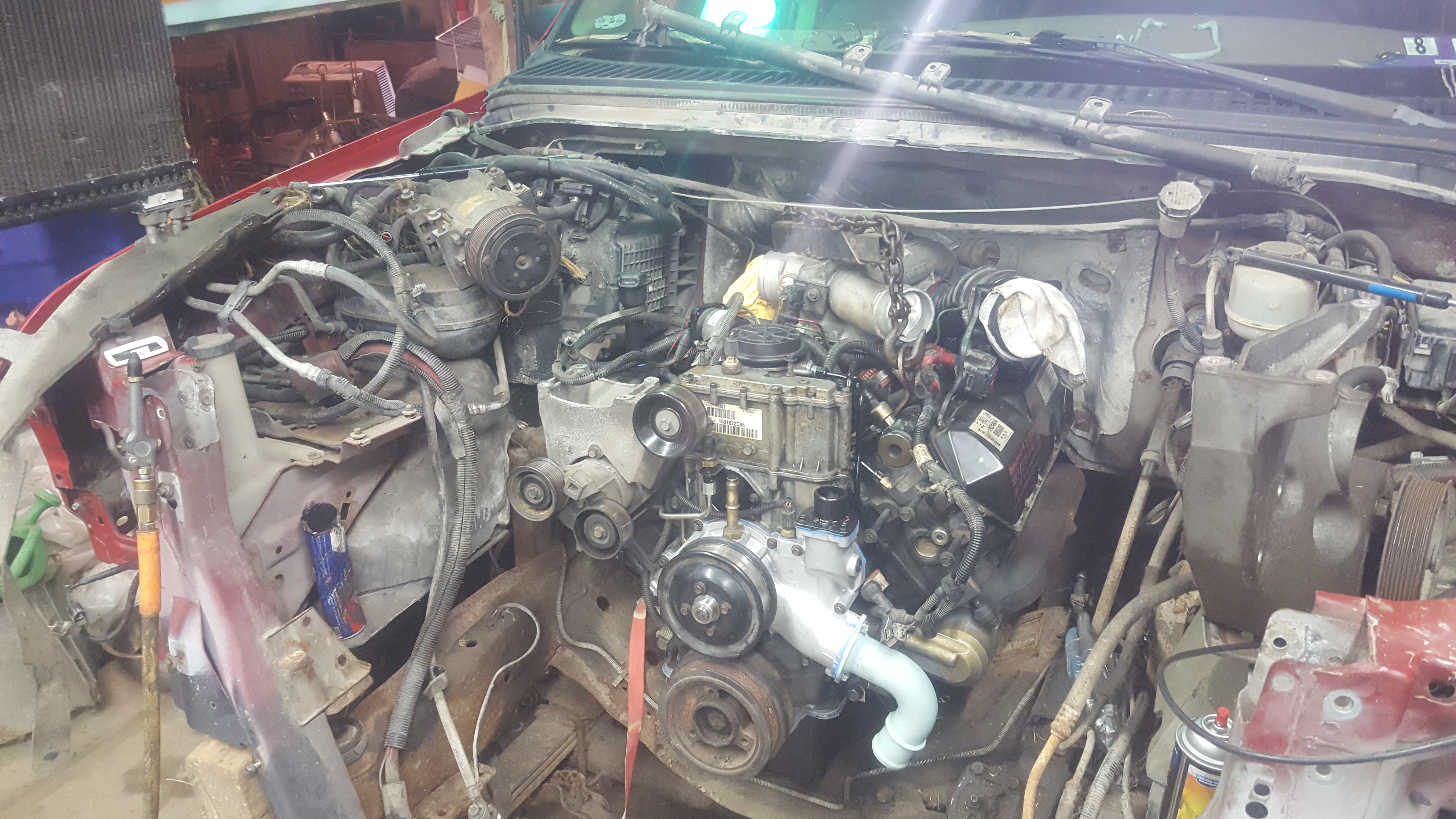

Slept for a few hours after I got home from work this morning and made it out to the barn in the afternoon. Got the clutch on, the truck into the barn, and after dinner, managed to get the motor in the truck. Not a single bolt holding it in, but it's sitting in the chassis. Now I gotta find bell housing bolts, motor mount nuts, etc.

Nice Greg! I've been watching this thread for a long time with a sense of awe and dread. You make these things look easy.
Got an e-350 van for use as a family camping van and hauler since the old ranger just can't tow a tractor. It's one of those where you remove the bell in the cab to get to 70% of the engine and lord help you if you have to get to the other 30%. Your pic make me think if push comes to shove I can just drop the radiator to get to major stuff. Thanks for the pictures and he comments then help other shadetree mechanics like me
