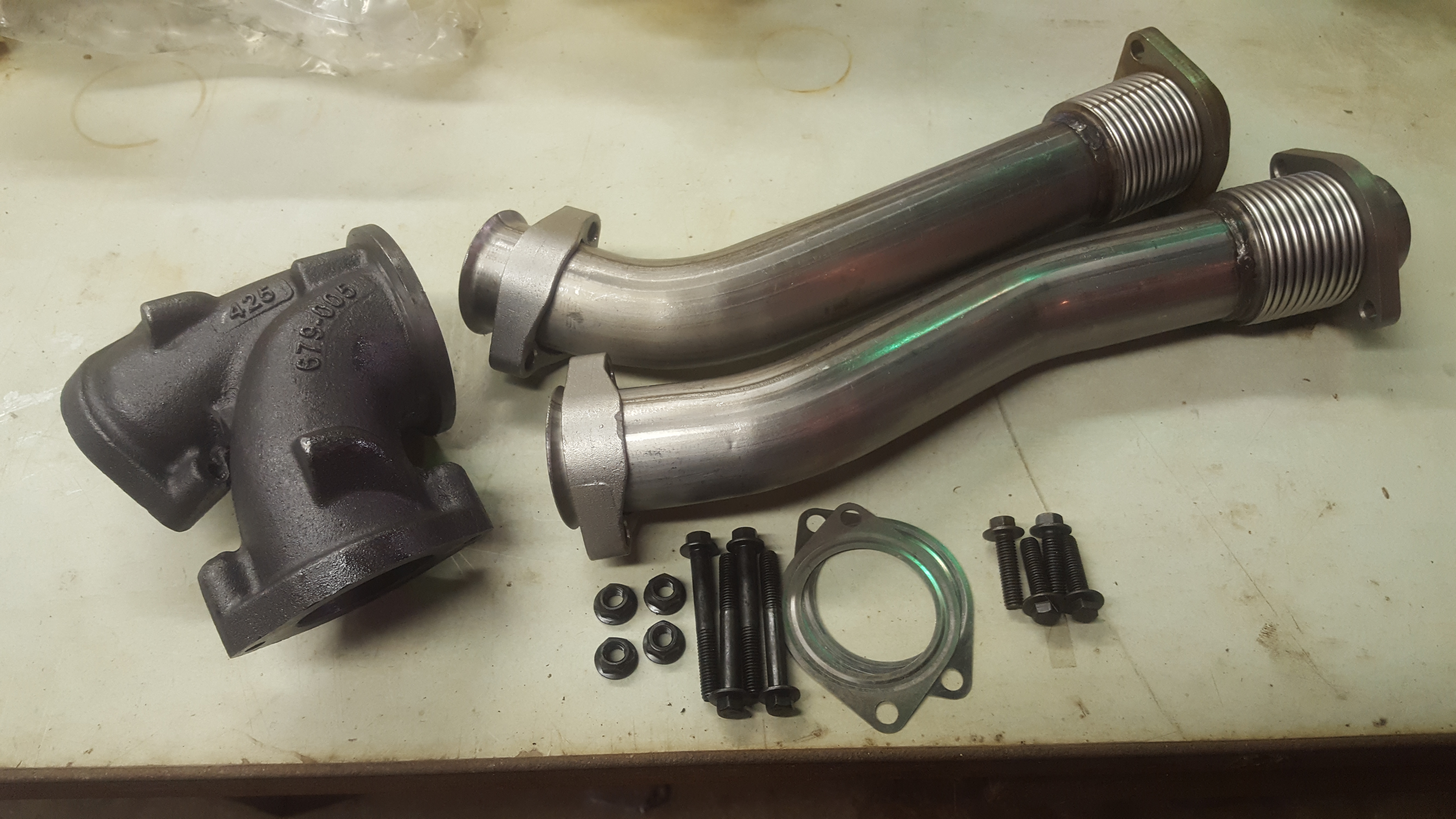

But I've been down to the barn anyway... up pipes on, intake spider in place, wiring harness in place and hooked up.

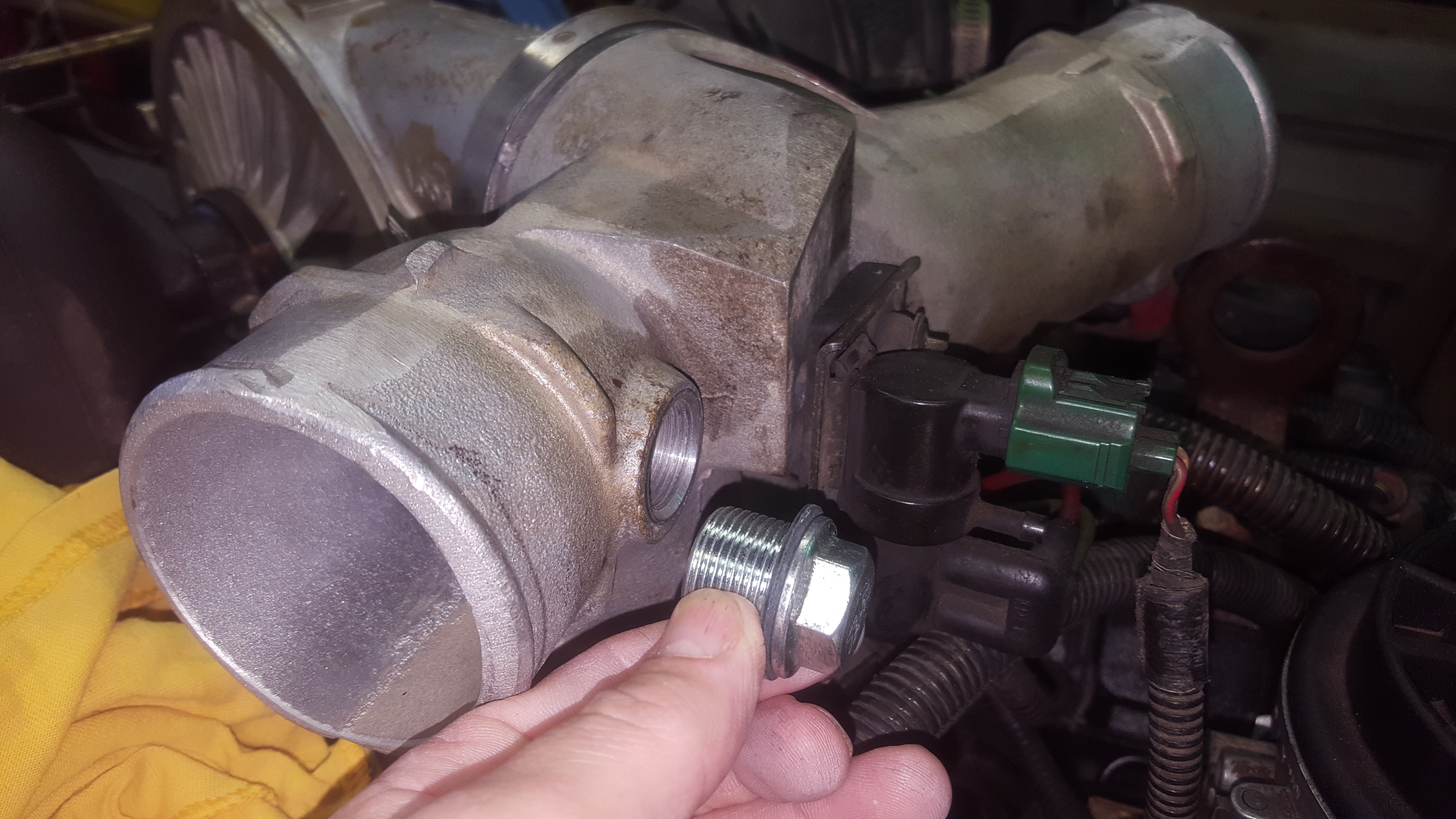

Not much progress, little details to deal with. The last fuel lines from the fuel bowl to the frame flex lines have been cleaned up, painted, and installed. A fitting to take place of the AIH (Air Intake Heater) in the intake spider was bought (oil drain plug for 1970-1985 BMW Dorman p/n 65223) to fit the 22mm x 1.5 threads, and drilled/tapped in the center to 1/8 NPT for a boost gauge fitting.
