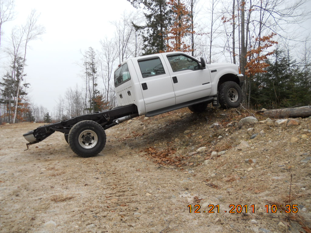

I know that there are a bunch of variables, but what is a "clean" 2001 F-350 7.3 A/T CC/8' with >200k worth in YOUR part of the country? Only minor minimal rust with nothing showing through. It got a NOS complete bed for it and I park it under roof all winter long. (next to my F-450 4x4 7.3) I've been hanging on to it because I like it, but also (in my mind) it's becoming a classic. It just seem's a little silly keeping it insured and tagged for 1000 or so miles a year.
You guy's got me wondering with some of your stories of looking for a 7.3. This pic is when I was putting on the new bed, I had it parked like that to oil the underside, it hasn't changed any.
Worth about $2k to me but I'm a cheap ba$t@rd looking for a crewcab to cut up to make an extended cab crew cab.
Jokes aside... would bring $6-$8k around here, $10k if you're lucky.
4wd? What options?
2wd XL's like that are plentiful here, the SB 4wd with options can go over 10K, while a rusty extended cab with full options is a hard sell at 5K, and even 4's don't move quick.
Rusty and a hundred K more than mine - $2 grand less.
800 more: 22 Ford F35 Crew Lariet ( 7.3 Dsl )
2 Ford F35 Crew Cab 4x4- 7.3L DIESEL! Runs Great!
