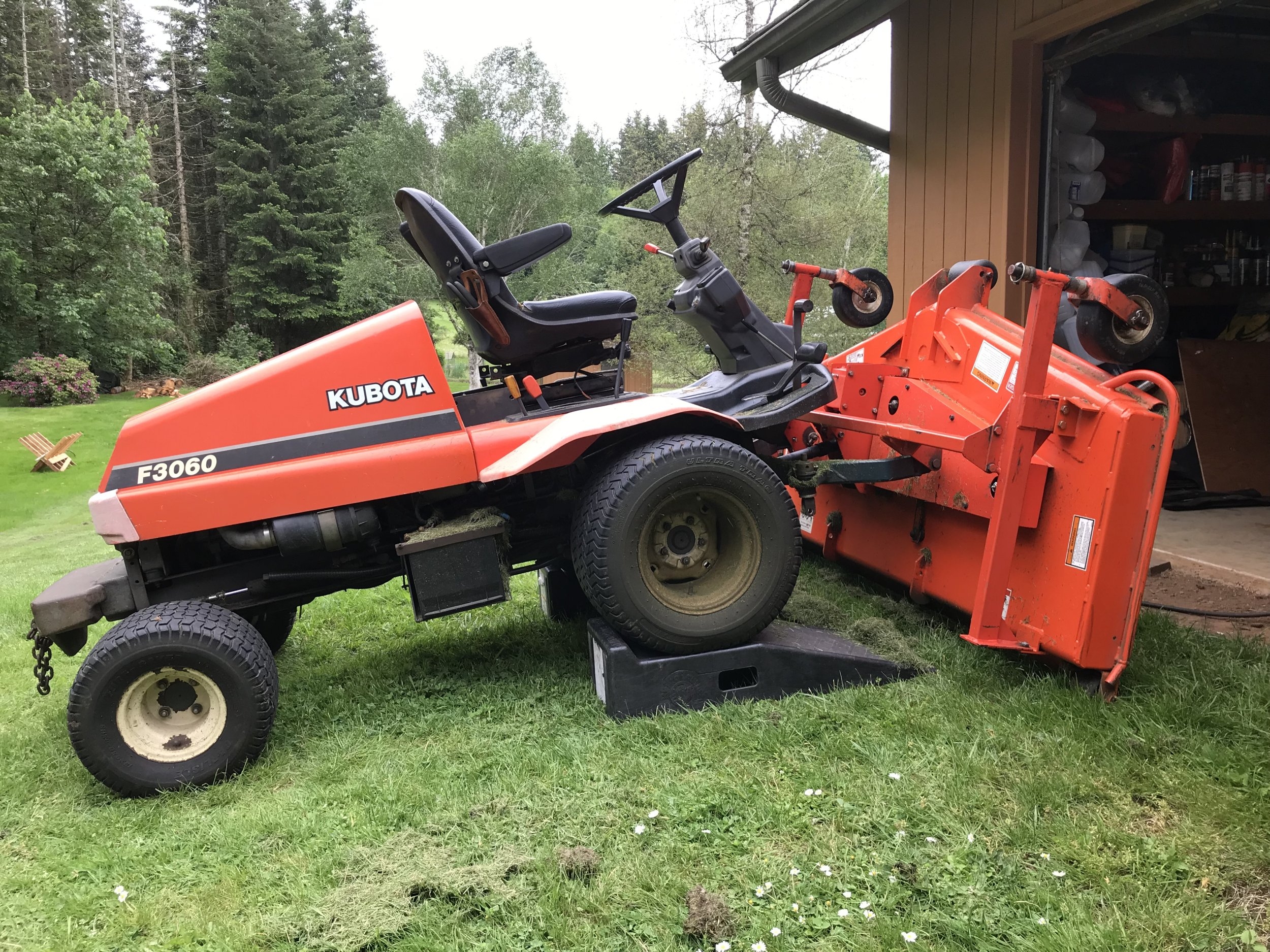

Agree, the deck is heavy but can be flipped up by one person with little bit of muscle!
The manual recommends disconnecting the PTO shaft, but it's not necessary at least in my F3060 - but just remember not to mess with the PTO lever if doing it with the PTO still connected...
It's little more work, but if you want to play it safe it's best to disconnect it.
I you look closely you can see PTO shaft is still connected in my photo below.

I can second Arto's point that it is not required to disconnect the PTO shaft on the F3060. I use the blower after mowing every time and it has never been a problem. Before lowering the deck, I turn the blades by hand to check their condition and they turn without seeming to bind up the u-joints.
