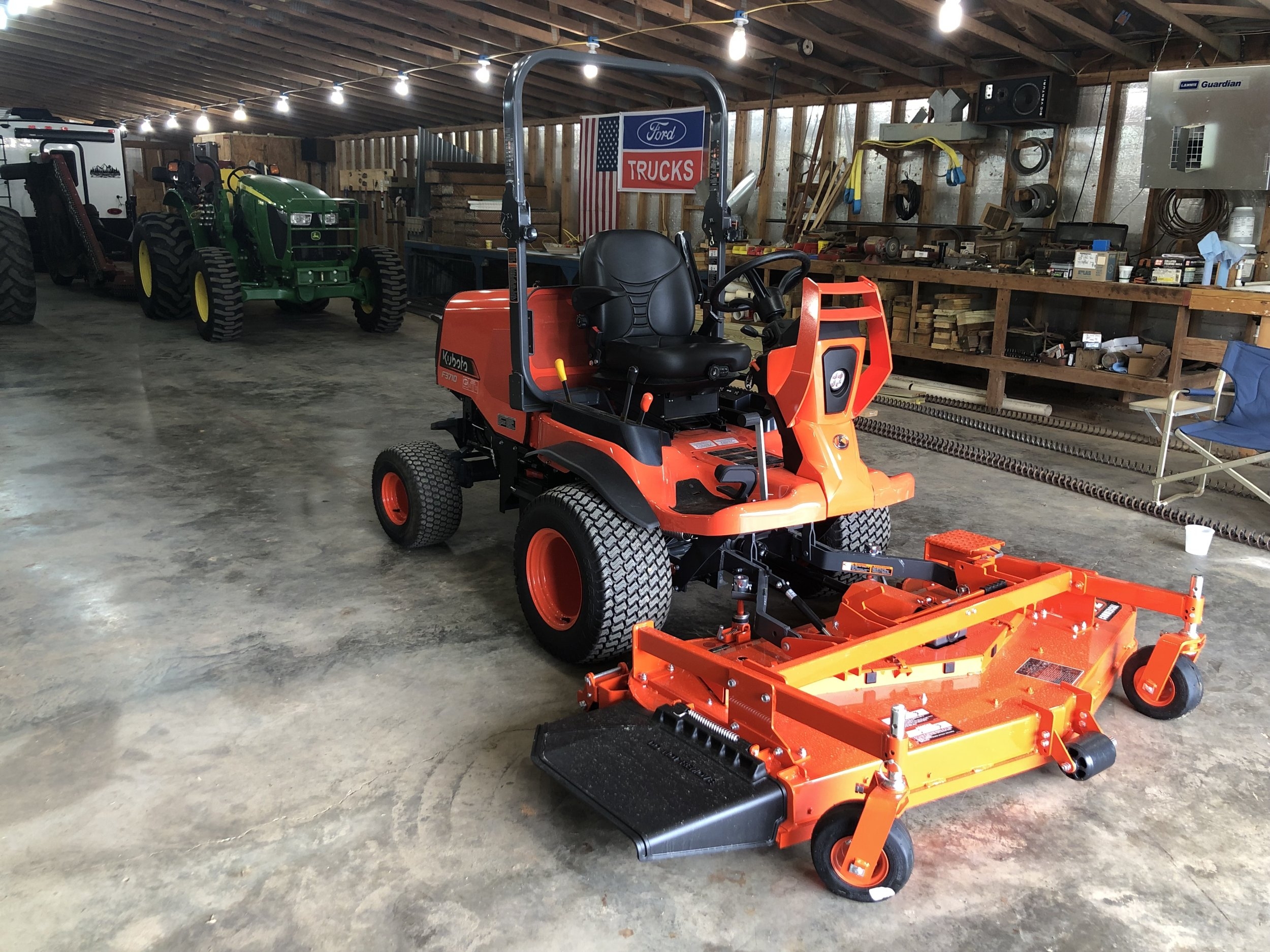

Well the new F3710 landed today.
I adjusted the deck so the outer blades measured 3.5” off concrete floor front AND back 6&12 - then 3&9 o clock to get left & right side of deck level.
Real PITA as @Hay Dude mentioned.
Steep bank was wet so I mowed it anyway :LOL:
Superb Traction going strait but front inside tire spins pretty bad turning 90* to go uphill.
I figured it’d need all 4 fluid filled.
Ride is great but deck takes a beating : even in low range about half the ground speed it’s cable of.
See the DYI Thread on bigger front deck wheels here on TBN

I don’t like how the deck is slow to raise & let’s down SO FAST 😠
I hadn’t found an adjustment to slow it down 😬
It takes precise SLOW moving the lever.
It’s way different than my current ZD1511 & going to take some getting use to the controls in different locations.

Nice looking machine. With some practice you will be able to feather the deck speed up & down. It has taken me a little bit to get it right on my F2560E.

Thanks.
I found an adjustment knob in owners manual to slow the drop down.
I’ll have to dial that in tomorrow.
