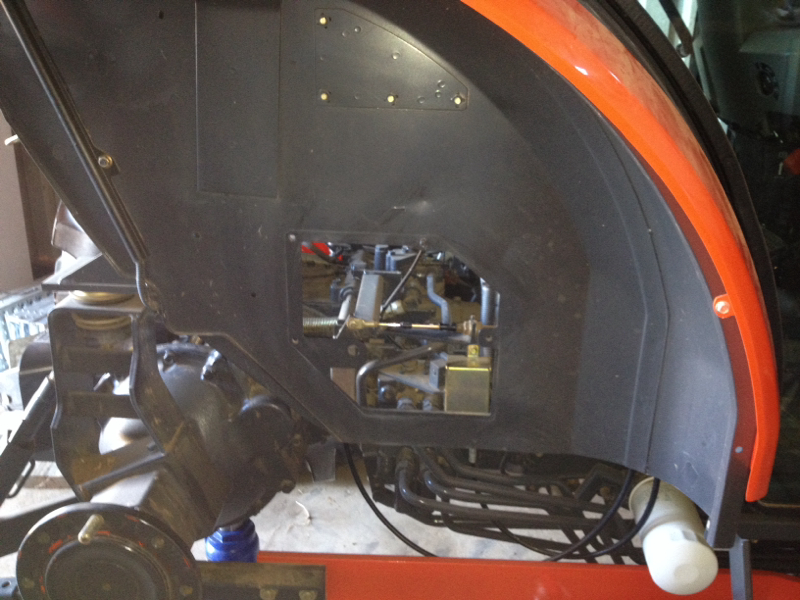

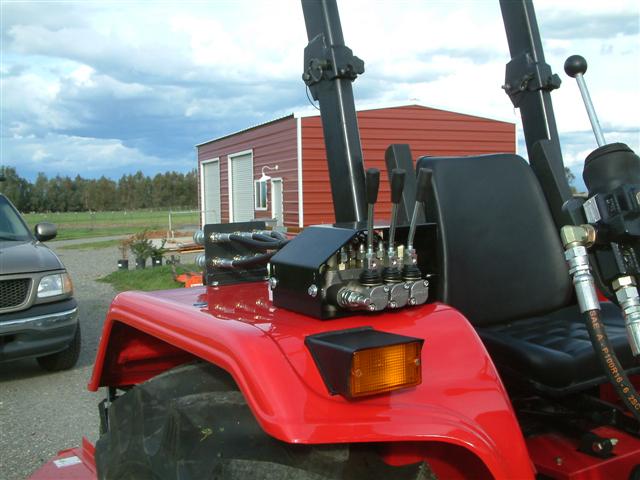

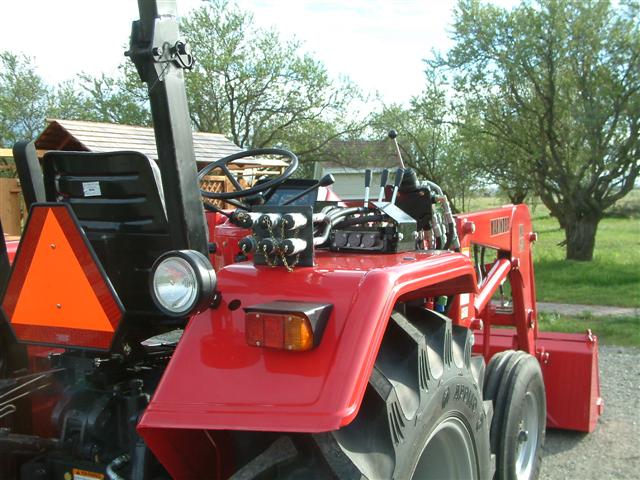

You understand that I have an OEM rear remote on this tractor, right?? :confused3:
Very simple, very clean. ;)
Yes, one OEM rear remote with the 3 block electric hydraulic diverter next to it. That is the cleanest setup I have seen.
/ Factory triple remote install #22
OK, just wanted to be sure. I agree, very clean, thanks for the complement. The valve mount is actually bolted in the OEM bolt holes. The outlets are in the OEM location height wise.:cool:

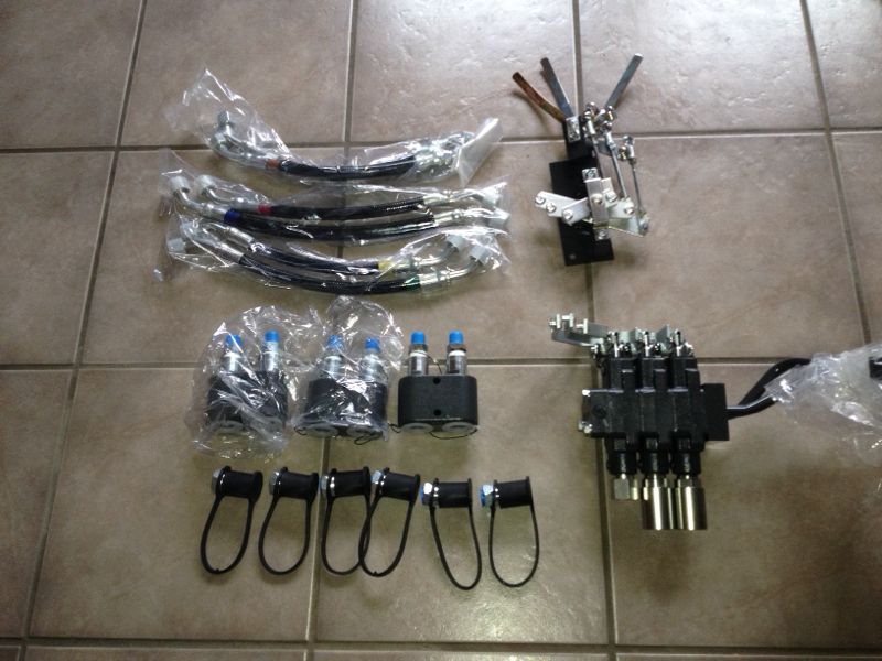

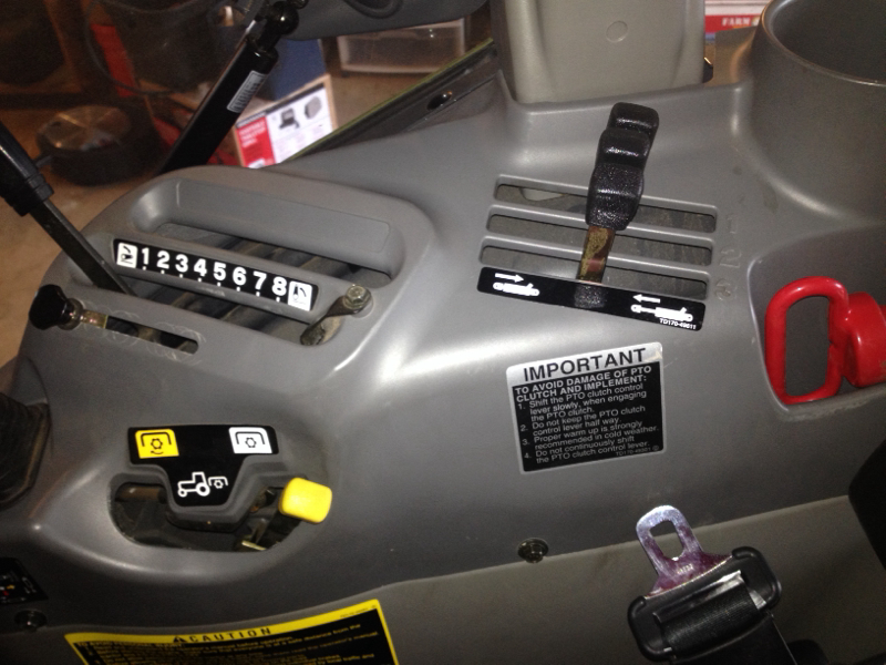

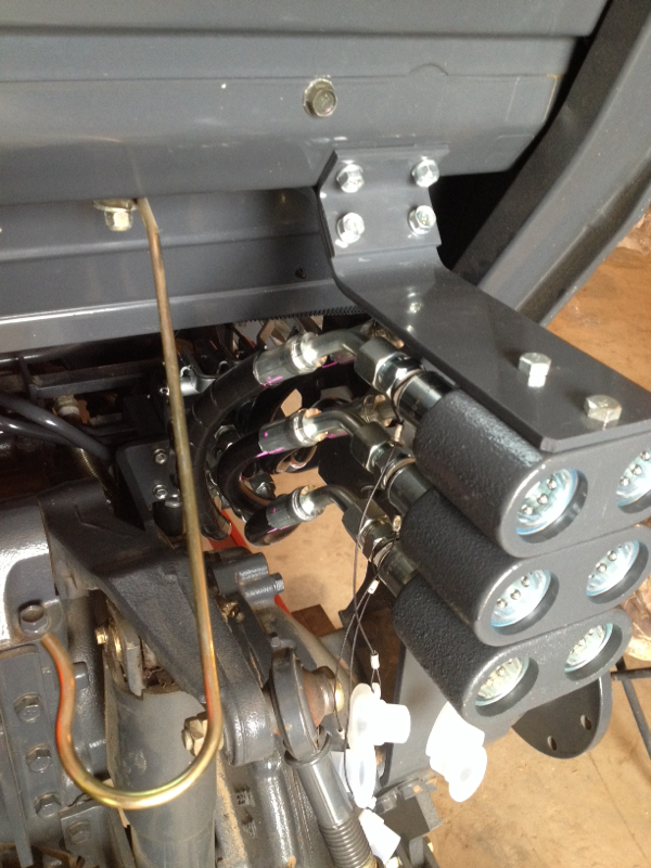

Finished the install yesterday. Really great kit (for the money it otta be right?). One if the few jobs I've done where it all went together without a hitch, first time, no leaks and truly just bolt it up. Had I bought the tractor new this is what I would have got so its great to be able to add it later. Absolute hardest part of install was R&R the right rear tire, loaded R4, hard to even roll and shimmy it on the concrete barn floor.
Here are a few pics.
1shot is all 6 hoses perfectly fit length and connection angles from valves to QCs.
2nd shot is complete linkage inside cab
3rd is the final product, sticker and all.
Now just waitin on my Fit Rite TNT to ship and will be all set.
