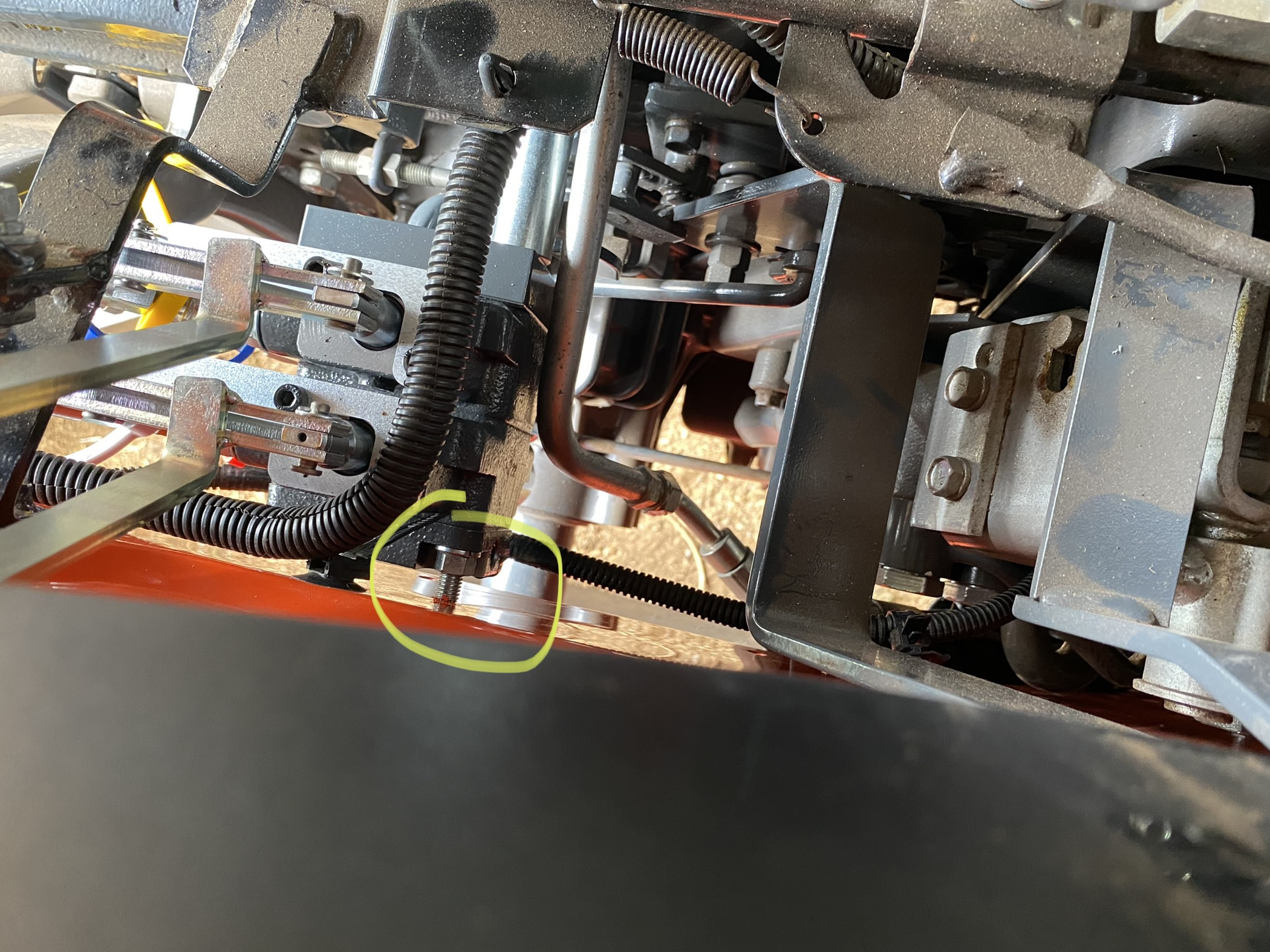

Ok just to report back. I think I got it all installed ok. It wasn’t terribly difficult. I’m yet to give actually start the tractor, so I will let y’all know whether it indeed works shortly. The instructions are certainly a bit lacking, sometimes you had to defy them or else it logically could not be assembled. Both the instructions and the exploded diagrams leave out an entire (large) bolt which is supplied and clearly necessary. There’s a puzzling number of o-rings left over, but after scrutinizing the instructions for a forth time over I’m positive they’ve not been left out of anything.
Kubota’s tolerances are impressive, the whole thing only just squeezes in. The biggest concern I have is with the end of the bolt pictured which sticks out far enough to press against the fender. I didn’t notice as I was tightening the fender retention bolts that it was pulling it in against the bolt- enough to slightly bend the fender and knock off some paint.
I’m worried it might be putting a dangerous amount of pressure on the whole remote assembly…?
I guess if I remove the fender again I should be ok to just grind the end of that bolt off? I can’t see that I’ve put it on incorrectly
Is that the bolt that goes through the entire valve body? I can't see where the head is. I'd vote for either cutting it off or putting it in the other direction if that's a possibility.

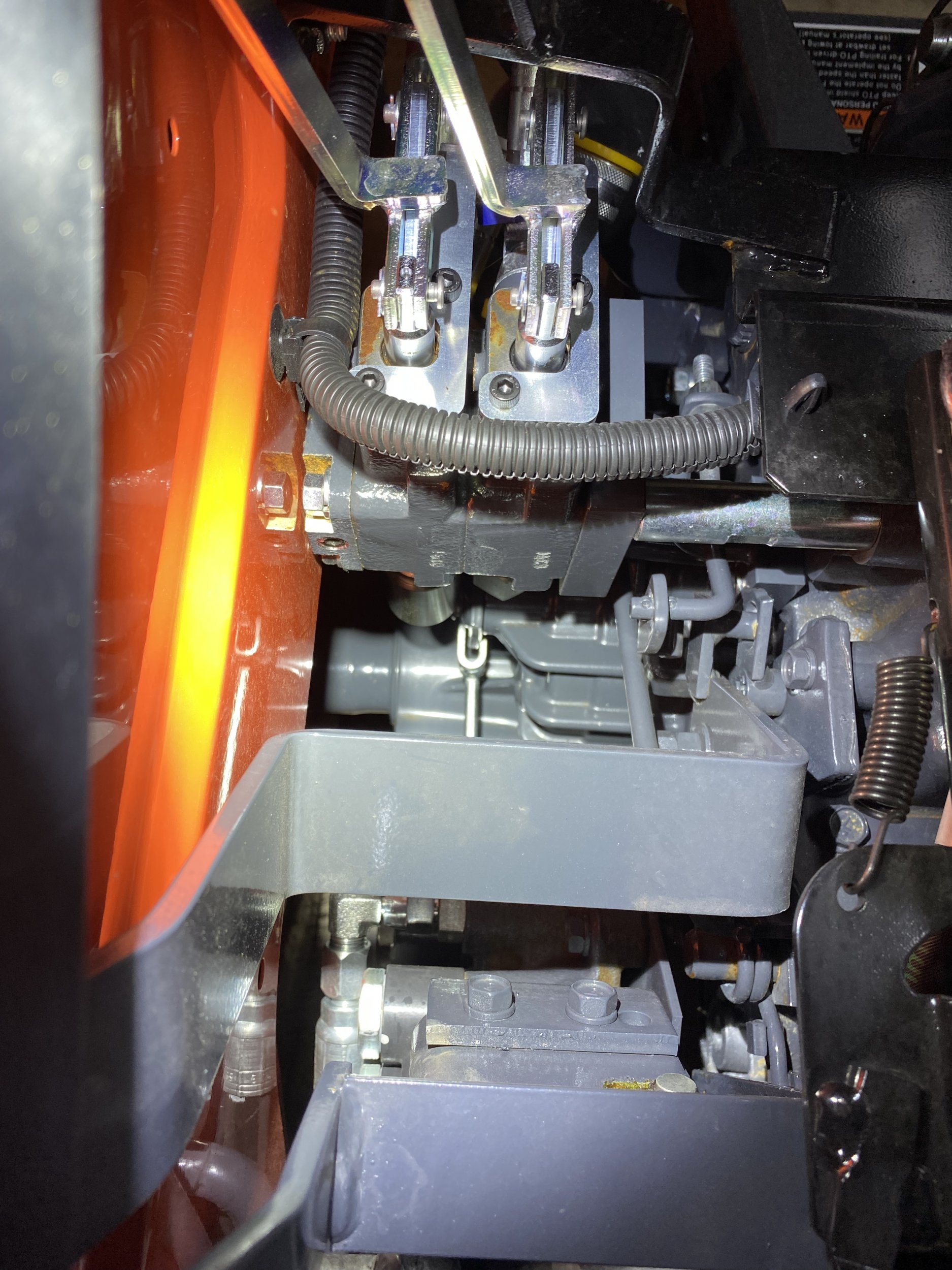

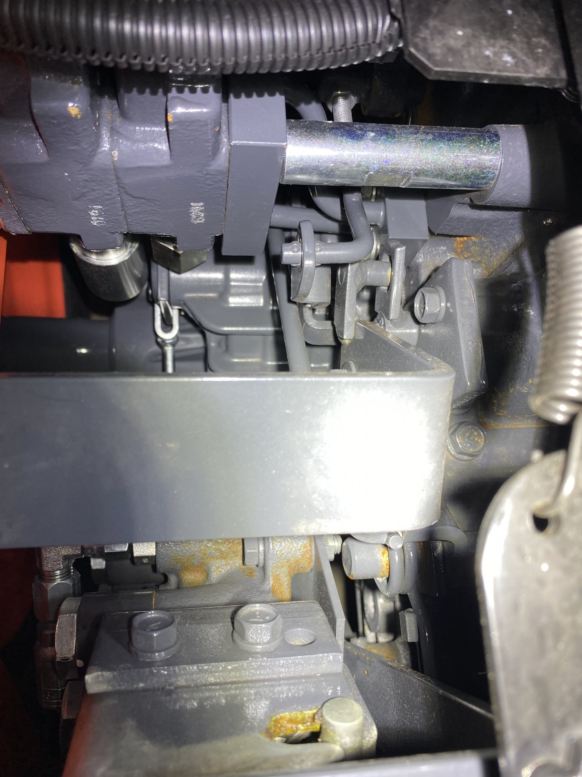

Hello folks,
I’m new here but wanted to show Tallguy my B2601 recently Dealer installed OEM rear remotes. I included some photos of my setup and the spacer that has the square notch in it looks like mine is different. The bolt on yours may not be screwed in far enough.
The nut on mine is flush with the end of the long threaded rod, and leaves a slim gap Between the fender.
The Diameter of the spacer Is .786 of a inch, and the length is 2.900 of a inch.
I hope this may help you as a reference.
I only have 10 hrs on my first and only tractor.
Only 21 more weeks until Brian from FitRite Hydraulics sends me my Top and Tilt cylinder order.
Those extra O Rings are indeed replacements as I got some in packages from the dealer when they returned the unit After the install just a couple weeks ago.
One of the valves is the B7305 which is the valve with Float detent option.

Oh wow, thanks Shish, that does definitely help. Looks like mine is no where near in far enough.
I will be removing the fender again and checking that threaded rod/bolt to make sure it is in all the way. It was hard to get a grip on it when trying to tighten it, since it just has threads on either end and no head to put a spanner on. So I will try some vice grips.
