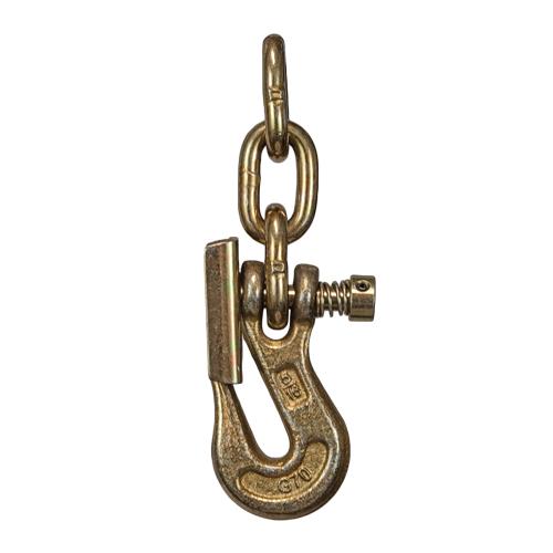

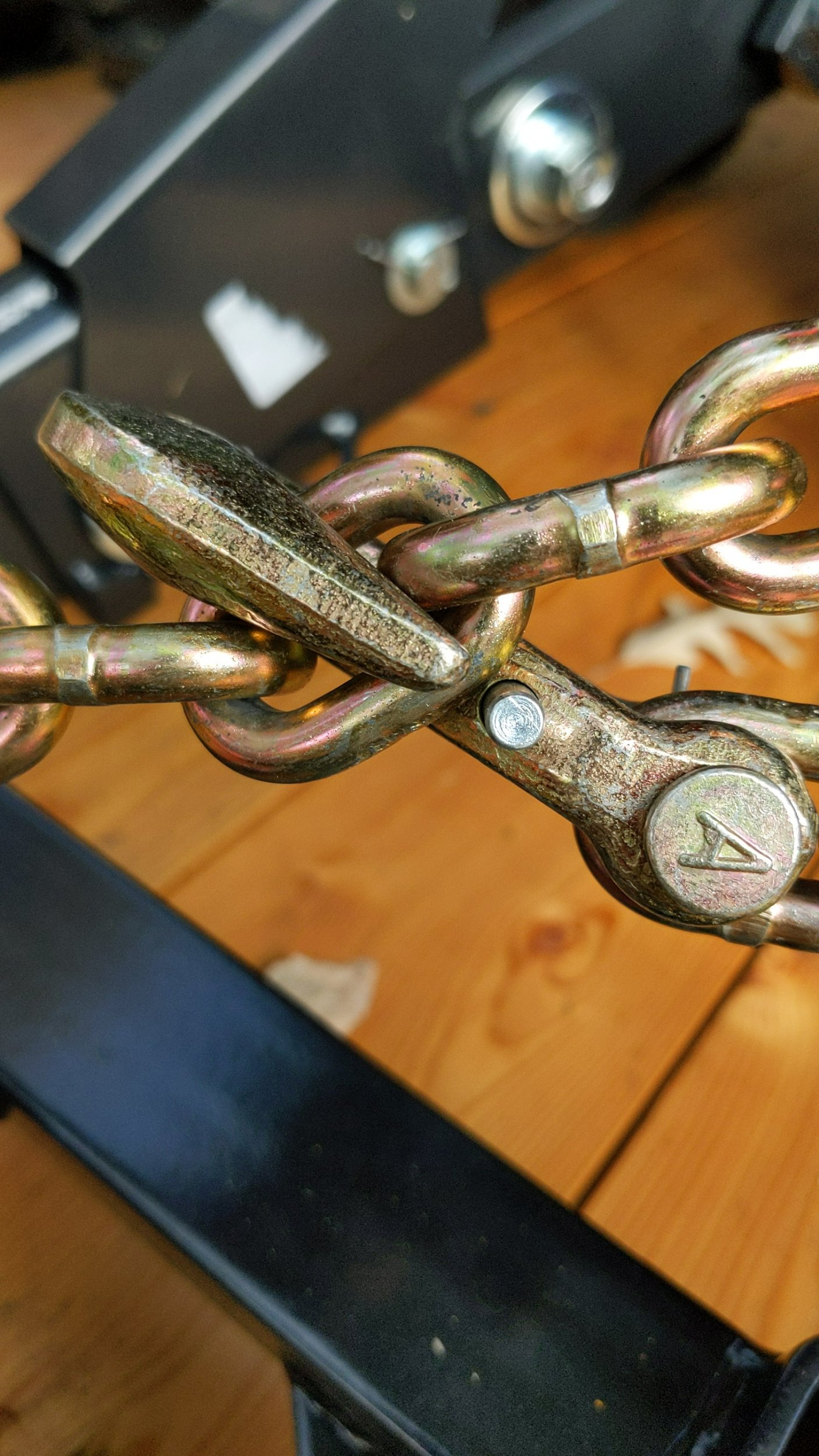

pretty new to chaining anything. For my grade70 chains i dedicated to my tractor's trailer, i bought 'locking' style clevis grab hooks
  • because it makes setup a tiny bit easier (no dropped hooks before i get it snug), plus
  • theoretically in a "bad event" where there was a some momentary slack (broken chain on a different corner, collision, etc) the locking pin might keep the hook engaged until the (shifting - again, SHTF situation) load finds a new position. Theoretical, border case; but I drive an undivided winding two lane highway that has zero barriers, a 15' embankment to a river, and a bunch of idiot drivers - so I'll take anything i can get :)
Anyway, two of my four hooks, after just one use, clearly have had some load put on the pin (and the pin can obviously take *zero* load - one locking pin cannot be operated at all, even with pliers, and the other one is very tight now but still hand-operable.

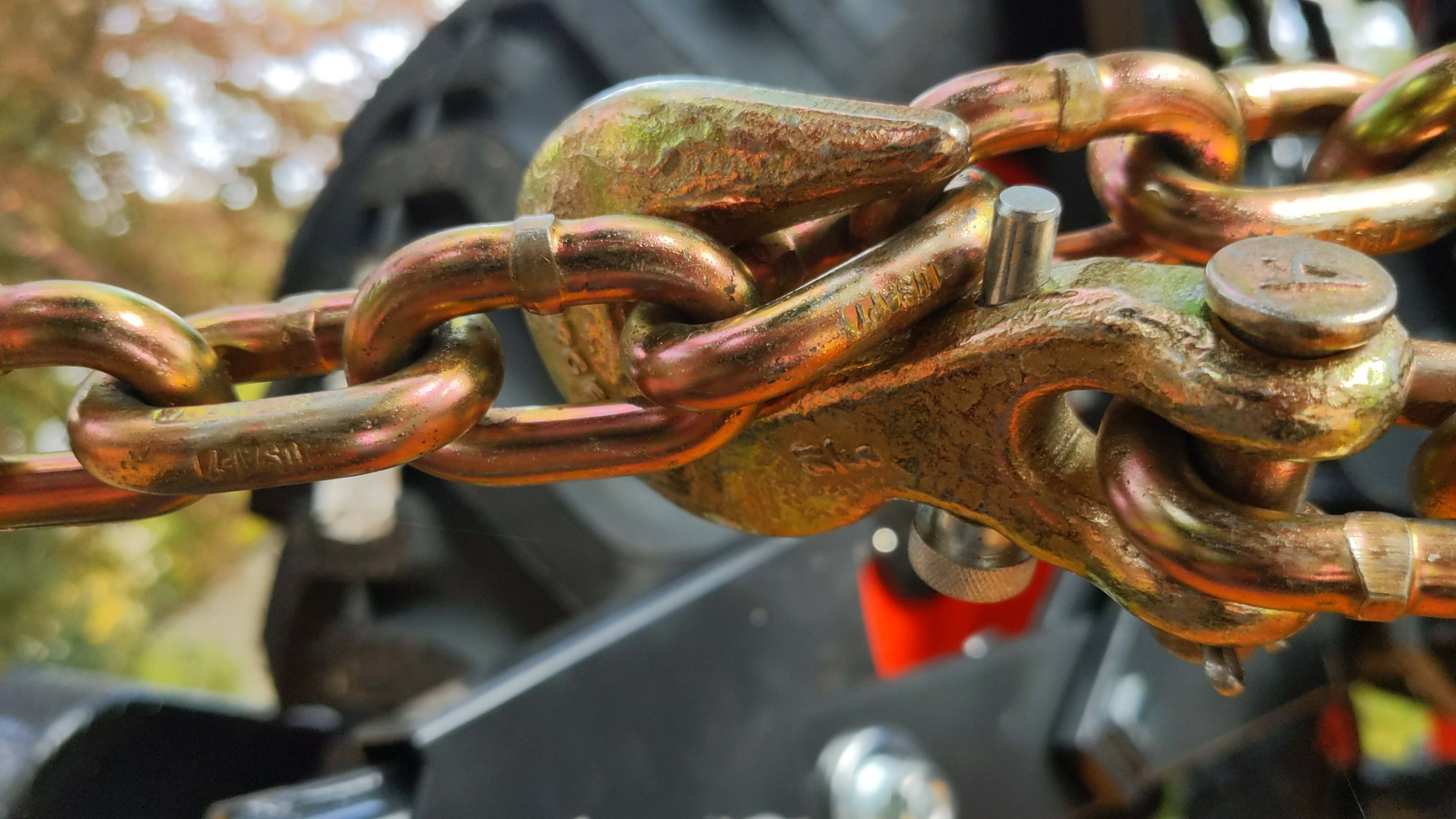

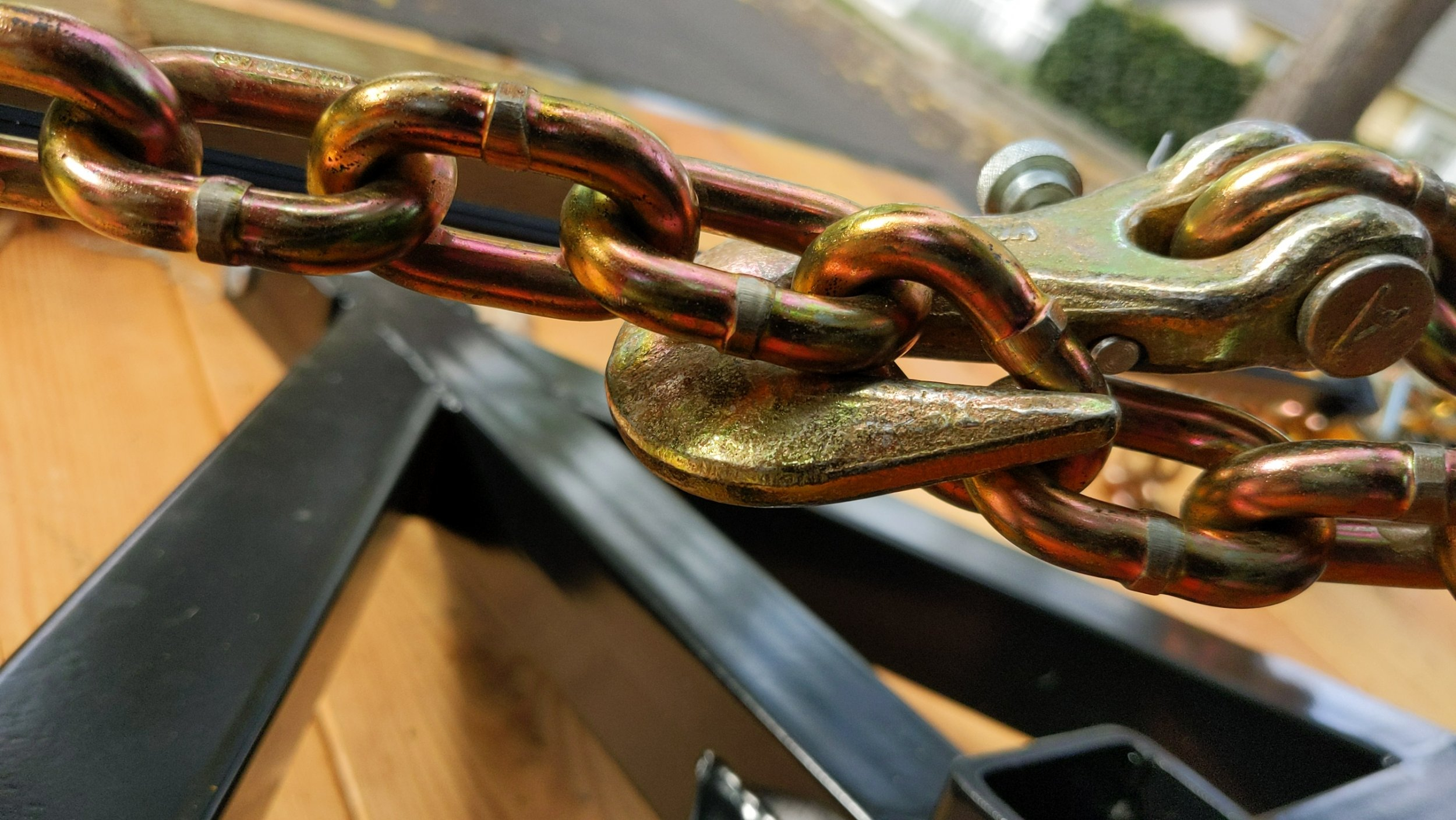

Here's a picture of how I have them bound: This one is undamaged, has ~1/16" gap to the pin in this setup. Of course i didn't know the pins were damaged before i loosened the load the first time, so I don't have any pictures of the 'bad' engagement - but I was pretty careful and it was set up exactly the same way.
Here's the hook that is still 'barely operable' (I've left the pin open where it stays by friction now)

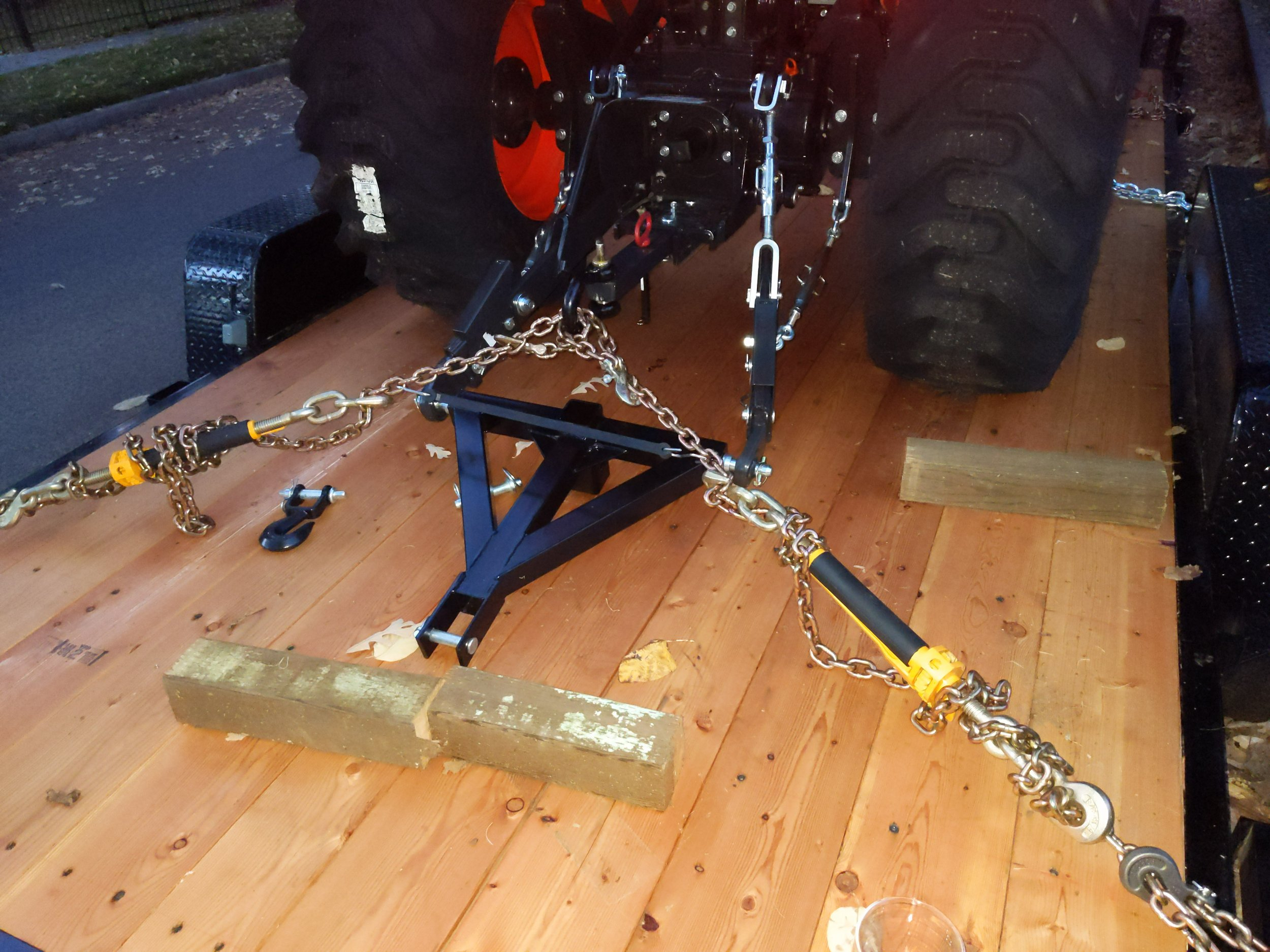

Can you think of anything i could be doing wrong here? About the *only* variable i can think of is 'loop length' before i grab the hook to its chain; mine are short, maybe 6" here. Thanks!!
Change tractor to a 2 points tie down instead of just 1. Most securely is typically at axle.

Let me emphasize that although i have a technical background, i know nearly nothing about the "right" way to transport.
The first points in my OP are that standard grab hooks obviously work fine, but given the option for "standard grab hook" -plus- "retainer clip" i'll choose the lock/retainer - it makes it slightly easier to chain up as everything stays in position no matter the orientation, and it could, maybe/theoretically, help in a severe incident (without having any safety draw back AFAICT).
I agree that by the axles would be ideal, but as I found earlier in nOOb to chaining down - is this sufficient? (I'm the OP) that was not possible. It's really inexplicable to me that this major-brand tractor does not have dediciated transport points, at least as an option.

There are safety reasons, why orientation is something to be educated about. A few quick points on this. You want the force to be pulled into the throat of the hook, regardless of what style hook. If you orient the hook so the force is into the tip and not the throat of hook, you have set the hook up for failure (it only takes one failure) and you have a bad or worse day!
Hooks falling off chains is frustrating—probably why you went with these hooks to begin.
A loose chain is dangerous as is a loose load.

There is a reason I've never ever seen those hooks with the pins being used. They are practically impractical. You could hook everything up correctly but still have everything move on you

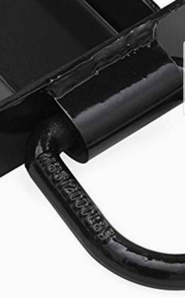

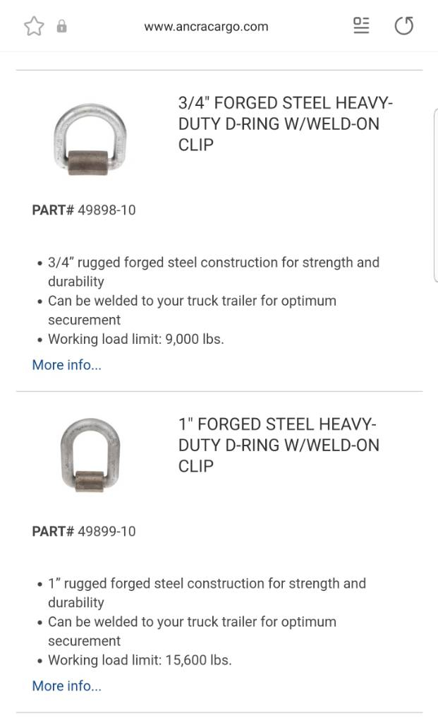

If you want D-rings please use 3/4" or 1".
/ failed locking pin on locking chain grab hook - am i doing it wrong? #35
A stake pocket is better for hooking a chain than that is.
I do not use them. I see no need for them. There are people that do not like to use the stake pocket. For info only. As to the size of the D-ring look at the WLL on each part of your securement.
As in another thread the grade and size of the chain or other parts of the securement is important. Not just the size. A 1/4 grade 70 chain is stronger then a 3/8 common chain. You need to look at the WLL of each piece.

I've never lost a chain using a stake pocket. If you attach the chain correctly, the weight of the chain will keep the hook in place. I also never used more than one chain binder. Both chain hooks were placed in the stake pockets, then I would pull the slack to one side and put the binder in a convenient spot. Tighten the binder, then take the loop of chain in between the two binder hooks and wrap it around the binder and tie with a wire. I drove a hotshot truck for a while delivering vehicles into the oil patch and ranches, so I got lots of practice. DOT guys never questioned my manner of doing things. The main pita was having to chain both the bucket and the scoops on backhoes. It was overkill, but I was told any and all attachments required a chain.

mbs12000lbs
max breaking strength 12000 lbs
Seems I can not read well I my old age. A 12000 shear is not all that much, that is what, a 4500lb working strength?
Need to find that old chart I have around here somewhere. I know it is less than half...
/ failed locking pin on locking chain grab hook - am i doing it wrong? #39
If I remember right, G70 in 5/16 chain is 4700 pounds.
