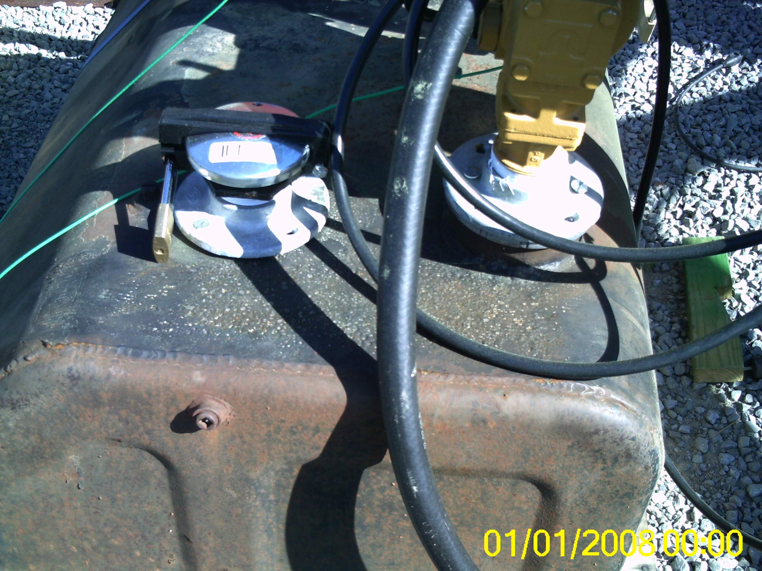

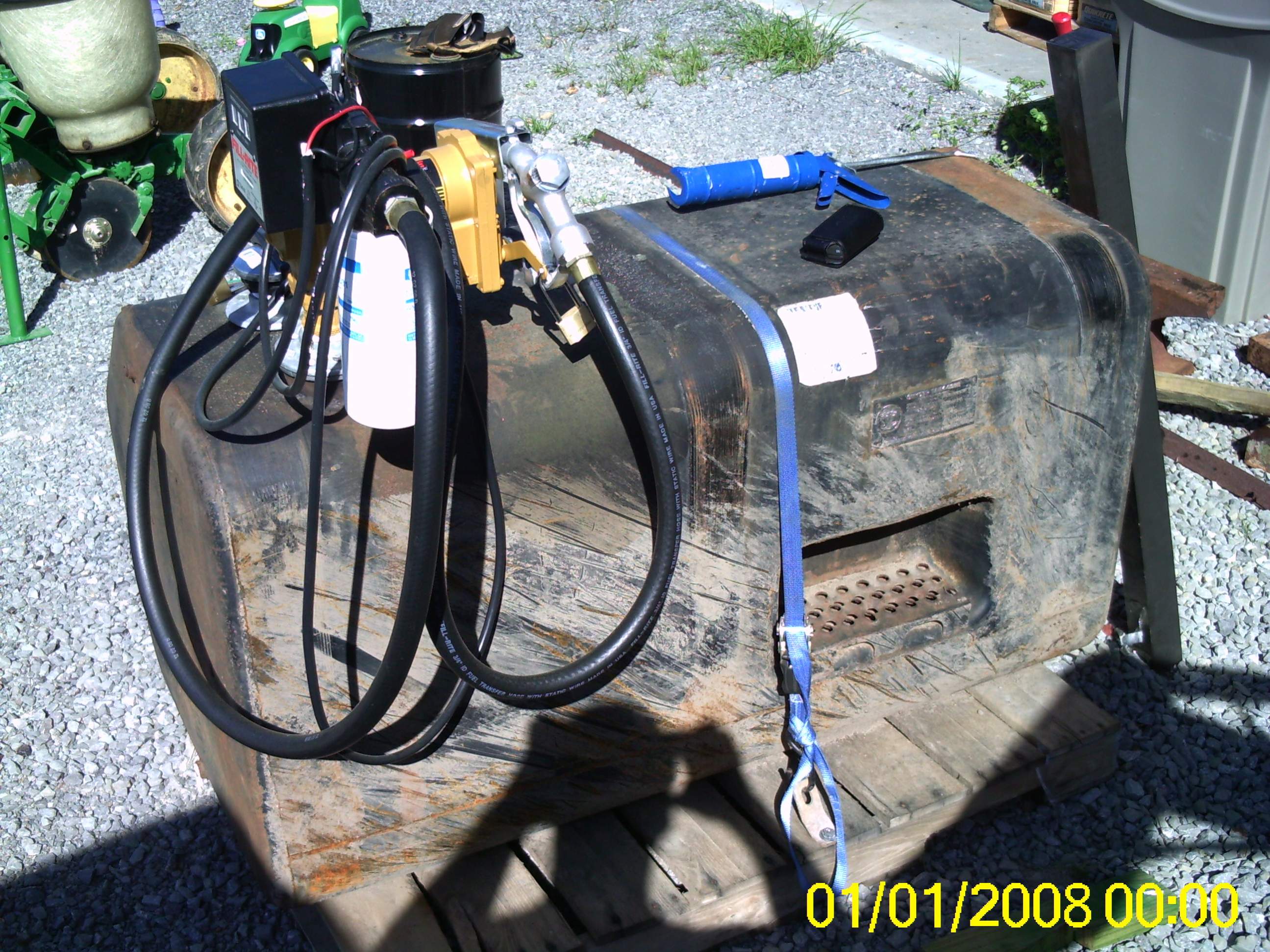

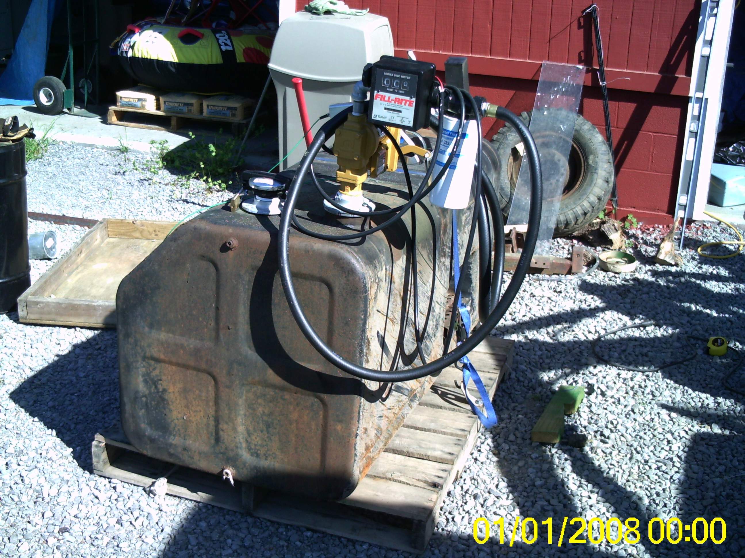

I know it's been a while, but I finally got around to taking pictures. I went to a local "Big Truck" junkyard and picked up a 150 gallon saddle tank off an 18 wheeler for $100.00. I ordered a Fil-Rite 13GPM pump, filter, and meter for another $450.00.
The tank had a screw on lid that was 4" in diameter. I drilled a 2" hole in the lid and mounted a floor flange with 2" pipe threads. This is where I mounted my pump. I then mounted another 2" floor flange with pipe threads over an existing 1" hole in the tank. I put a vented fill cap on that opening. I use this opening for filling the tank.
I mounted the tank (it's 50" long) on a pallet and set it in the back of my truck with my tractor and pallet forks. . I drove 12 miles to the local off-road pump and filled it up. I've already used 70 of the 150 gallons prepping ground for crops.
BTW: I see single axle trailers hauling 150-300 gallon tanks all the time with off road diesel in them.
Hope yall like!!!!
Chris

I have a CDL. I'm not real worried about the DOT. Thanks though.....
So your telling me that the driver of the truck (the tank came off of) had to have a haz mat and tanker endorsement. The truck had two of these tanks mounted on it. 160 gallon capacity, but with 150 gallon fill capacity. So he was carrying 300 gallons of fuel. BTW these tanks are DOT approved. Stamped on the tag on the tank.
I am probably going to go back and buy another one to use for used oil and hydraulic fluid storage. That way when it gets full I can load it with the load and take it to a buddy of mine who uses a waste oil heater. He can pump the oil out into his larger storage tank. No more wrestling with 30 and 55 gallon drums.
One reason I hadn't posted this pictues was that I knew I would have everybody telling me how illegal I was. Well..... when the DOT man tells me I'm illegal I'll worry about it... :thumbsup:
Chris

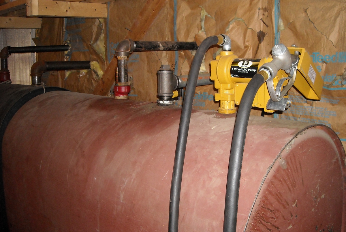

Maybe bigger than what you are looking for but this is what I have.
Around here, 275 gallon tanks used in excellent condition are rather cheap. Anywhere from free to $75.
I have two 275 gallon tanks in the garage. Had one for the oil furnace and when I found another almost new 275 for free, I hooked them both up to the furnace. (Storing over 500 gallons is handy) Since I park the Kubota beside them, I put on a electric pump with 24 feet of hose. Sure is nice quick fueling but I do not really need a 13 GPM pump to fill the tractors 6 gallon fuel tank. Notice I am not filtering the fuel. The furnace draws from the bottom of the tank and the fuel pump draws from 2 inches above the bottom. The furnace will alert me of any water in the tank long before the tractor will.
And yes, I use #2 heating oil in my tractor. Always have, always will.
Click on attached thumbnail to enlarge.
