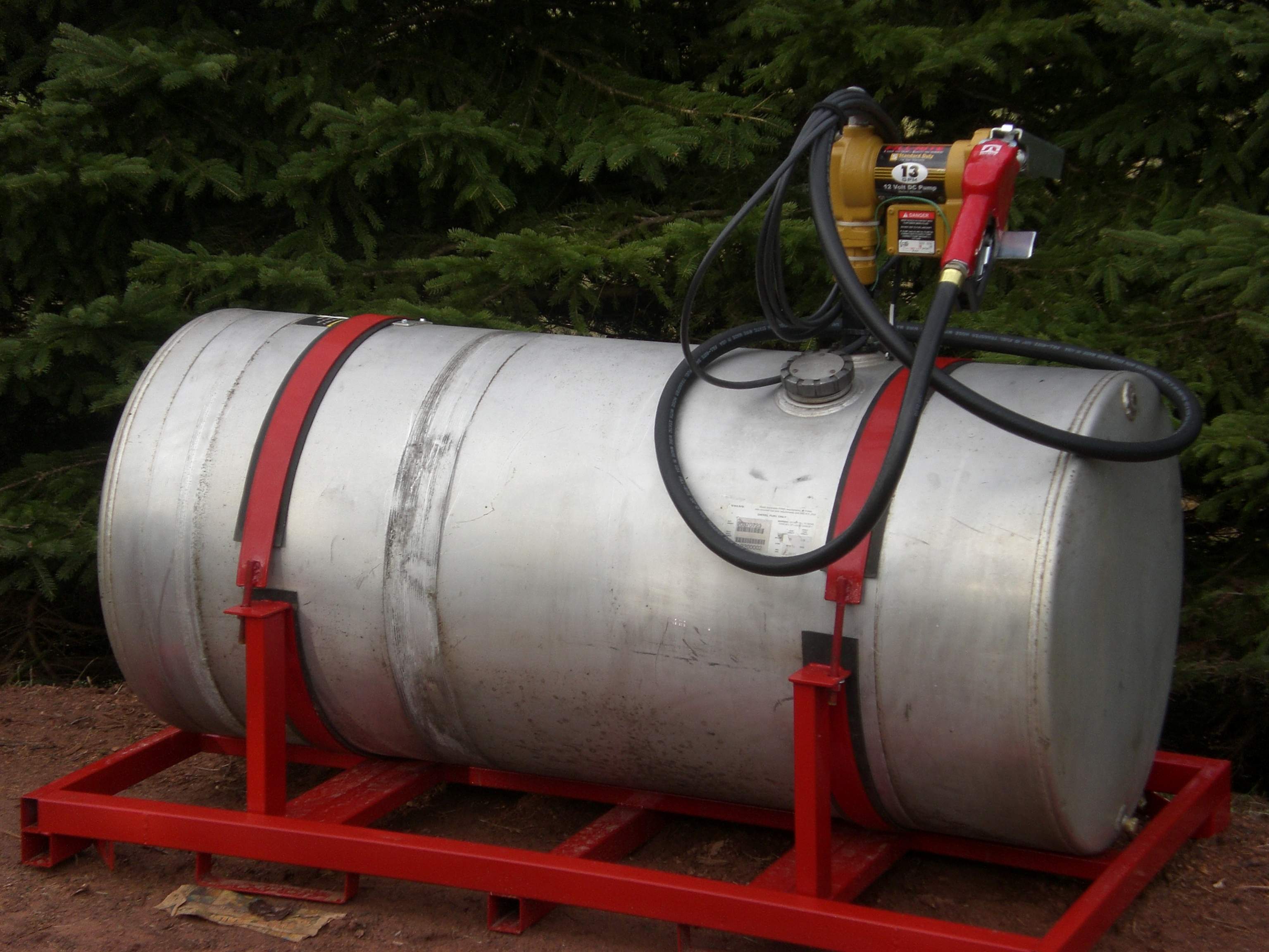

Back on the topic of actual fuel tanks, Here's one that i just finished up. 125 gallon saddle tank sitting on a steel cradle with a 12v 13gpm pump. Put a 2 wire plug on the pump and wired all of my equipment with corresponding plugs to make powering it up easy.
Good looking tank. I inquired about one of those, but they wanted way too much money for it. $250.00 I think. The steel tank does fine and I didn't have to build a saddle to put it in. I just strapped it to a pallet.
I bought the same pump as you.
