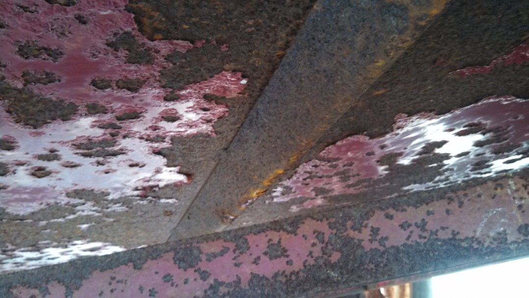

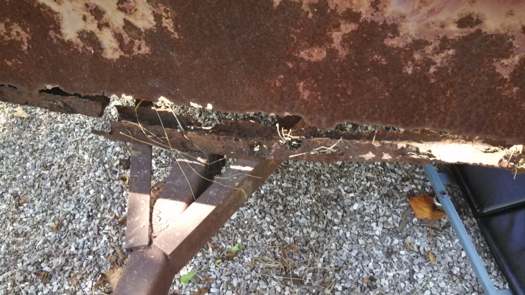

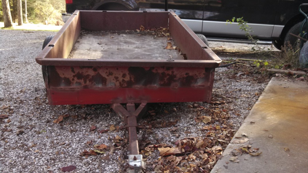

Not sure this is the right forum, but need some advice on repairing an all metal 4x8 trailer. The diamond plate is rusted out in the front, along with the 2" channel that ties it to the frame. Do I need to completely remove the old floor or can I just replace the front channel and repair the rusted front, and drop a new sheet of diamond plate?
This is a farm trailer and doesn't need to be road worthy. It just needs to haul wood and yard waste.

If you've got a torch or plasma, you could probably just cut out the cancer and weld in new... Steve
I would look close at the tongue though, make sure the rust hasn't gone too far -

What do you think about cutting that channel out with a zip disc, and replacing it with say 4" x 4" angle iron?

what abot a sawsall with metal blade.. or angle grinder and cutt3r wheel.
for emergency. just toss plywood int here and roll with it.

That would be easier, but they used the 2" channel to raise the bed off the frame. Not sure why.

I was thinking the 4" x 4" angle may get you out to some iron that was worth saving, also support the plywood inside the bed. What about spacing the angle iron up?

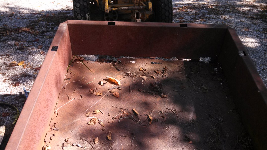

Did a quick measurement and a 4" angle would get me to solid metal on the side and floor. Think of getting a piece of 2" channel and welding that to the frame, then the put the angle on top of that.
How thick does the angle need to be? Stated another way, what should I ask for at the steel store?

That's how I would do it.;)
My steel book shows 4" x 4" structural angle come in 1/4, 5/16, 3/8, 7/16, 1/2, 5/8, 3/4-inch. I'm no engineer, but that small of trailer I would think 1/4 to 3/8-inch would be good enough.:confused3:

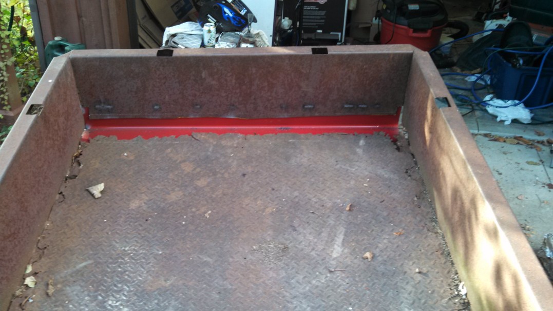

Finally got the repairs made. Just need to drop a 4x8 of 3/4" plywood and I'm ready to haul firewood! As suggested, used some 4" angle on top of the 2" channel. Used tools I had to cut away old metal. I've defined this as a UBF job - ugly, but functional, so no closeup shots of my welds.
