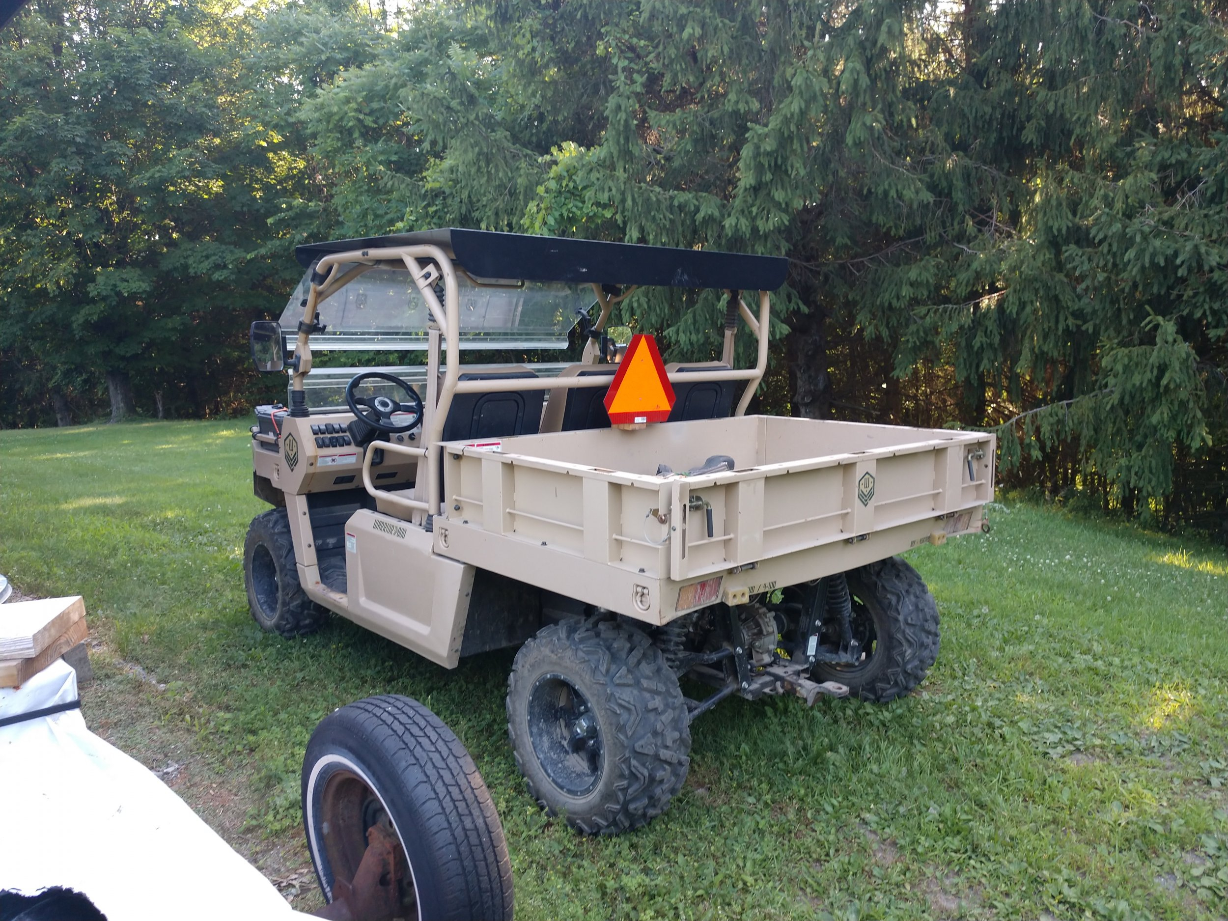

I bought an Hisun E1 electric UTV. There are other brands just as good or possibly even better. I love the electric UTV over a gas rig because you just hop in it and go, whenever. No starting issues, no warm-up, little or no maintenance, highly reliable, lots of torque, 2 or 4wd, winch, good ground clearance, adequate cargo capacity. Even my wife will drive it. (she wouldn't touch a gas powered UTV) No drawbacks really. I plug it in at night once every few days to recharge (it usually doesn't need plugged in yet). Never have ran out of battery. I use it for several things that I used to use my tractor (drag harrowing, pesticide spraying). It is the most frequently used vehicle on my place, by far, including our automobiles. If I was using it to go hunting or exploring out in the woods I would probably prefer a gas powered rig for better range and higher top speed. But around the farm, I would consider a gas powered rig to be substantially inferior. It is sort of like a golf cart on a heavy dose of steroids.:)
