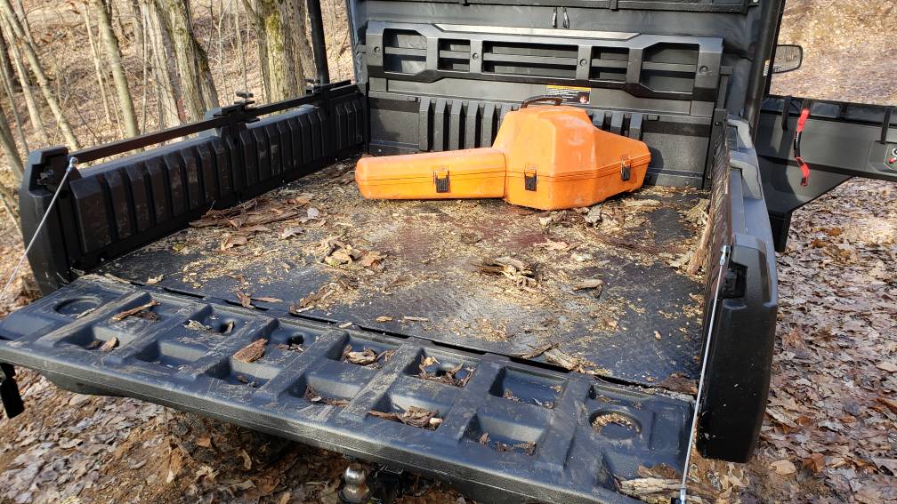

I discovered early on that the bed and engine are the real working part of the UTV. You need as large if a bed as you can reasonably get with the most reliable engine and drive system that you can reasonably get.

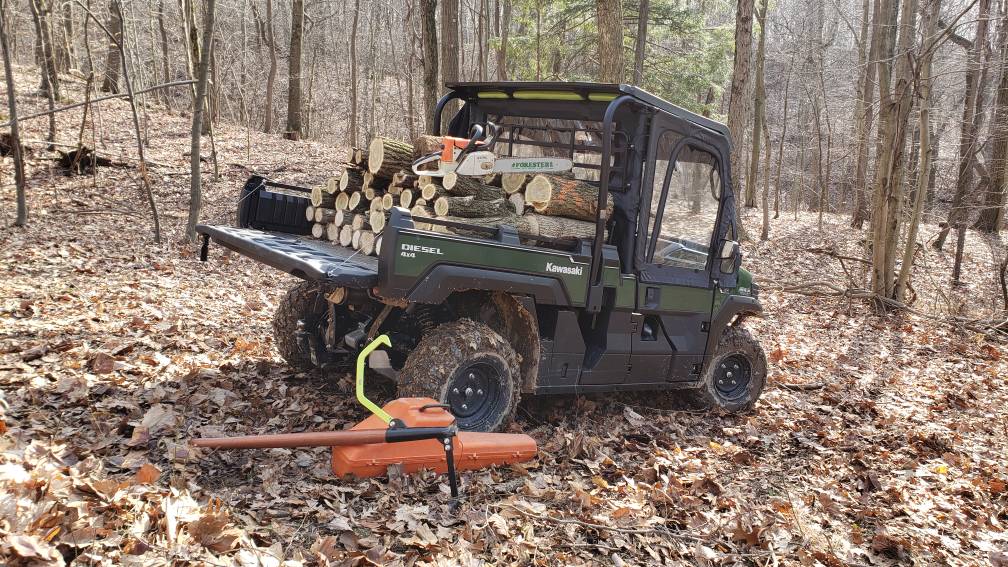

The DX/FX has a 54"x53" bed. A full sized pallet can be slid in and the tailgate shut.

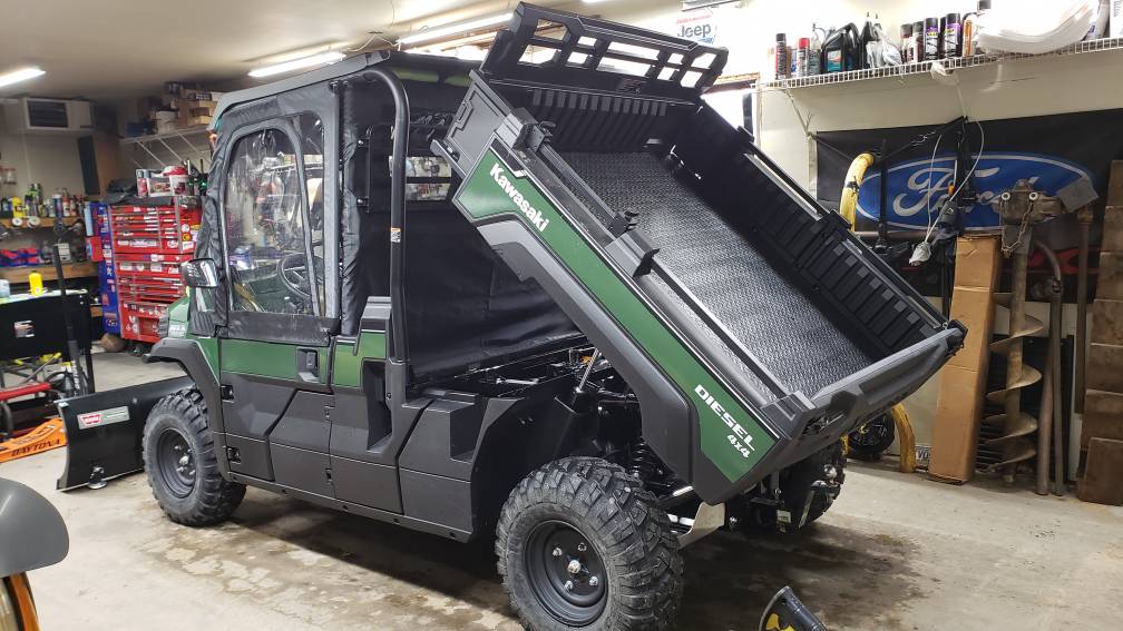

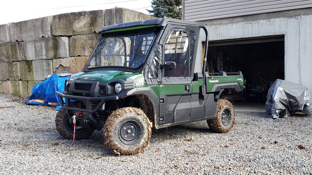

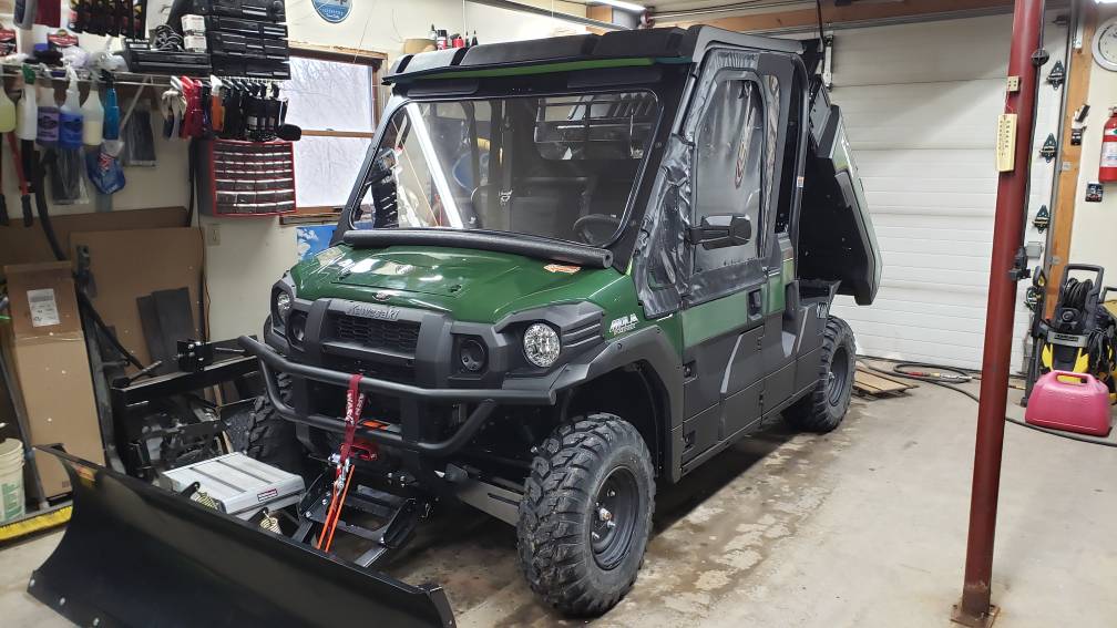

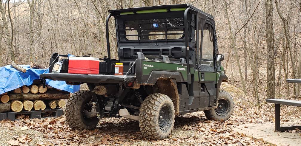

I picked the DX. I added Curtis heat, Warn 72" plow, Warn 4K winch, hydraulic bed ram, glass windshield and Siezmik enclosure, LED lights, Siezmik mirrors in both doors and a center in cab mirror, bed liner and +30% load rated coil springs front and rear.
I was at $20,700 out the door with tax, the included 3 year Kawasaki full warranty and an additional Kawasaki 3 year full coverage warranty for a total of 6 years coverage. At the end of the 6 years, Kawasaki will send a letter offering a final additional 3 year policy for 9 years of factory backed full warranty.
So my dream of buying the Kubota faded away. I grabbed the Mule Pro DX EPS. I bought the biggest bed with the best engine/driveline from one of the most reputable lines of long term commercial/agricultural UTV companies on Earth today. The Mule family is long known to be stout dependable work horses. I expect the same. 20190216_142611.jpeg20190215_145628.jpeg20190215_114518.jpeg20190214_155702.jpeg20190214_155648.jpeg20190215_153826.jpeg
So my dream of buying the Kubota faded away. I grabbed the Mule Pro DX EPS. I bought the biggest bed with the best engine/driveline from one of the most reputable lines of long term commercial/agricultural UTV companies on Earth today. The Mule family is long known to be stout dependable work horses. I expect the same.View attachment 592811View attachment 592812View attachment 592813View attachment 592814View attachment 592815View attachment 592817
