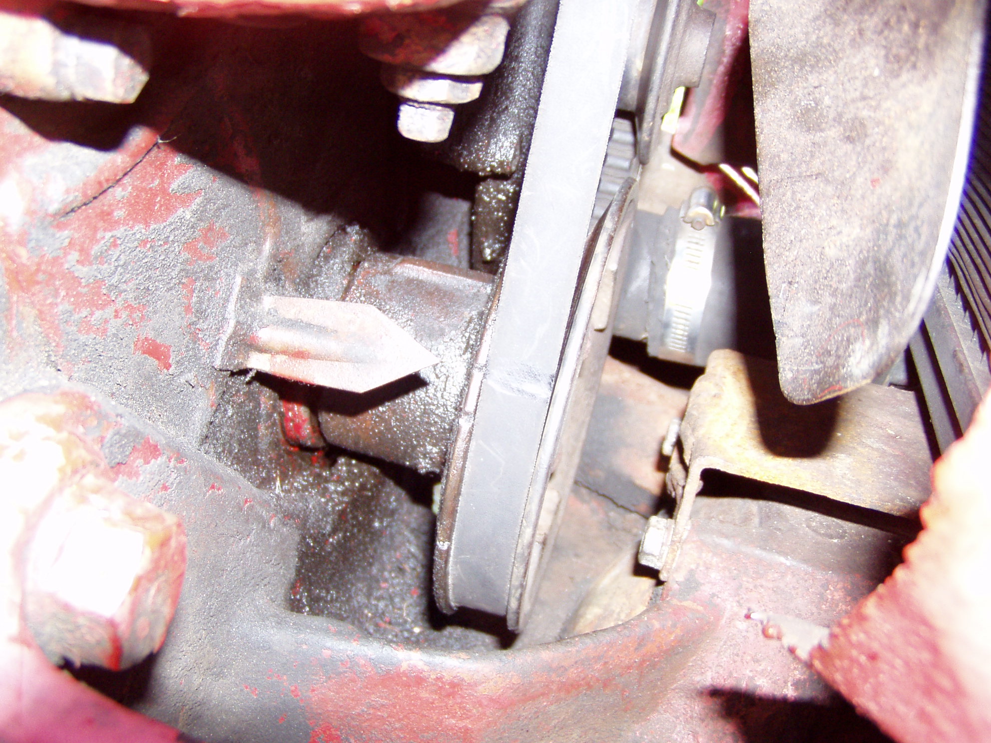

#12
thank you neat trick but somehow i managed to screw it up - I moved the number one cyl to tdc on the compression stroke. There is no mark near the pointer. so I used a drinking straw until I got top dead center ( with a work light I can see in the cylinder.) I did the neat trick with the distributor- checked compression since I had the plugs out and installed new plugs. Started the engine and it was not running right. nice and quiet but not right. seemed like The exhaust was coming out of the oil fill tube? My 84 year old neighbor came over and told me the engine was running backwards then but he knows I am part polish so I am pretty used to him pulling my leg. what did I do wrong? more importantly what should I do next? (beside sell the tractor for parts and find a simpler hobby maybe watching paint dry or something. thank you again for your help

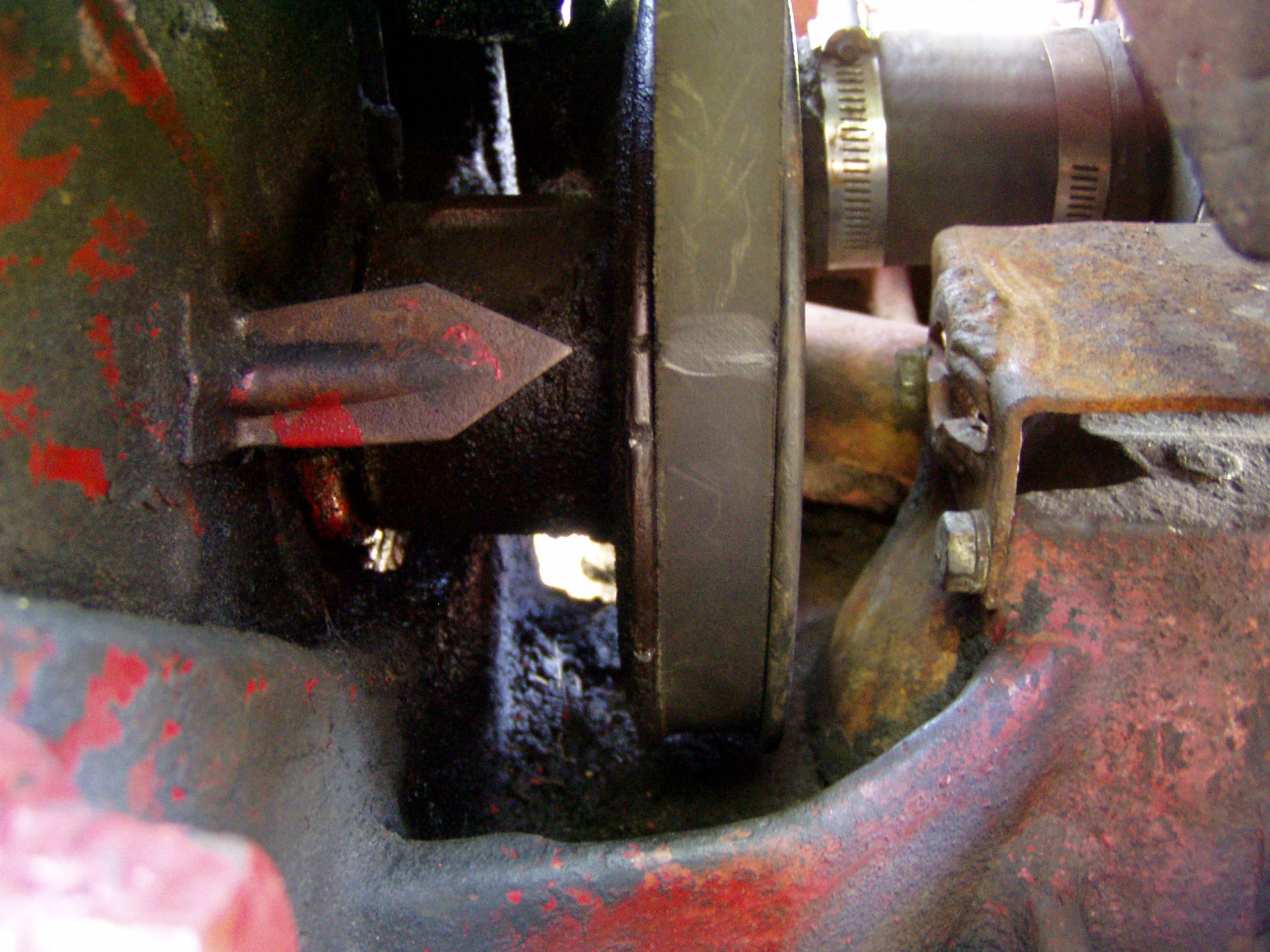

here is a pic of the pointer are the small slots in the pulley the timing marks if so which is which tractor disributor 002.JPGtractor disributor 003.JPG

#14
I think I am closer I pulled the cap with the pointer on a mark and the rotor was 180 degrees off. I put 1 at tdc and the marker lined up with the last mark. when thru the spark for postion trick and it runs. heavy smoke but it is coming from the exhaust pipe. need to find a timing light thanks again for all of your help.

   / Farmall 200 distributor question #16
I dug out a manual for the newer C-123's, and it fires at 22º BTDC. Is the mark the pointer is at, what you found to be TDC..?? According to the manual, that is 30º before TDC, the next one is 22º BTDC, and the next one down below is TDC. If in fact where you found TDC matched up with the lowest notch, I got you timing it way retarded.
Get it coming up on compression again, then stop it at the second notch, and dial in the distributor, and see what you get.
What kind of reading did you get on compression..?? Top notch is 160 psi.
Was it acting like the exhaust was puffing out the filler tube before..??

#18
the mark the pointer is at is the first of 3 the bottom mark is tdc and where the tractor is set at know
