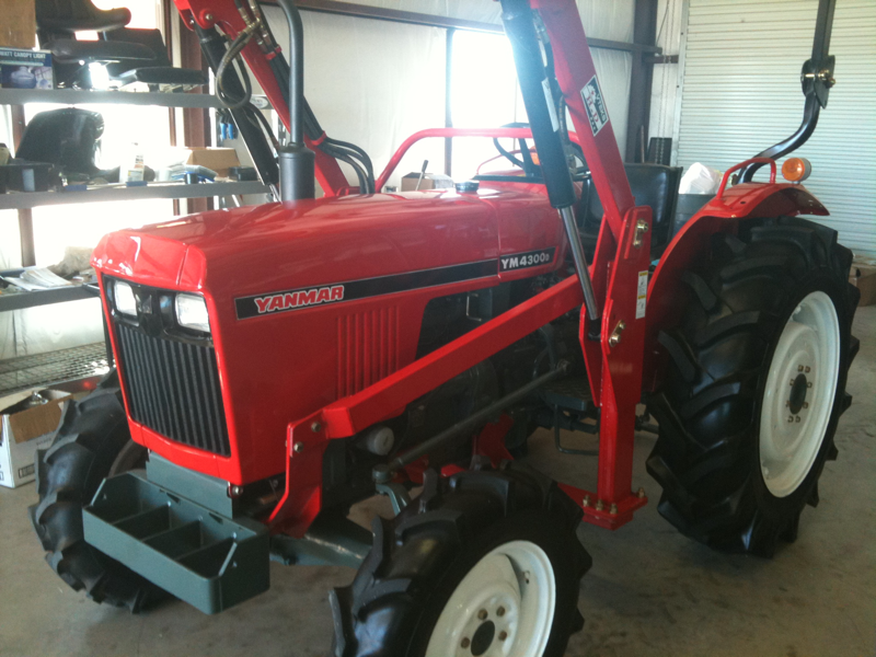

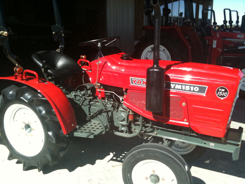

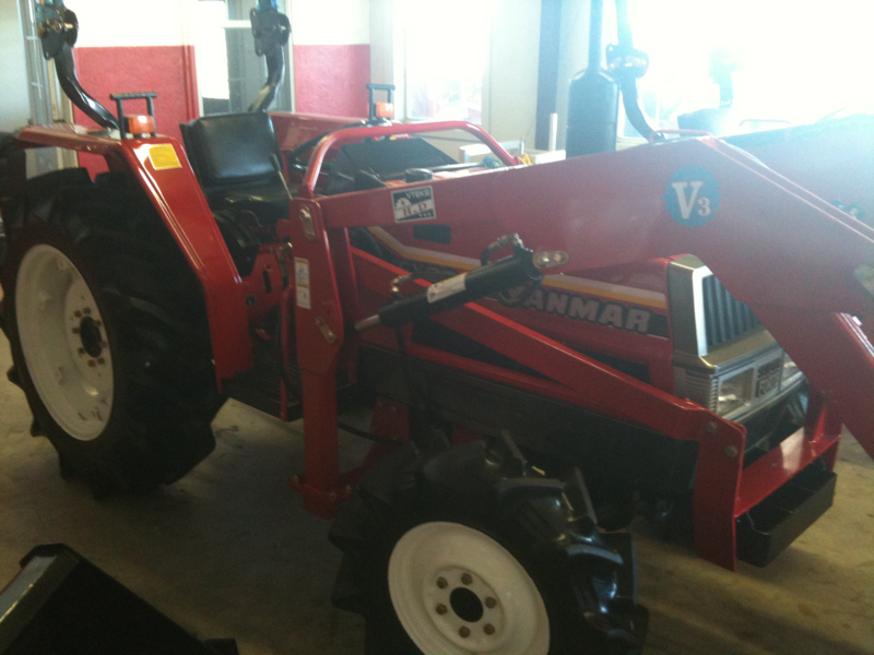

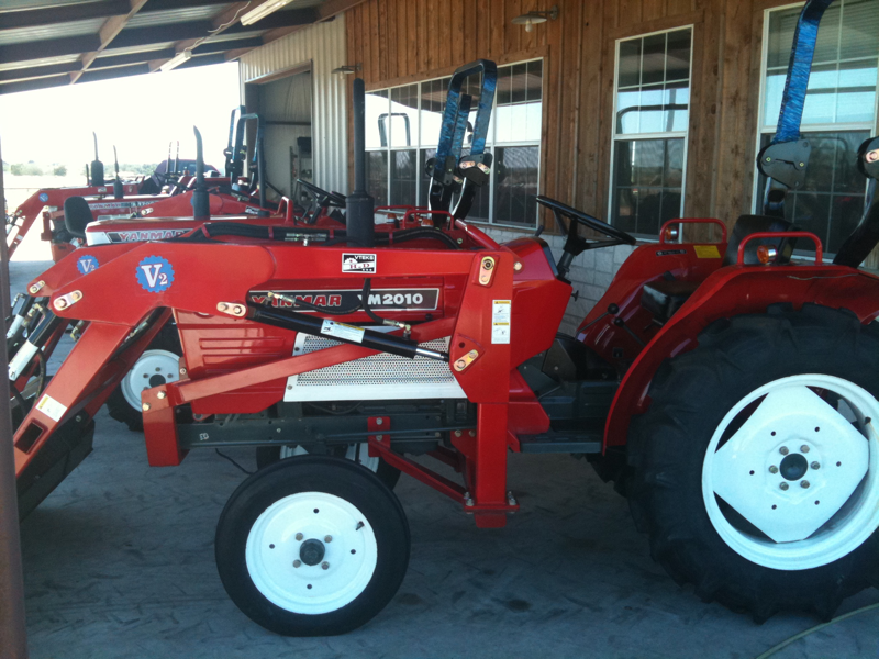

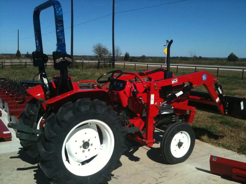

Me and Dad took a ride today and stopped in Fayette tractors in Schulenburg Tx. Really nice guys in there and boy they had some nice rigs for sale. I was snappin pics left and right. Really helped me visualize when you guys are talking about models I never seen. They had a 1700 just like mine but all purdy'd up. Made me anxious.

Those are pretty tractors, those are the dreaded vietnam recons that you hear folks talk about. The v2 loaders give them away. That said there are some of us once the initial bugs are sorted out of some of them they seem to be fine.

But when you find a whole dealer lot of tractors with museum-quality paint, then obviously they aren't original.

Good info there thanks. I knew they weren't original but I thought for some reason that they were gussied up here in the states and was wondering what it would cost to have them paint mine when the owner told me thats how they come in from VN. They told me that the quality they are getting in has been great and that business has been good. My 1700 has had problems but I am working through them one at a time, ok maybe 3 at a time, but I know it has been in the states for over 10 years and I can't tell if the problems are from US abuse or VN crappy refurbish.

Mmmm might be Vn recon's but i sure wouldnt mind that 4300D anyways:drool:

A huge dead giveaway of the vn tractors is the V2 loaders or a Bulldog loader, no american company uses those as they are strictly an asian market item. NOt really a problem with them, they work and if i find a deal i would buy one for my tractor, but i dont think they may be as stout as a koyker but i have not heard of any bending but the main problem is there is zero parts support for them, so you have to go to the hydraulic place and get custom hoses and of course they can rebuild the cylinder on anything so that is not a problem. But any big items if ever needed will have to be fabbed. But my guess is that california will have a hard time finding parts for his 35yr old loader that is no longer made. He has had to pack cyls before and buy new hoses, but these are generic items.
