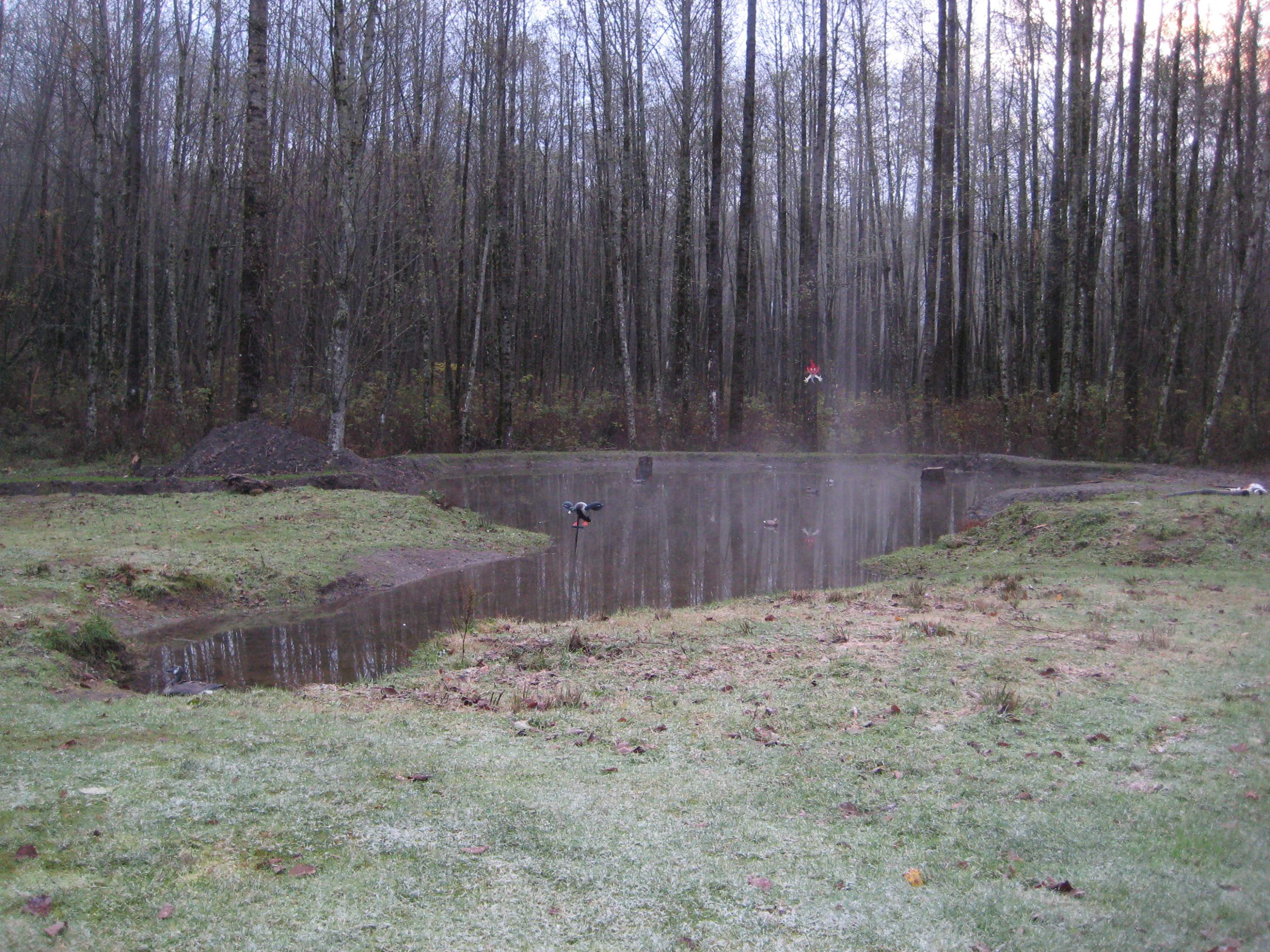

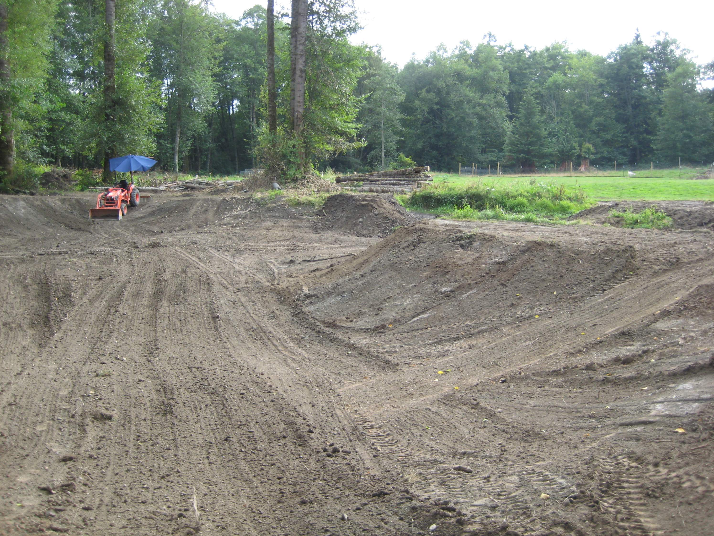

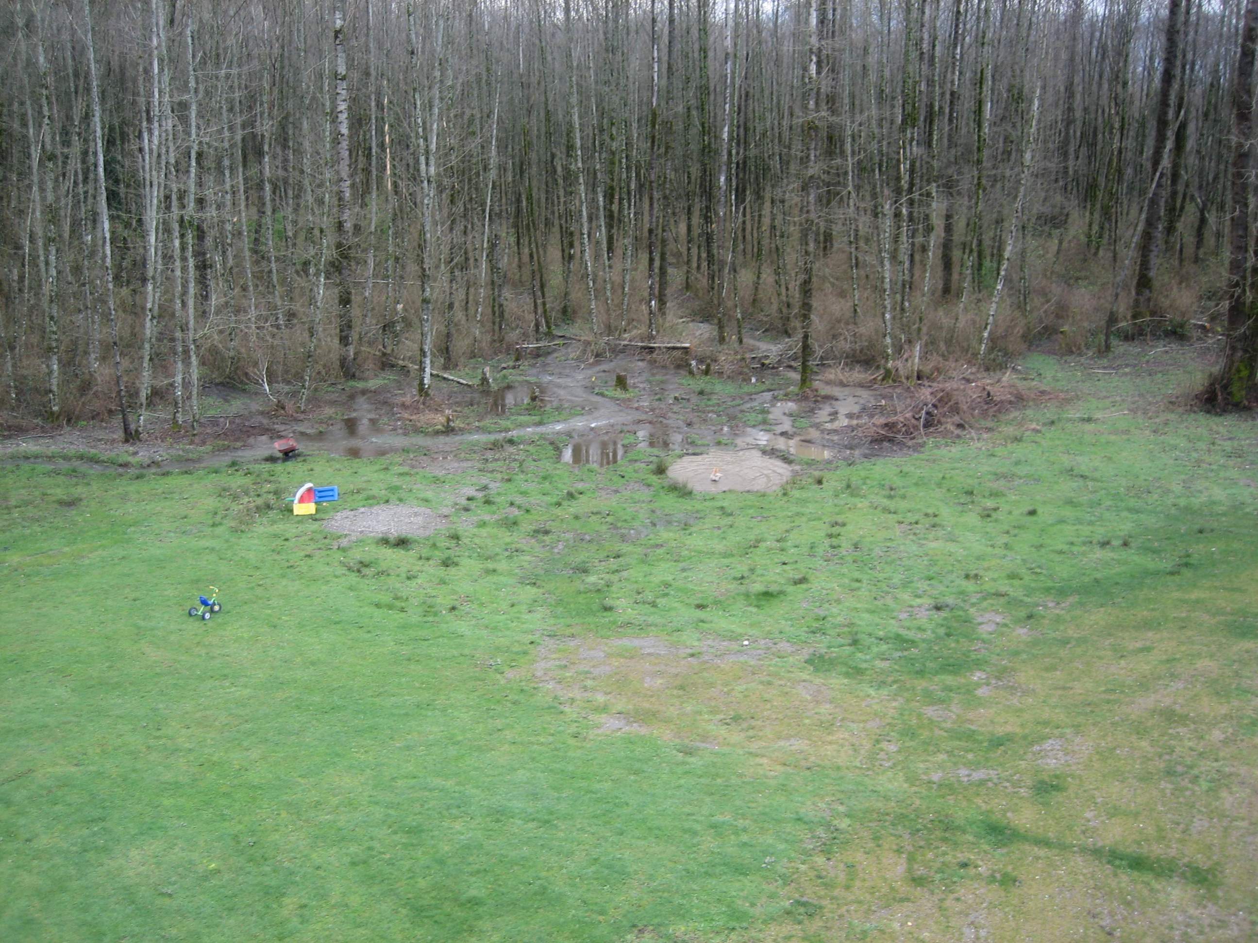

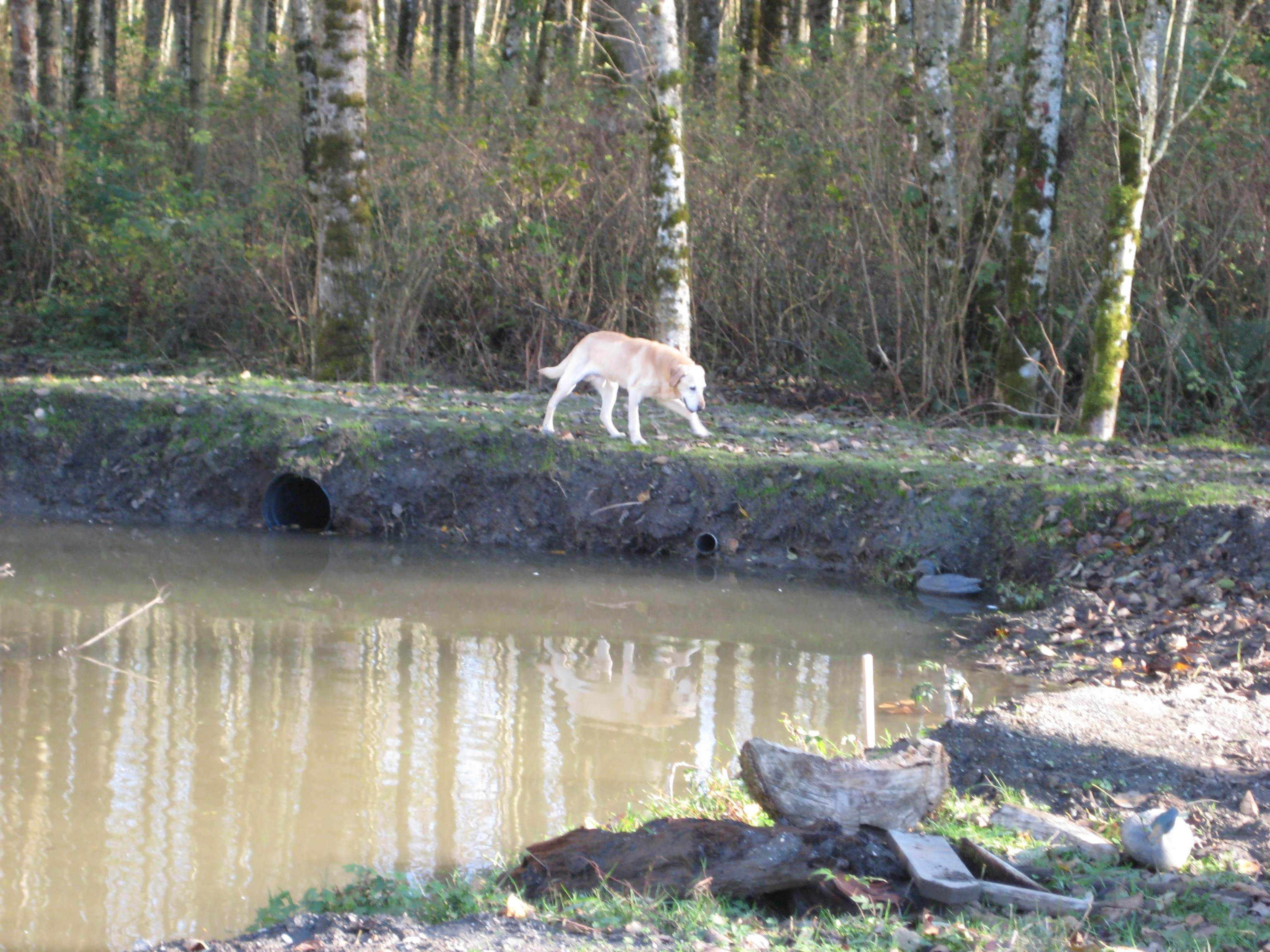

My dog started my pond in 07 if you look at the circle of water you will see my lab in there, he used to play in this mud hole for hours, which inspired me to start digging. I mainly used my FEL with a little down pressure. This was all before TBN so I did not know about toothbars and other digging means, other than my FEL, BB and backhoe, but again I mainly used the two former.
My pond goes dry 3 to 4 months a year which is when I worked on it. Each summer I would spend a week or two expanding it ever outward. planning on how I wanted to expand it, and experimenting with how I wanted it to drain. It wasn't till a friend turned me on to this site and I discovered I was doing it all wrong:laughing: I read Eddie Walkers thread which is very informative, and has some links to pond sites.
The second picture is my pond starter walking the dike of his pond, the third is the pond at the biggest it reached with just the use of my B2710. Last summer I cheated and got a Hitachi 135 and made another expansion. though I used the tractor to remove a lot of dirt instead of useing hours on the ex as I was paying for those. The last pic is useing the tractor and BB to smooth it out.
Yes it can be done useing a compact tractor, though it will take some time, I have one more expansion to do and will try and do it this summer or next. The one thing I would do differently is go big right from the get go and use lots of dirt to shore up the rims. Also when it was smaller I just used 4 inch tubes, to drain. Don't do this, make sure you have enough pipe to carry a lot of water away. I also have a spill way now as well. You may have issues if your pond or hole fills with water before you finish. If you can keep the water out before then you will have a good shot at it. I still don't have a toothbar and just dig with my FEL.
Good luck and enjoy your pond
