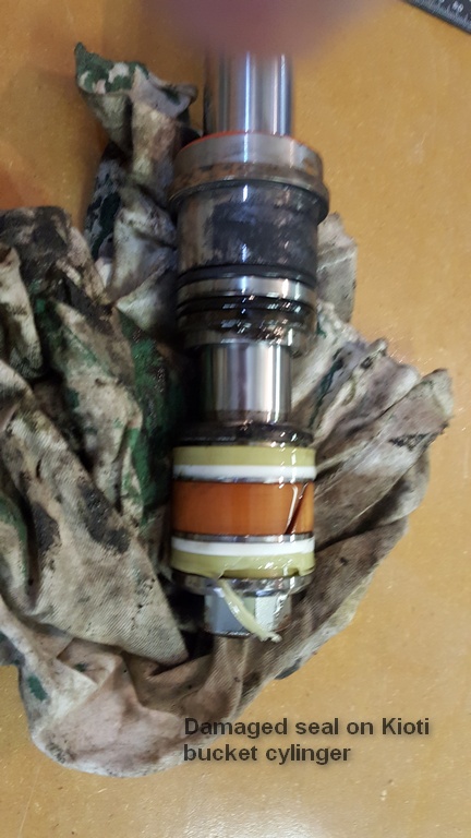

My bucket was doing the same thing I cured the bucket and held it on relief for a min. then felt the top end of the cylinder and took apart the one that was warmest.This is what I found.
Loader only has 1 year warranty but the dealer gave me a new piston end. I suspect this was damaged from new. The bucket is starting to do the same thing on occasion but so far holding the cure on relief isn't heating 1 cylinder more than the other.
