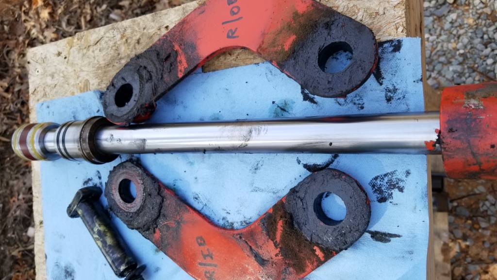

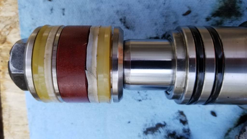

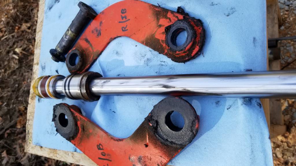

Well...put new seal kits on today. Started the tractor and immediately it went to the dump mode !!! I didn't have the bucket hooked up. So I pulled the piston rods out to check if maybe I tore a seal when putting it in. All seals good. Scratching my head now...ugh ! Not sure what the problem is....maybe somehow there is some seals missing I didn't account for ? So will look at the parts diagram and make sure I can account for all the seals.Is there a certain madness in the sequence of how you put the piston in ? Like...do you have the piston all the way out or in when you put pressure on ? Any help would be appreciated....will start over in the morning !!

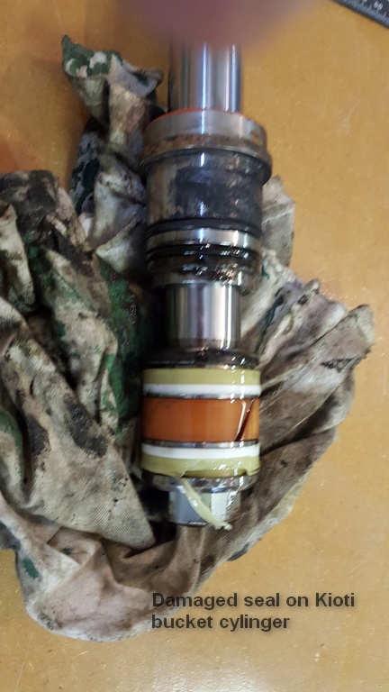

1. No a cylinder cannot retract with faulty seals.
2. Retracting causing "drift" is usually associated with the main loader lift.
3. YES a cylinder can extend if seals are faulty.
4. Extending "drift" is usually associated with bucket cylinders or backhoe booms.
And a faulty valve leaking by internally can cause drift of any kind.

LD1...you are the winner ! Put it all back together today. With pressure on the 'dump' coupler it immediately went to the dump mode. Bled pressure off and disconnected the 'dump' QD. Started tractor and with no pressure on the 'dump' coupler the bucket did not move !!!
